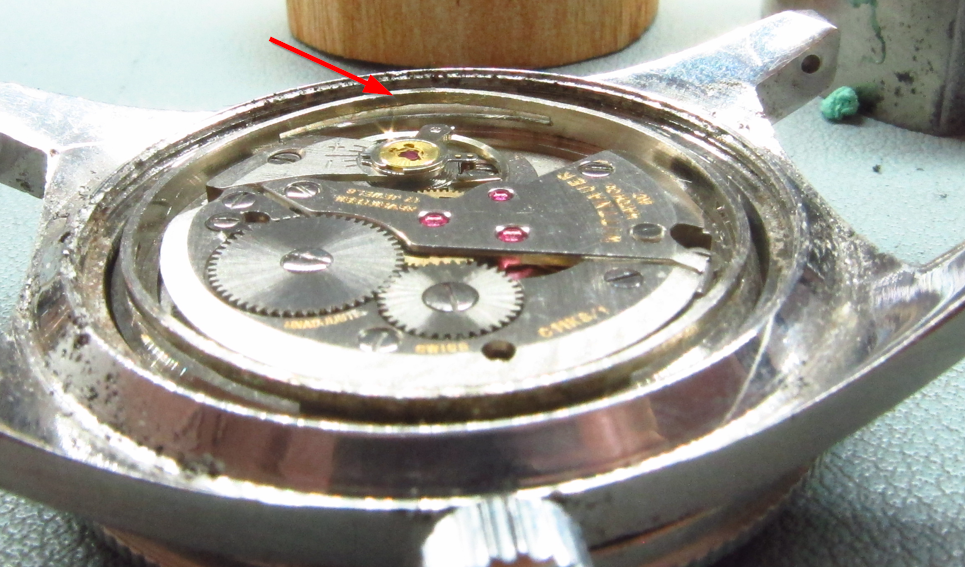

I have a crusty Wittnauer skin diver I would like to begin servicing. After removing the case back, crown stem, and two movement securing screws I found that the movement still wouldn't come out of the case. Now I am beginning to wonder if the movement comes out of the front, however, I would like to confirm this before getting a crystal lift. I have seen this exact Wittnauer on this forum before so I was hoping somebody who is knowledgeable could advise.

If the surrounding ring to which the case screws were tightened is part of the case you’ll have a frontloader. If this ring is loose in the case  its a movement holding ring and the movement gets out through the back.

Thanks, Kalanag. The movement ring does seem to be part of the case (or at least very firmly attached). I'll go ahead and remove the crystal and see if I have any luck.
I have two of these.  The movement comes out the back.
The ring installs on the movement interfacing to the back of the dial and the, otherwise, case screws fasten this ring to the movement and dial to make a complete unit.  This drops in the case and is held firm with the back.
I suggest that you remove the balance to protect it and then proceed with removing the movement.  Most likely, there is some rust that is holding it in.

Here are more pictures.  I added pictures of the proper crystal for this watch.  I show two extra wide tension ring sizes because I cannot remember which one was the ultimate fit for this watch.
I show a side view illustrating how the movement ring is raised.  When the back is screwed down, it presses against the ring, holding the movement.
