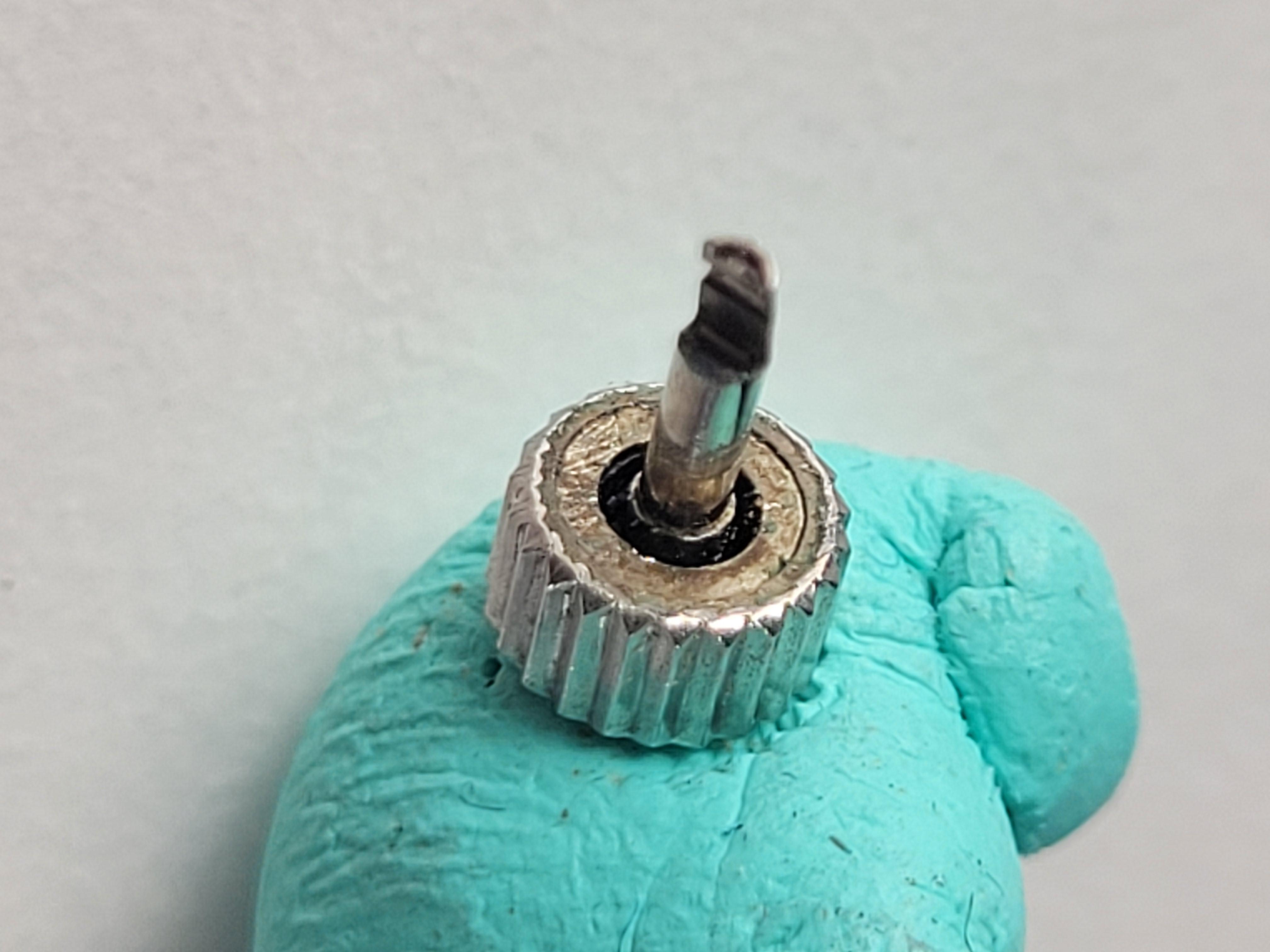

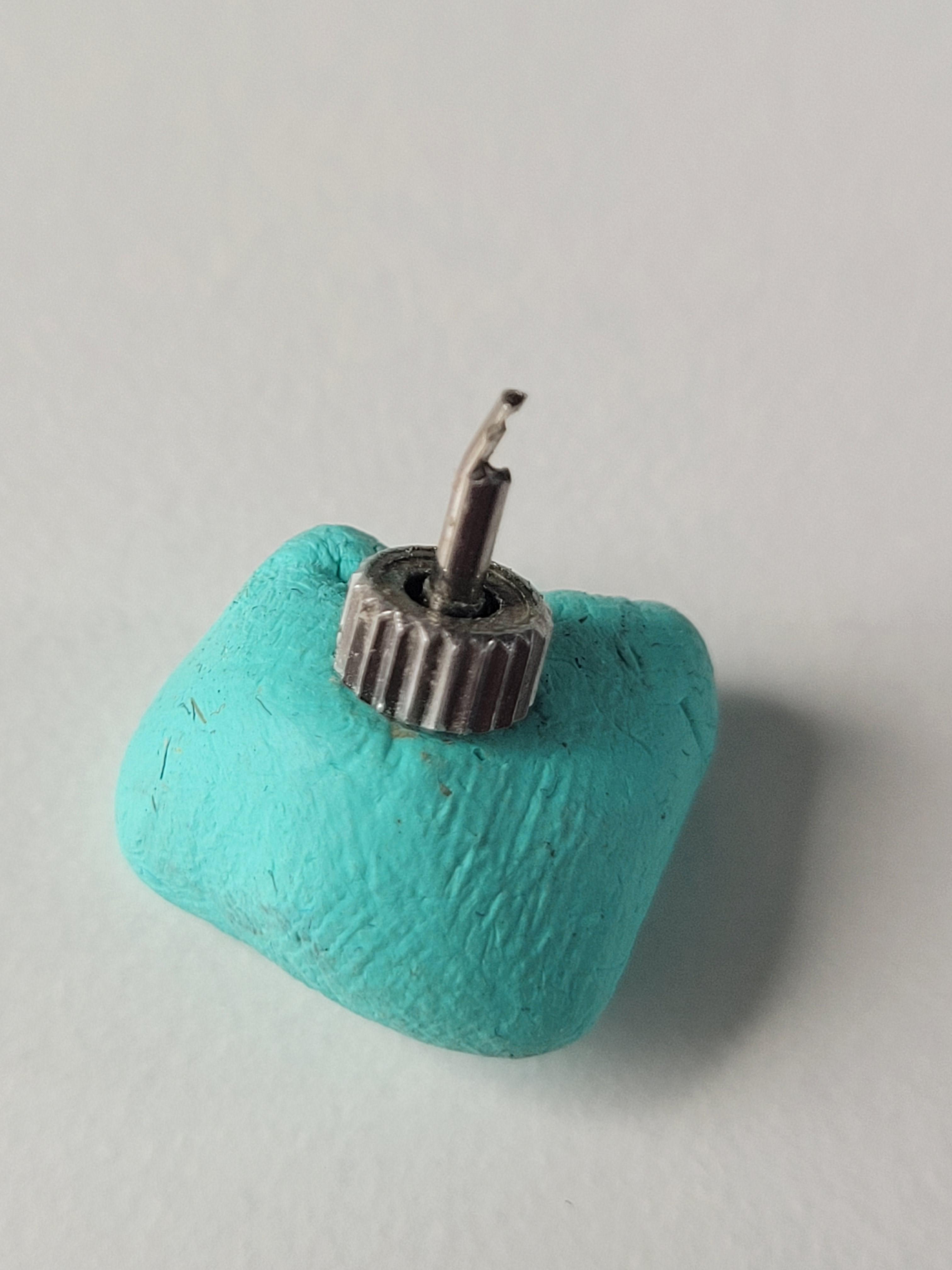

I don't know that yet 🙂 The part that is visible is NOT threaded and much thicker, that's why I'm confused... I'm gonna try unscrewing it and will report back. Thanks for the help so far!

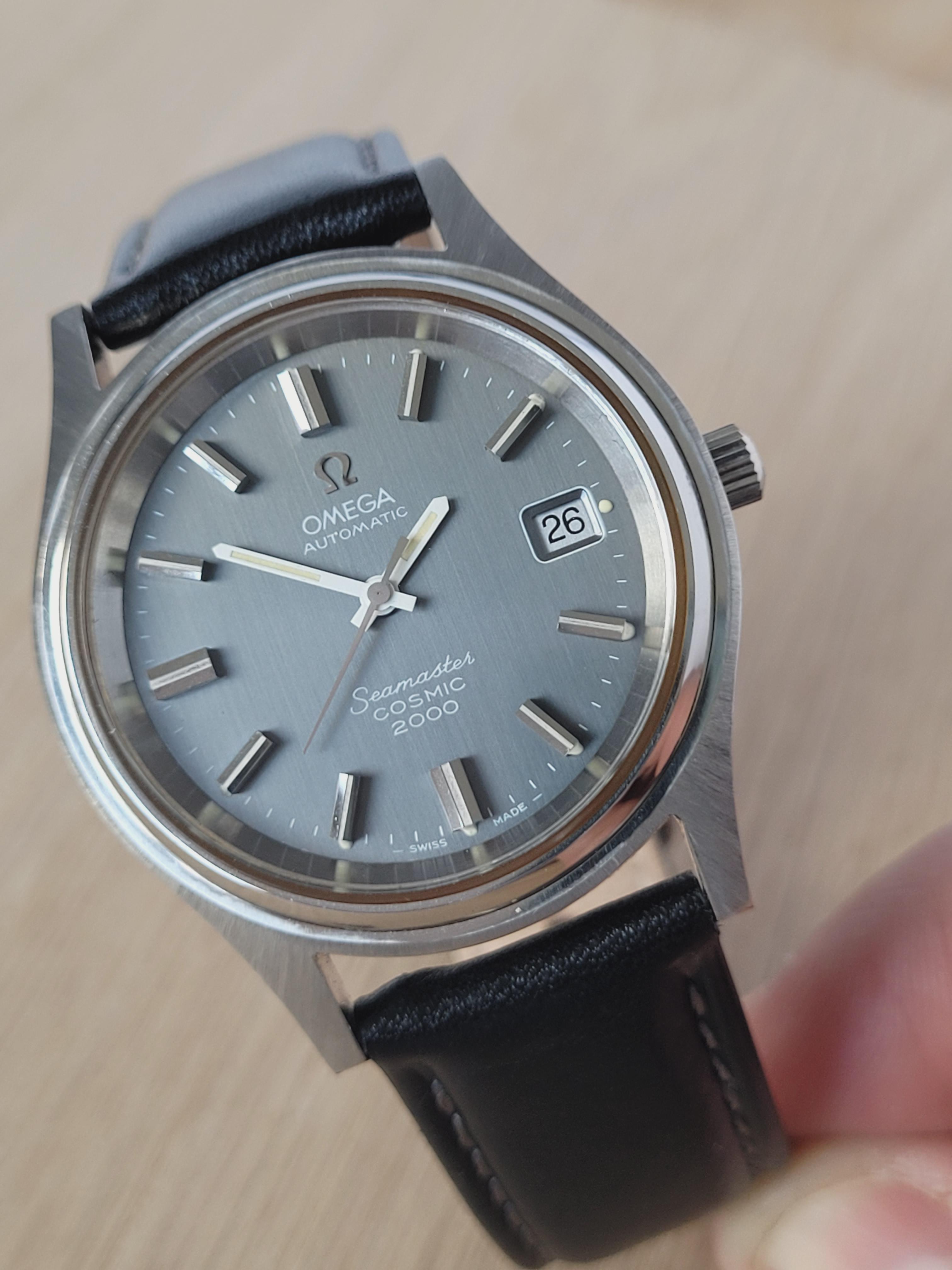

The watch is a Tissot Stylist ref. 41429. I have managed to install the crystal now, I had to remove quite a bit of material from the edge until I could bend it into the case. Not ideal but atleast it's in. And it doesn't feel loose in the case which is what I was worried about.
