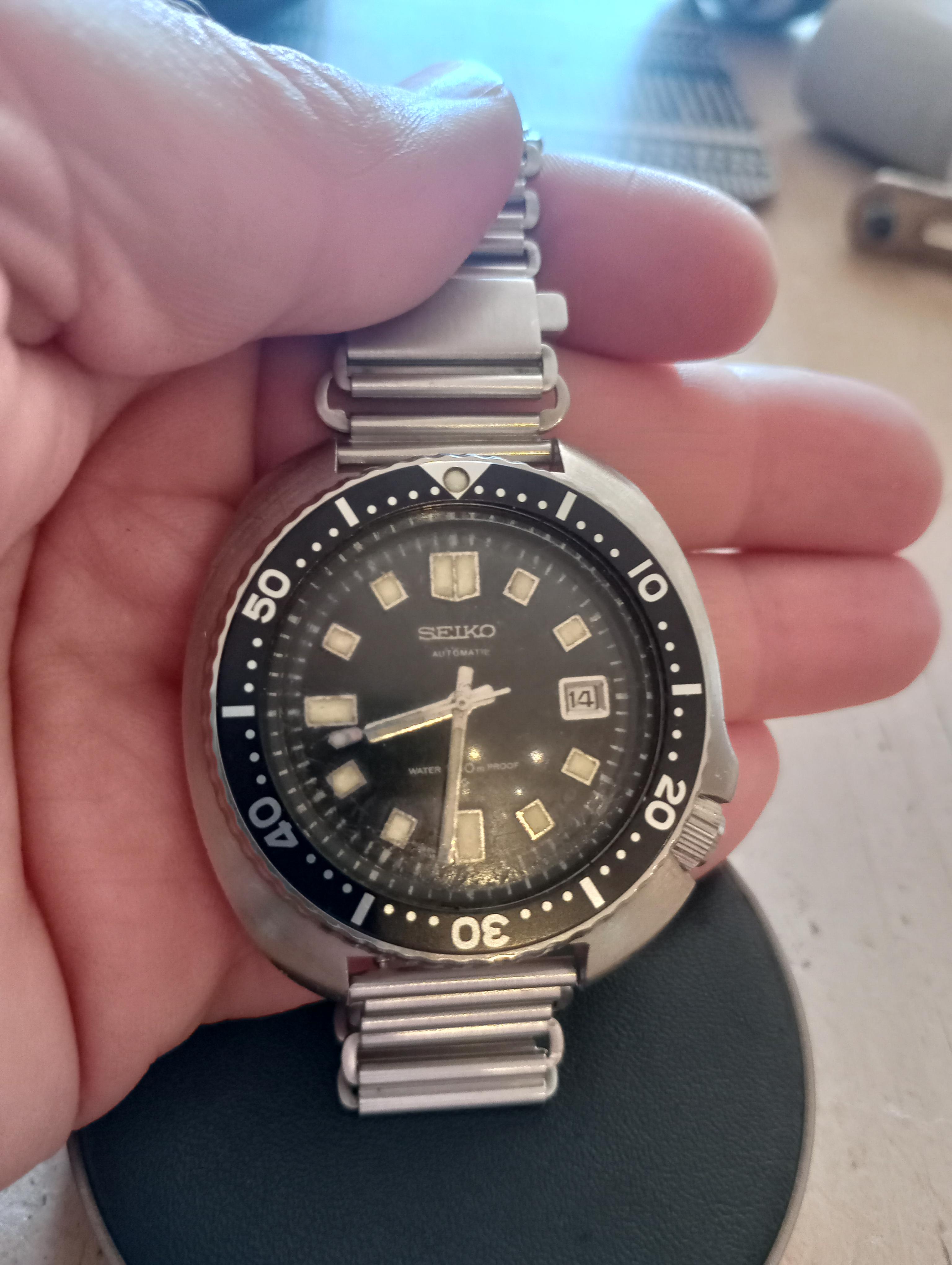

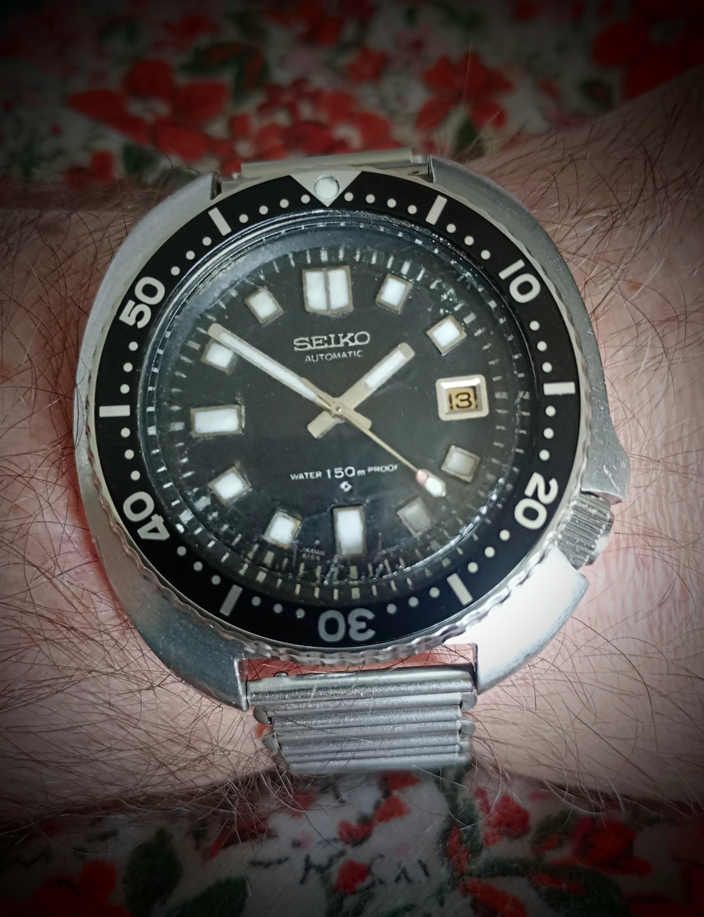

So I recently picked up a slim 6105 which had a badly damaged dial (posted in another thread). I couldn't really live with that given I had another dial handy, also in not great condition but with added bonus of having a better lume job and actually being fully attached to the dial plate!
So what to do with that damaged dial - I tend to think they should be in watches. Well...

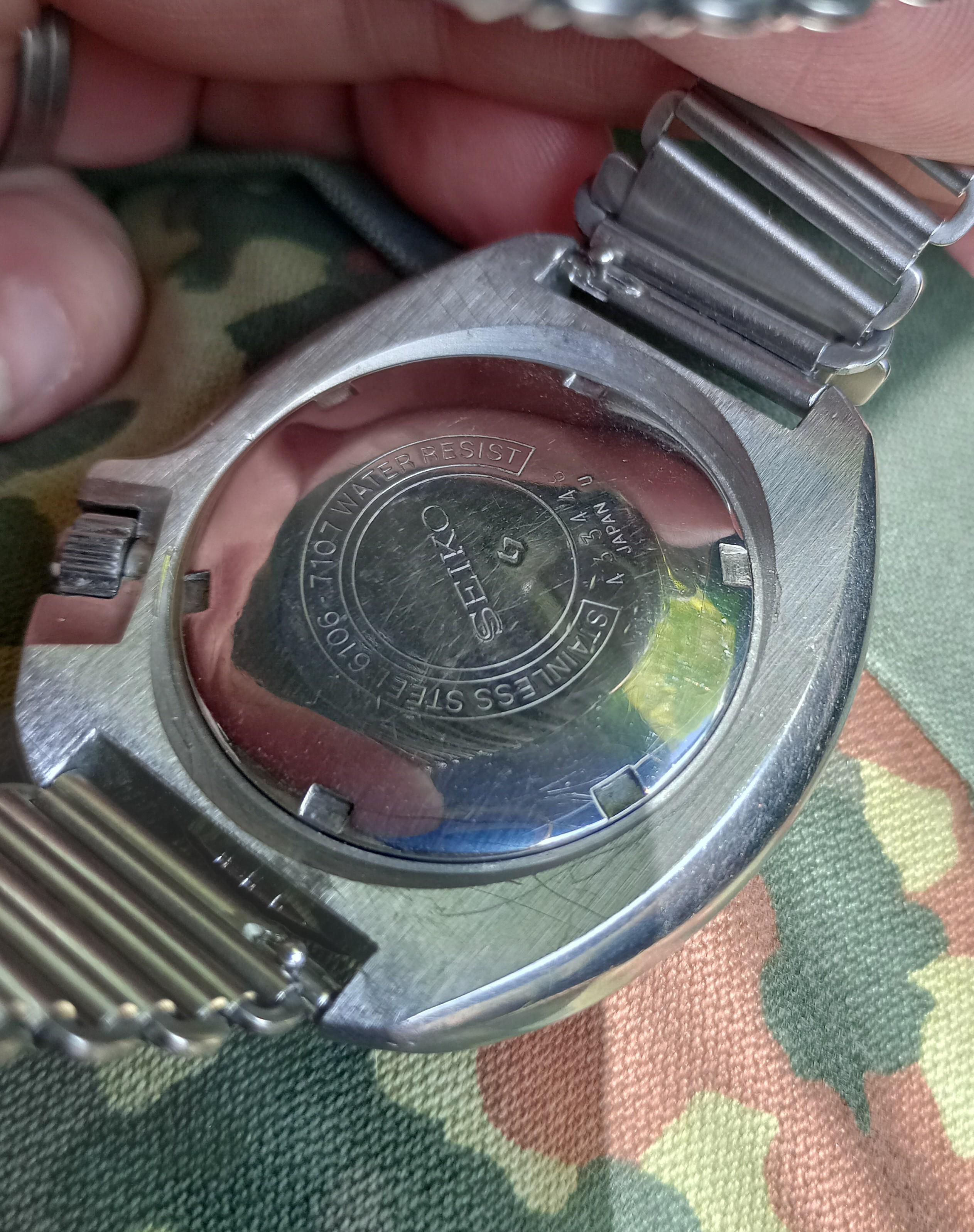

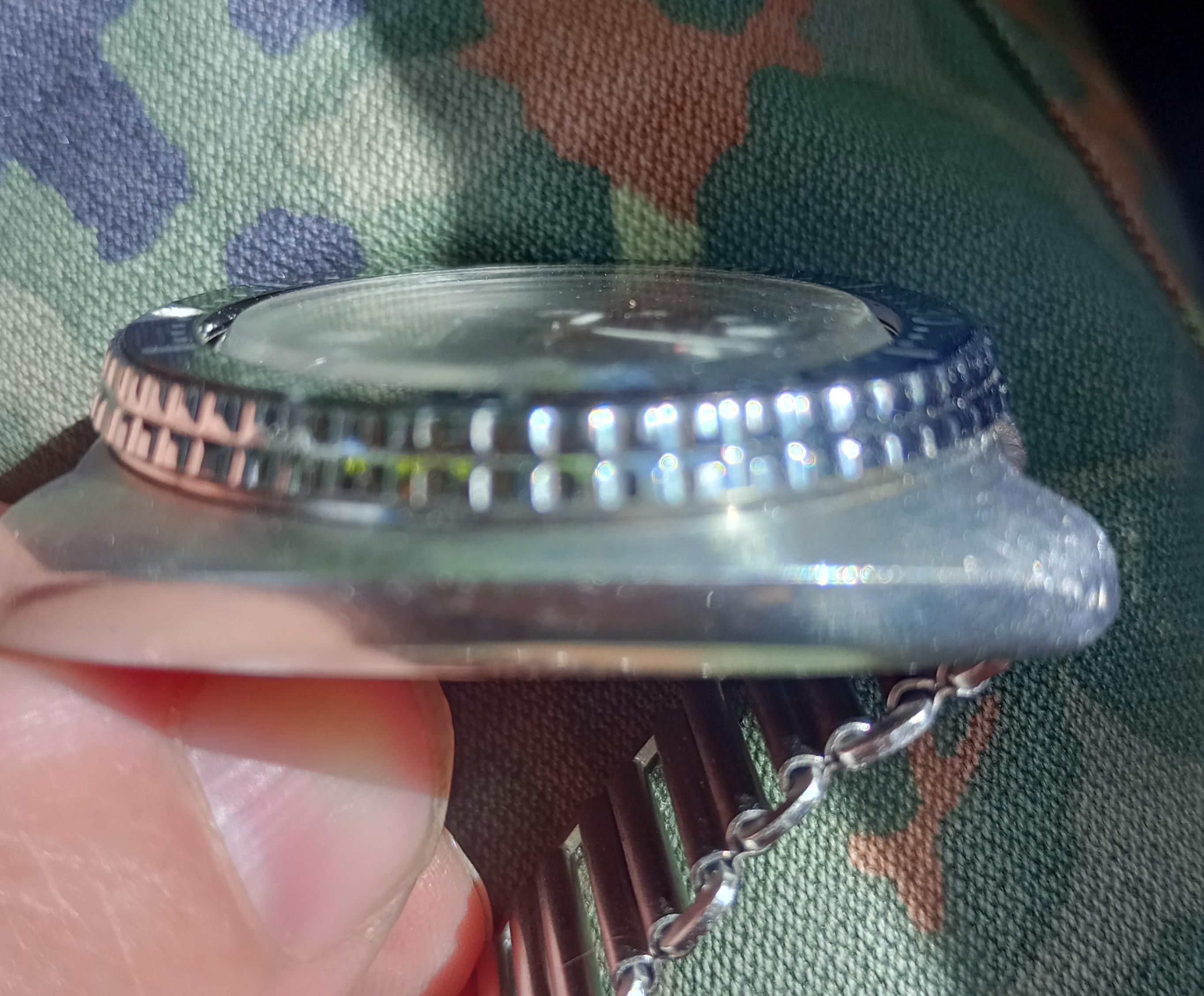

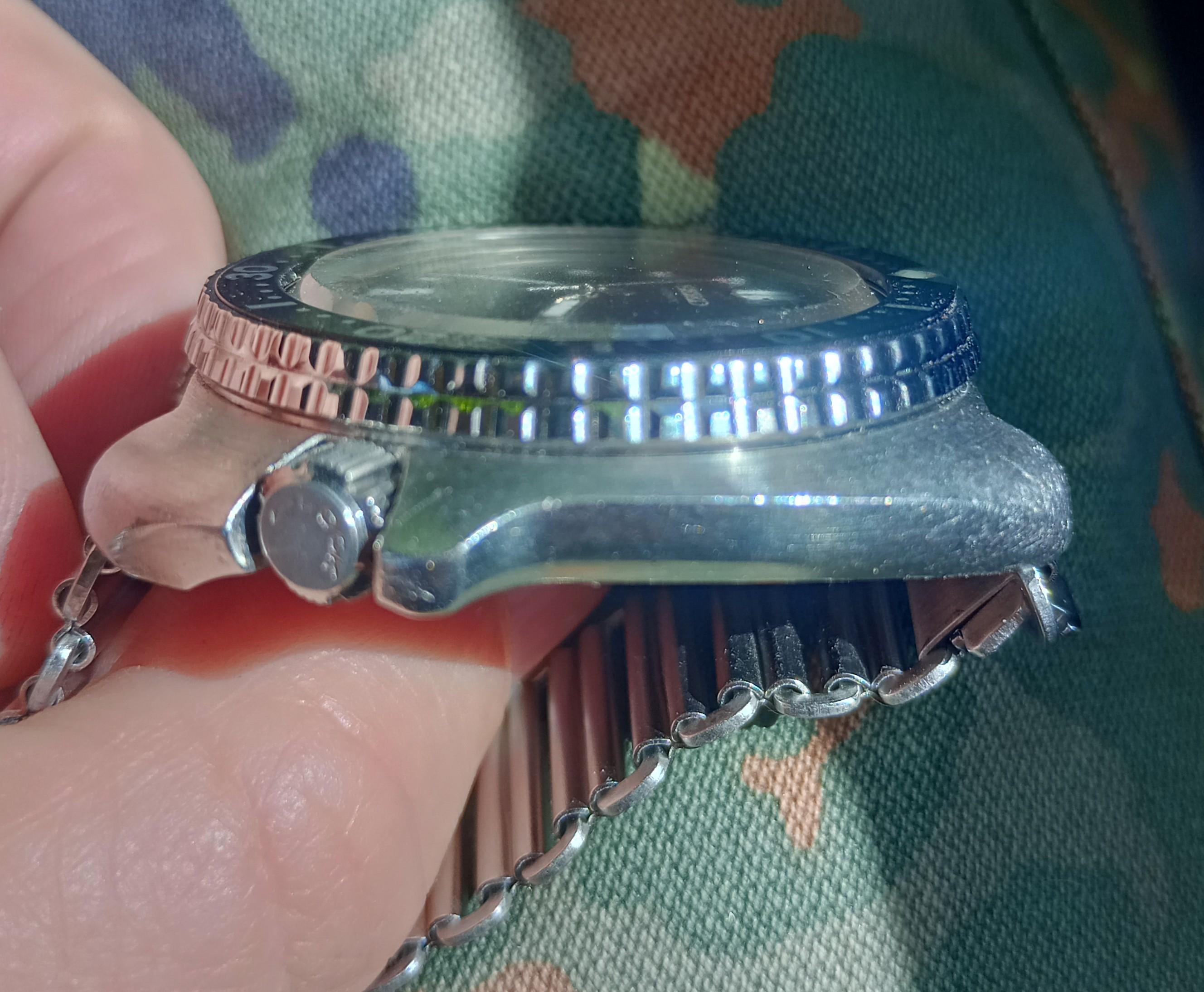

A 6105 mid case and crystal assembly punt arrived from Italy yesterday, which I've frankened back into a working piece with the dial...
Damaged dial now sits behind damaged crystal in an original case, currently powered by 6106 (with a 6106 caseback on to reflect this...
I've cleaned up the original crystal up to a point, but kept it fairly beaten to distract me from the dial, my markers and it's not very satisfying lume job - it's not awful but it's glossy which I don't like.
Also has a 6139 bezel on it for now because that's all I could find - I couldn't live with it naked and don't mind it tbh, though will keep an eye out as ever.
So yes, here you go - another 6105 (almost!) back to life. I'll also keep my eye out for the correct movement and perhaps a better dial in time. Caseback might prove tricky/expensive.
I know Frankens aren't to everyone's taste but I do enjoy getting these back into working form. Better a working/worn watch than a sat in parts draws imo.
And the good news here is that, thanks to the repro service crown, this is the only one I have I could actually feel safe to swim in!
