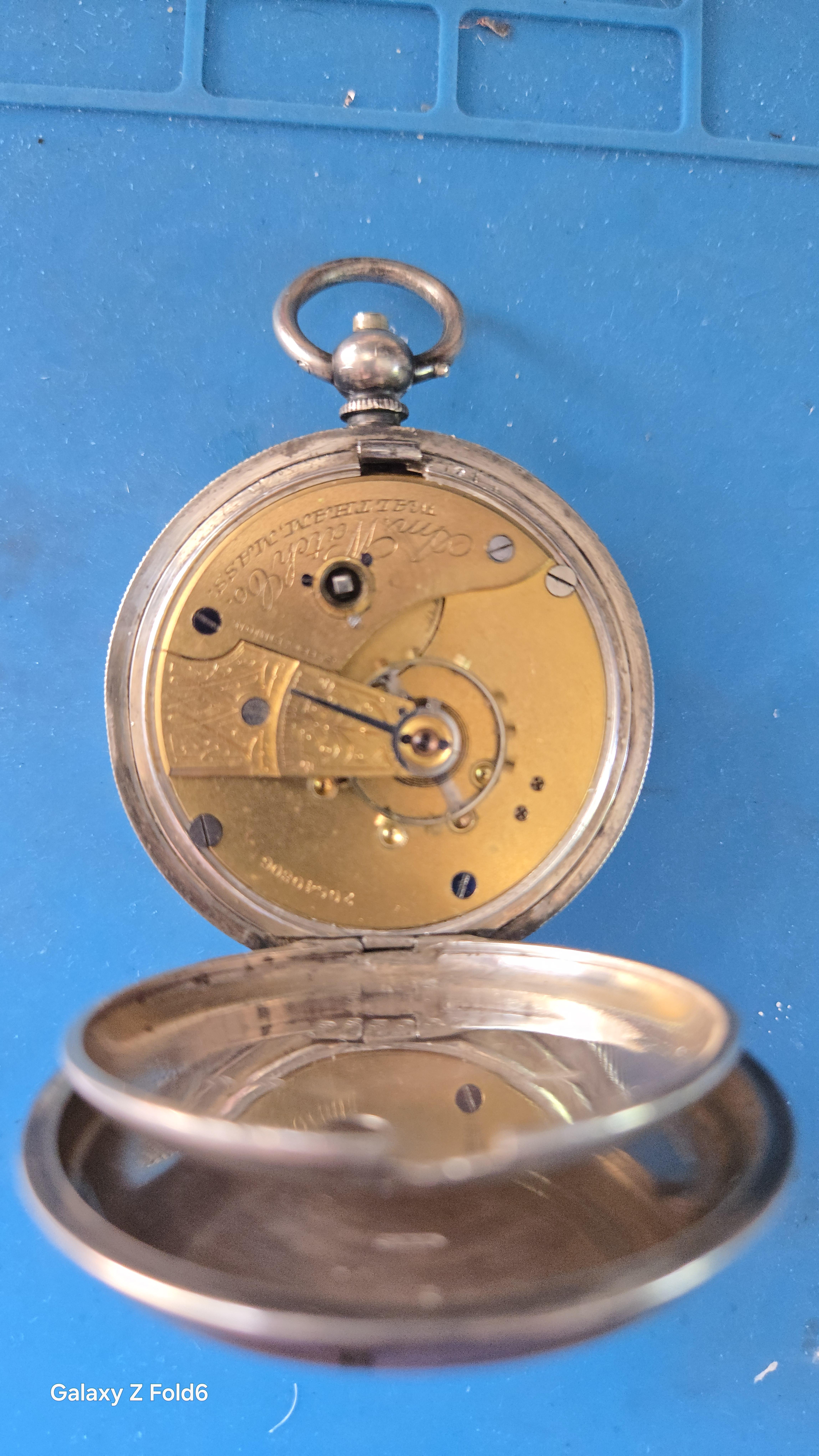

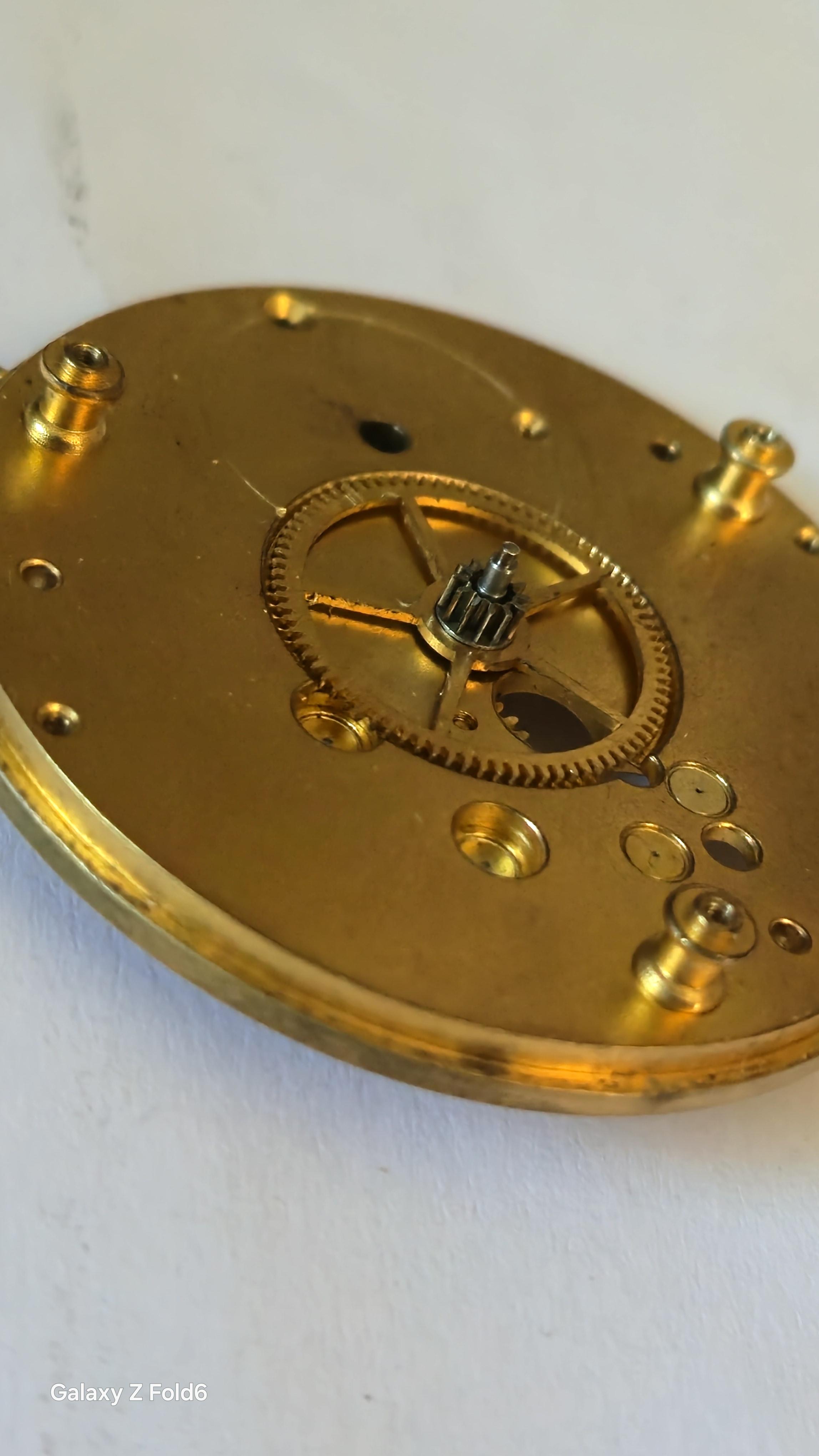

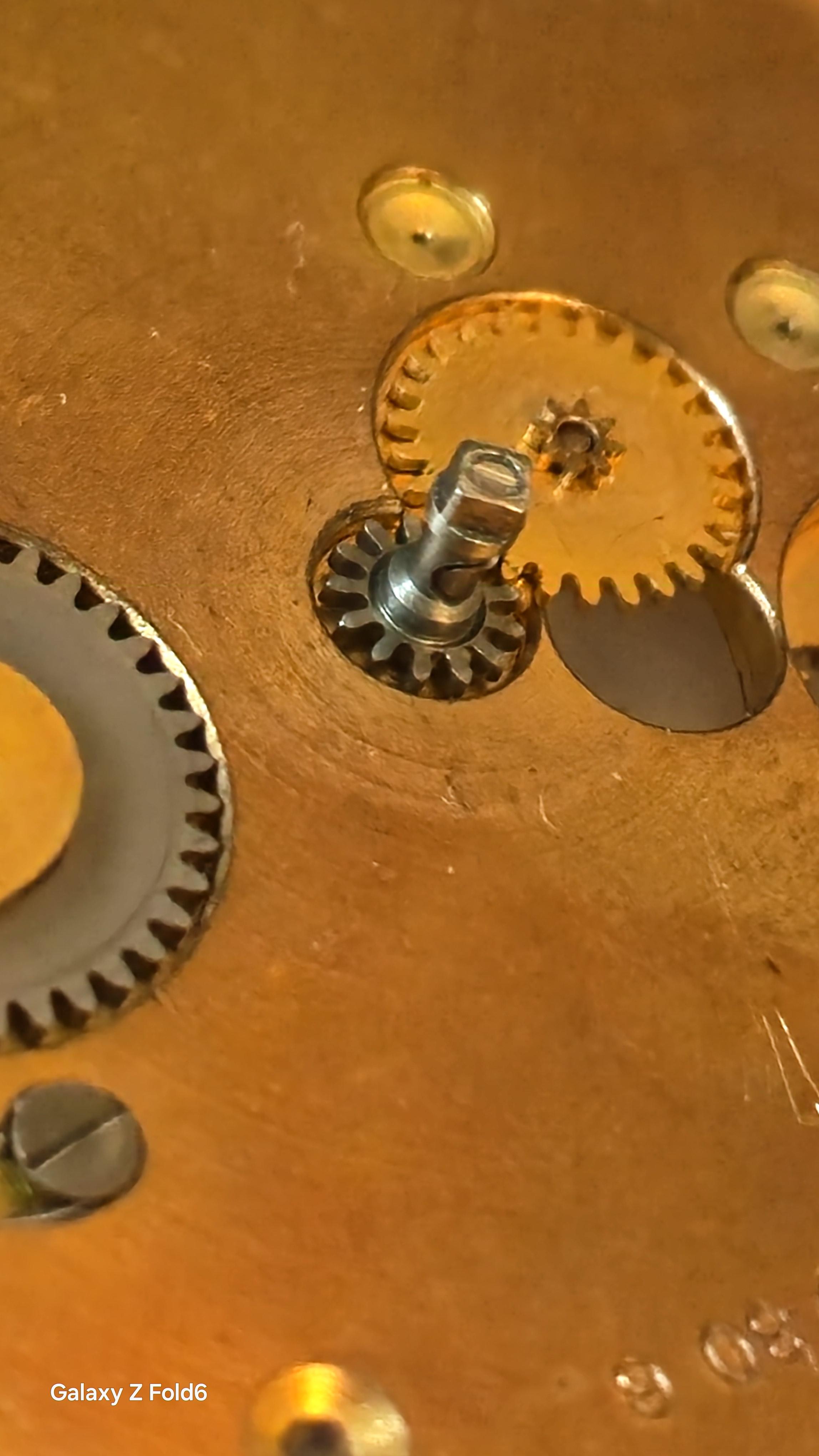

I have a Waltham key-wound pocket watch, small seconds: 20640806 on base plate & 640 80 6 on top plate. The pinion shown in the photo of the rear of the top plate - driven by the barrel - is loose & doesn't turn the main (first ?) wheel on the same arbour. The other photo shows the arbour on the dial side which appears to have a clip of some sort around it. I'd be grateful for advice as to how to proceed to rectify this problem.
Remove the cannon pinion from the dial side first. The "clip" you describe is sort of a metal tab some American companies designed their cannon pinions with in order to make it easier to tighten friction. If that is the problem, the solution is as simple as gently squeezing the tab with tweezers to bend it ever so slightly inward, while supporting the inside of the cannon pinion if possible (it may be harder to support inside since it does not have an open tip as a hollow tube)
The cannon pinion should just pull straight off of the arbor on the dial side if you pull it straight up with tweezers. There's no jewel in danger of breaking and the arbor is thick so there isn't much risk of breaking the arbor.
But when you are describing that the center wheel's pinion is not turning the arbor, is the pinion firmly attached to the center wheel? If you remove the center wheel and hold onto the rim of the wheel, does the pinion turn independently of the rest of the wheel? It should not.
I'm not sure if this was the case on older Waltham, but the pinion may be threaded onto the center wheel arbor and they are often loose. This was a safety mechanism for a broken mainspring and may just need to be tightened back down. I can't remember for sure, but these might be a reverse (left) thread instead of normal right.
And does the entire arbor turn independently of the wheel? Also should not.

Thanks for the prompt response. I apologise for not stating the issue more clearly. The problem is that - what I now know I should have called - the centre wheel is not being turned by the pinion (which is driven by the barrel) with which it shares the arbour (1st photo above). The pinion & arbour are indeed reverse threaded but the arbour (the 'screw') is clearly damaged ('rounded' rather than 'sharp' threads) with swarf evident. When the pinion is screwed on there is only enough connection to prevent the pinion being lifted off but not enough to stop it turning on the arbour. Is a (reversible) repair (threadlocker?) possible in the short term while a replacement centre wheel assembly is sought so that the viability otherwise of the watch can be established?
