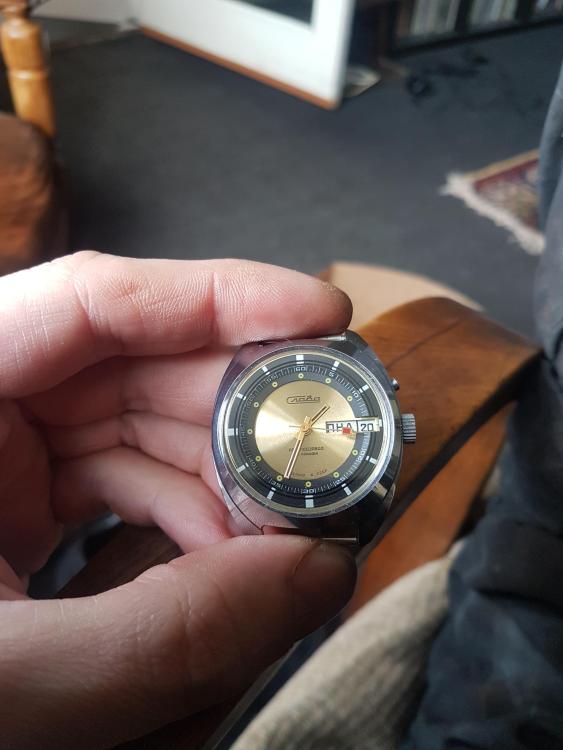

The slava I bought as an unknown but running watch. It gains about 1 min a day but. The winder never feels any different, just keeps winding. It does wind the watch though. The automatic works does also wind the watch. It stopped overnight though after wearing it all day. I'm assuming either weak main springs, or they are slipping. So when worn the auto works keeps it topped up maybe. This also has low amplitude.
I've not worked on either of these 2 movements but i need an easy win. Which would you suspect to be the easiest one to tackle? This old trench watch has somewhat knocked my fledgling confidence. I have stripped automatic calender watches before, but they were full of broken parts, so although they went back together fine, I never got to see them run.
Pics for no reason other than I assume we all like pictures of watches
20250117_110014.thumb.jpg.38b8af416d0a0f4d238acd67cd017a33.jpg20250120_132452.thumb.jpg.a2936d3b121f81e84e80c34151219286.jpg

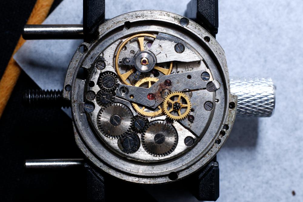

Mine was a almost a complete non-runner. Couldn't be wound from the stem. Barely ticking when wound with a screwdriver (I think it's necessary to wind the ratchet wheels, and they're anti-clockwise so after a few turns will loosen the screw) Filthy, filthy dirty. Setting lever spring is broken, the yoke is almost worn completely through where it rests on the sliding clutch. Rotor and axle as loose as can be, a bent pinion on the centre second sweep etc. Dial face isn't great etc. Yet, for some reason, I want to get it running again. For the moment it's get the core running and keeping time, then decide whether to continue.

Eek! I'm trying to imagine how many times a watch would need to be wound, and what kind of abrasive there must have been present, for the sliding clutch to wear that much of the yoke away.

That's how it should look so it doesn't contact the clutch when winding.

Really? I haven't worked on a Slava before, and the amount of black gunk that was around the keyless works, and everywhere else, the rust, the threads wrapped around the winding stem that made me think of someone knitting going: "knit one, pearl one, drop one", and everything else, made me convinced it had been worn. Or are you, if you'll pardon me, winding me up?

Presuming were talking about the 'missing' part in the photo below then
it maybe a little worn but from what I've seen, nothing out of the ordinary.

I cleaned and wound the mainsprings in my 2427 using a modified M6 washer and the crank from a winder, but they were a bit coned, have a bit of a kink in the spring where it meets the end of the bridle and the resultant amplitude is quite poor. 250, maybe a bit higher, on a full wind.

Confirmed that this is how the yoke should look when taking apart a 2428 for parts. I saw a post that you've left the forum. I hope that's not the case. You've helped me more than once and it was very much appreciated.
