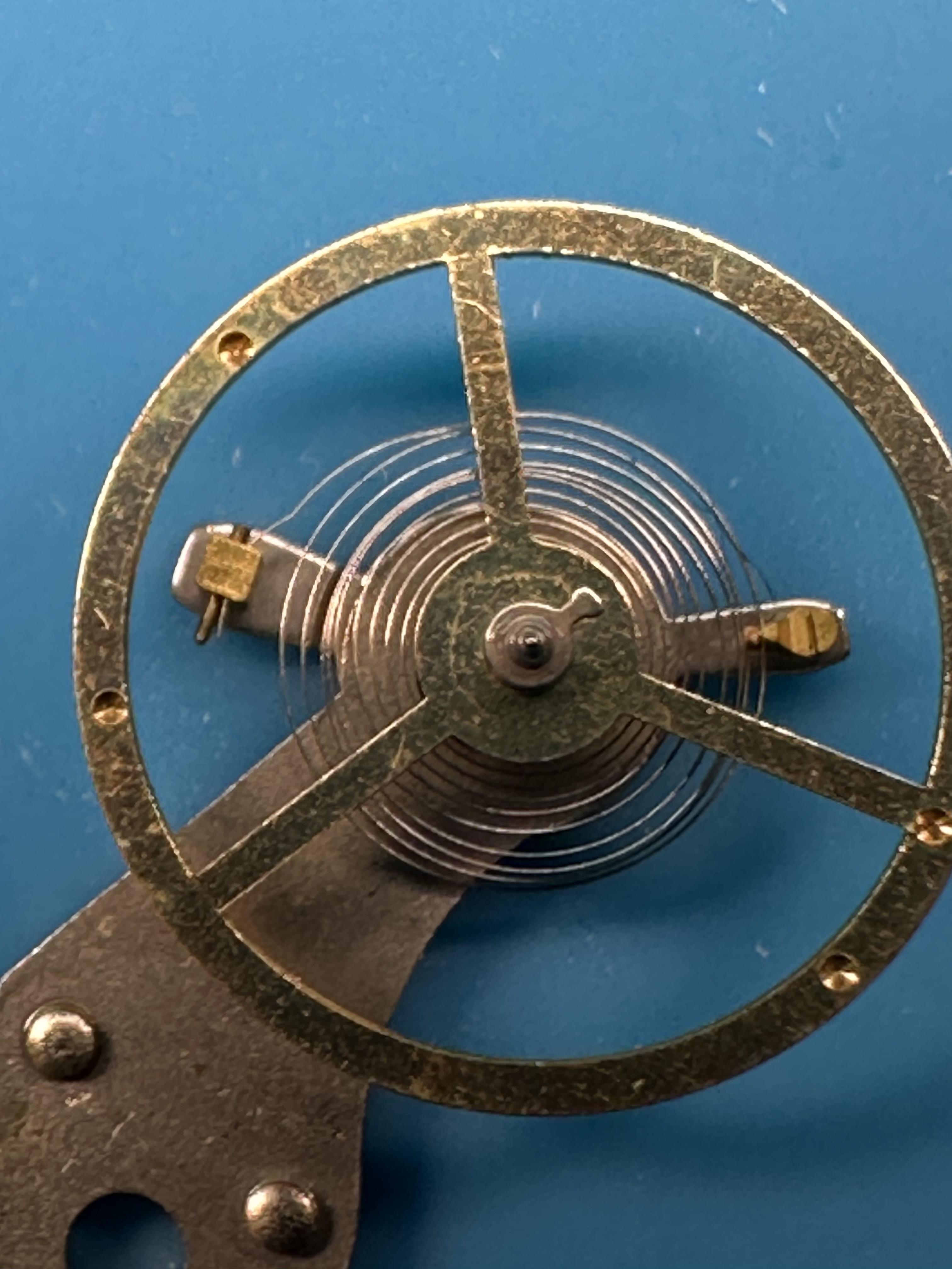

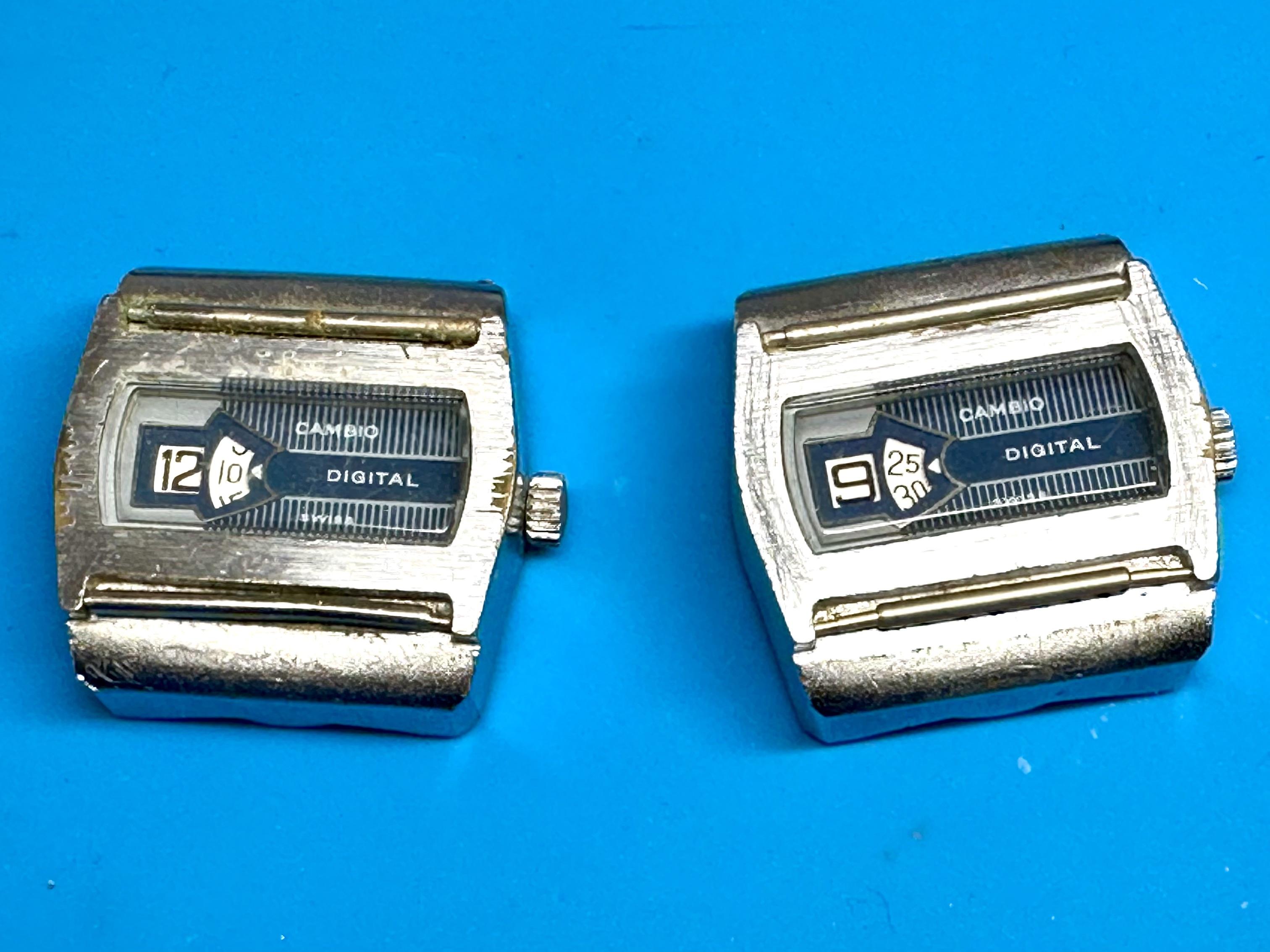

I have a couple of Cambio Jump Hours. One works fine. The other didn't but a new click and it does. Kinda.
Issue is the hairspring is a bit wibbly wobbly so I was looking for a replacement.

ps of course I'll attempt a manipulation first, but it'll be my first...

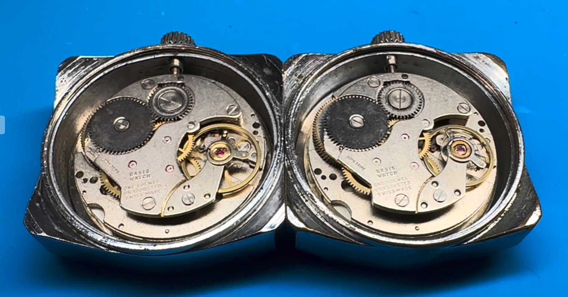

When I compare both the working and trying movements side by side, I noticed that the balance wheel on the trier is smaller than the one on the runner. This could either be due to changes in design, or someone slipped a "nearly" balance replacement.
My question for you great bunch is does anyone know whether there are any generic replacement for the 582 such as from Renata? Perhaps an 866 balance?
Plus the question regarding the jewelled version above...
Are you aware there are 2 frequency variants for this movement 18000 & 21600 which probably explains the difference in balance sizes.
The question then becomes which is correct as other parts also vary depending on the frequency.
Yours does not have an impulse pin or roller table/ safety roller. The staff has a finger directy fitted to it.
One balance may have an impulse pin and roller the other with a staff finger.

I'm interested to hear how you get on. Yes, the spring is a bit mangled, but it should be fixable. Read up on hairspring manipulation before you start rather than after you make a mess (like I did with my first one).

Can you tell which is the correct balance for @AndrewR movements based on these photos?
Given the big one is running well I'd say that one, but who knows. BFG might have changed the design. It sometimes happens I believe.

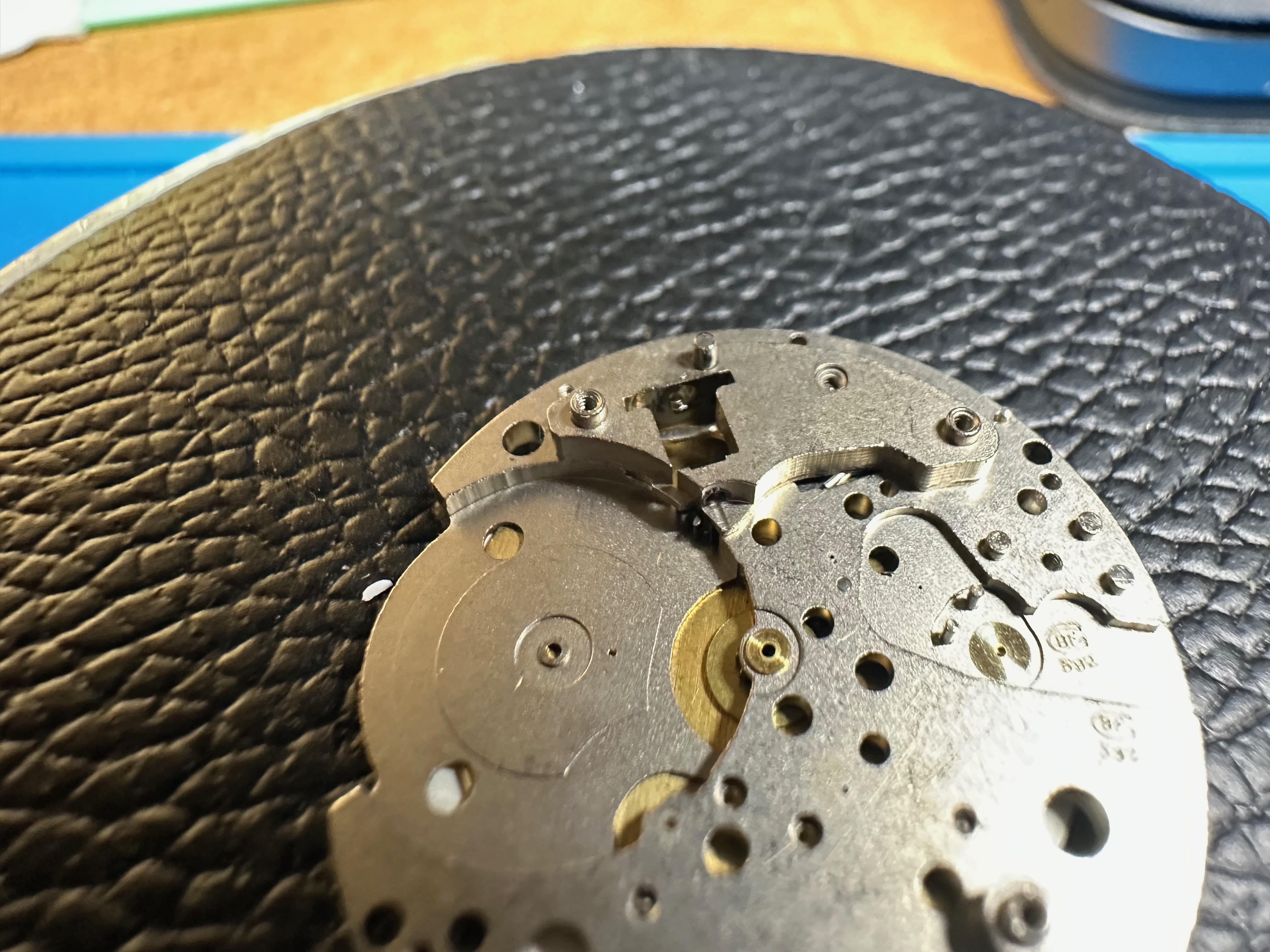

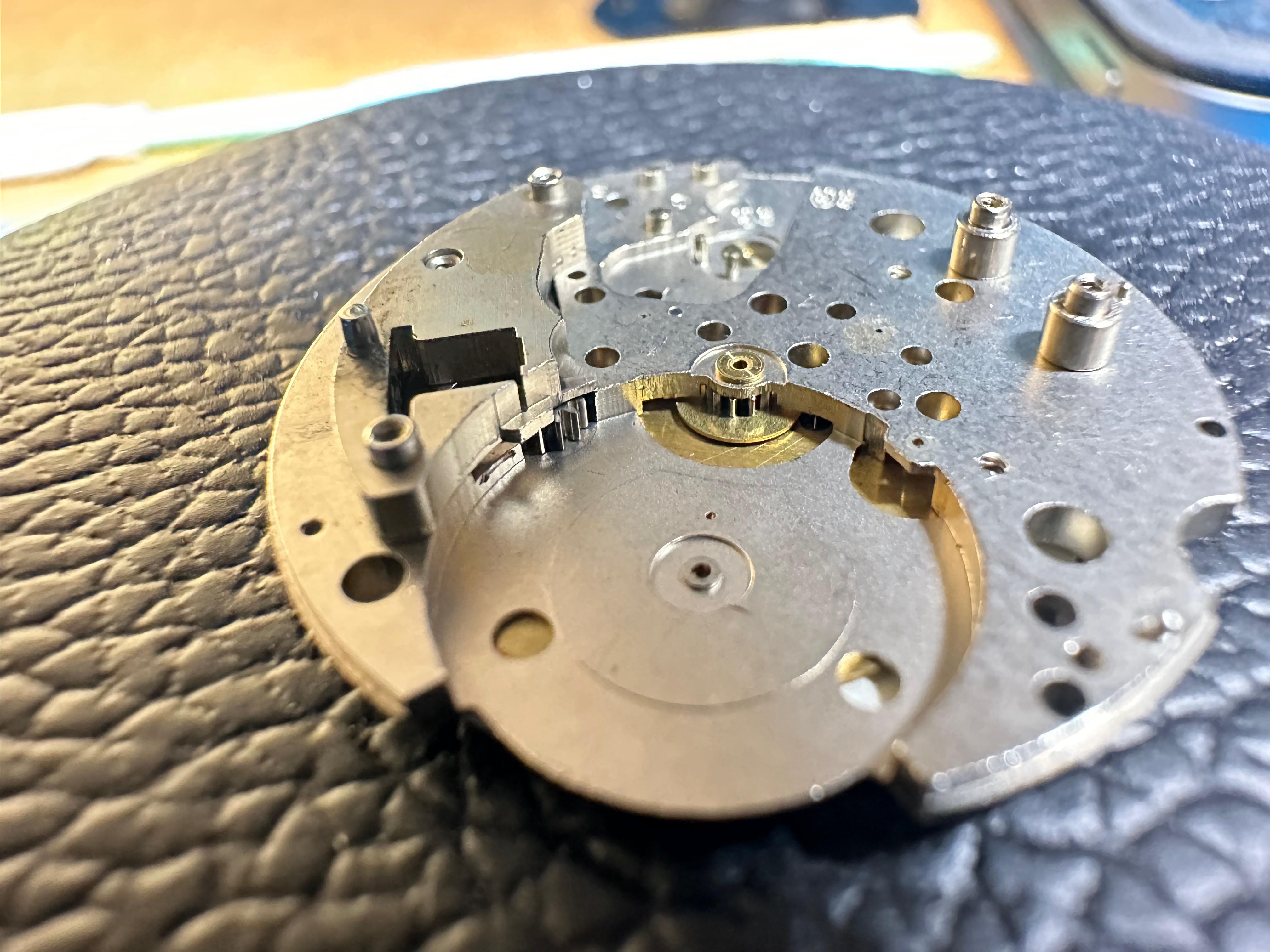

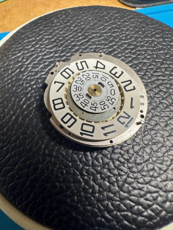

So I've disassembled most of the movement side but can't remove the keyless bridge. After searching I found a photo suggesting it's screwed from the dial side.

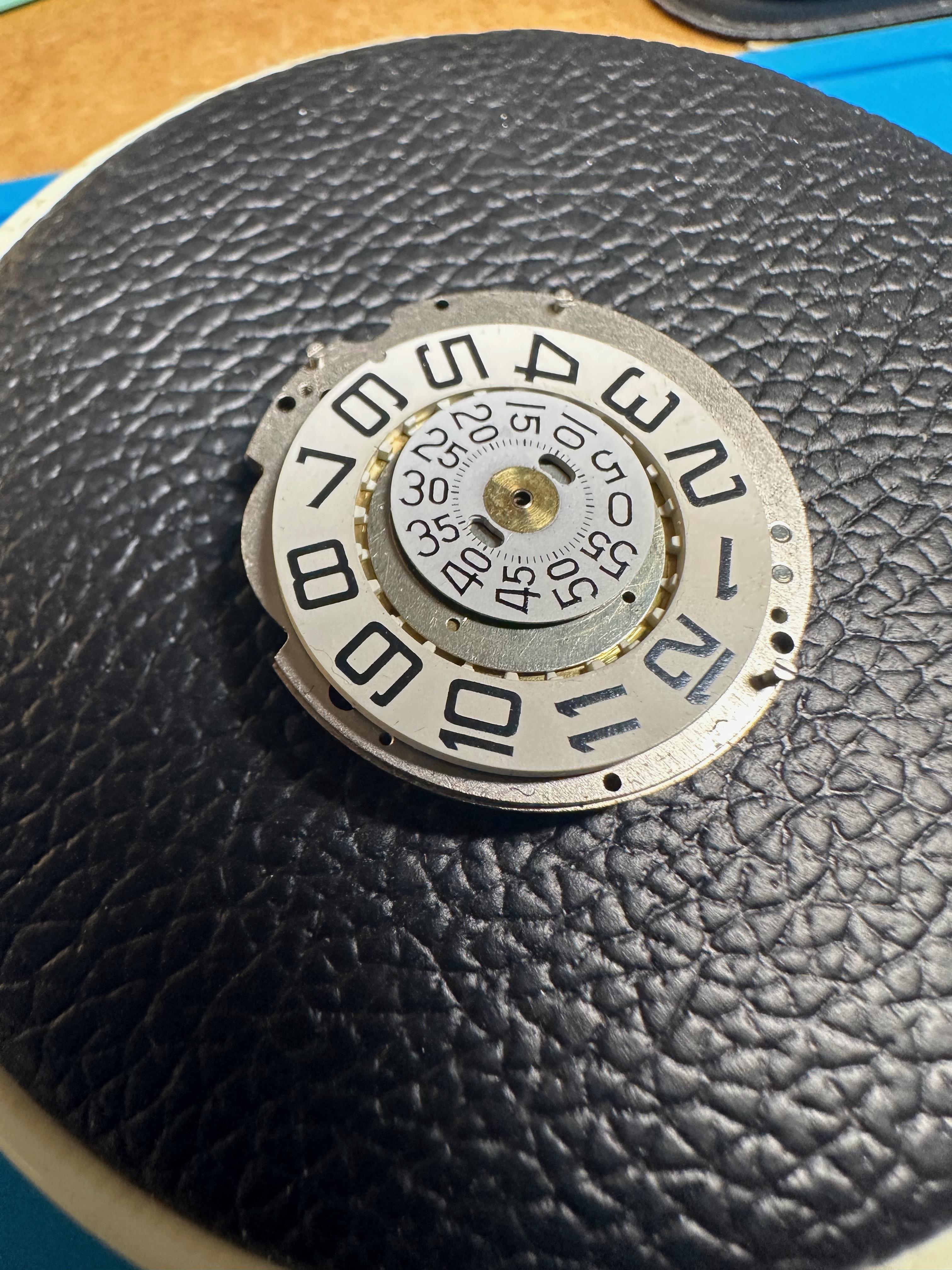

On the dial side I can't figure out how to remove the minute wheel. When I pull it up it feels like it's attached so I don't want to blindly force it. I watched a video of a Lucerne jump hour, and although similar it isn't a BFG582. After removing the keyless bridge on that one (screwed from teh movement side) and removing the intermediate wheel etc, the minute wheel pulled straight off. It's not in English (possibly mandarin) so I couldn't follow along anyway.
Has anyone go suggestions/knowledge of wha the next step is, and how to (safely) remove the minute wheel?
I am not familiar with this movements, but the balance shown is Roskopf type. The impulse finger is separate part from the staff, it is like washer that if tight fit on the staff. The safety roller is part of the staff it is machined with. If there are balances for this movements with impulse jewel, for sure it will not fit here, at least without replacing the pallet fork with one that is designed to work with this balance.
Now about the hairspring. The first thing is to remove the balance with the spring from the bridge. You have to open the regulator and then to remove the stud from the stud holder. Not heeded to remove the little tapered pin that fixes the spring in the stud. The stud will come out by twisting and pulling it. Then clean the spring to ensure it is not sticky and show picture from above.
The big balance is for 18000 movements while the small is the 21600 but without knowing what other parts are fitted you can't be sure.
It's press fitted onto the hub as a normal hand would be so you need to carefully lever it using the 2 slots.
Good Lord that was traumatic. Thanks.

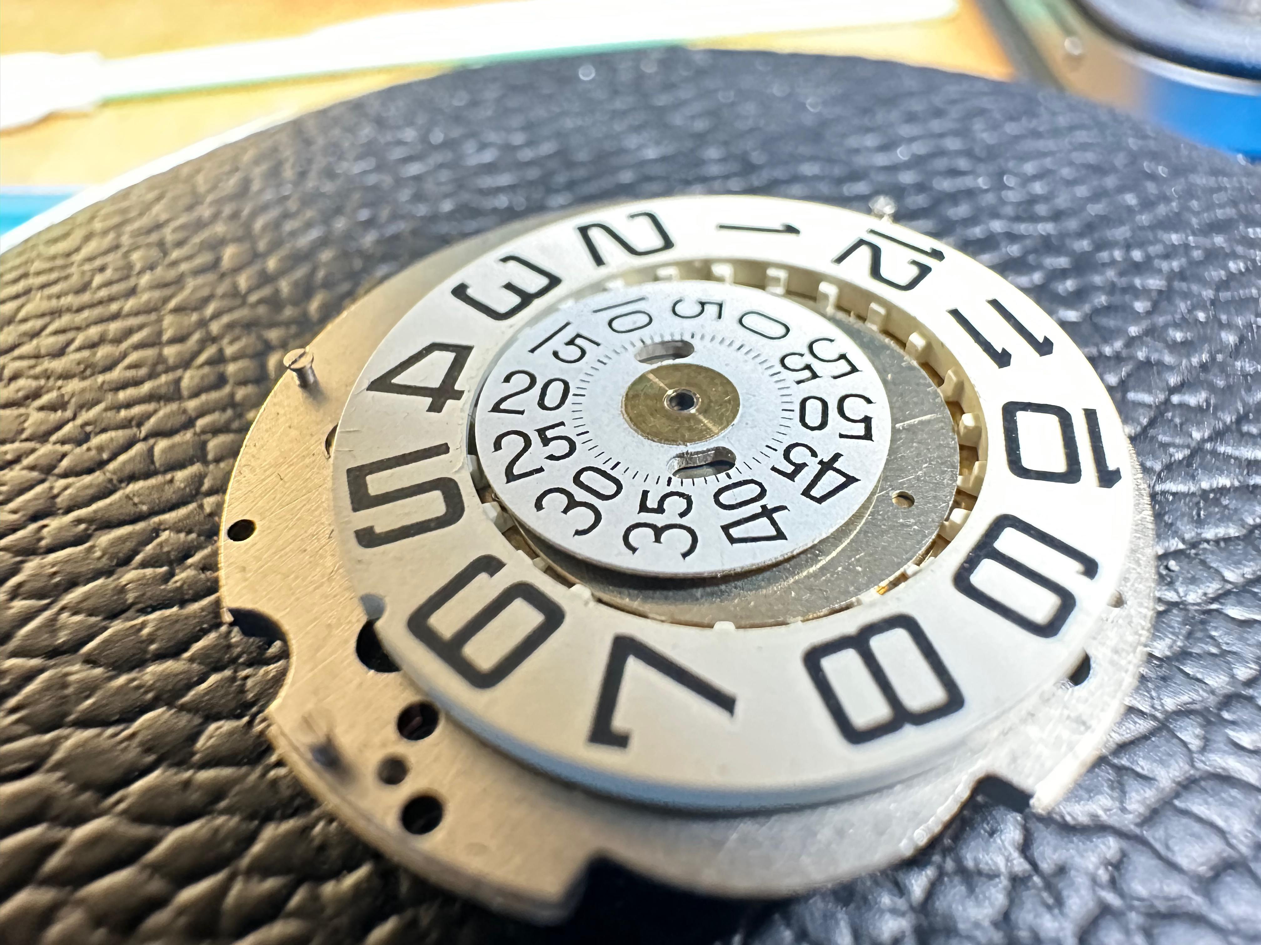

So I stripped it, cleaned it, and put it back together.
I did some gentle stroking of the hairspring, and I got it running. Hooray. Still needs more work to get it running sweet.

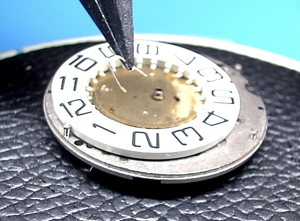

Then when I was putting together the dial side, the jumper spring launched into orbit. An hour of searching and I've given up on it and hitting suppliers....

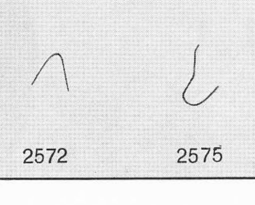

What spring was it? Yoke of either of the Date ones?
10 hours ago, AndyGSi said:
That's all part of the learning curve.
It's an hour jumper spring.
The question is would the date jumper be the same spring? It does the same function.
Or would a similar looking spring do the same job. It's just a half paperclip looking thing.
Completely different looking spring.

That's presuming the Date Jumper Spring is what's being used for the Hour Wheel.
