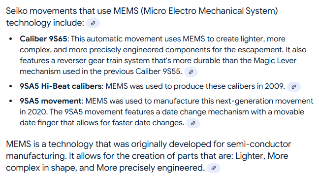

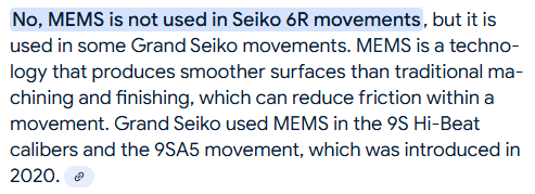

I don't know how from the Tech Sheet you could tell?
From a goole search.

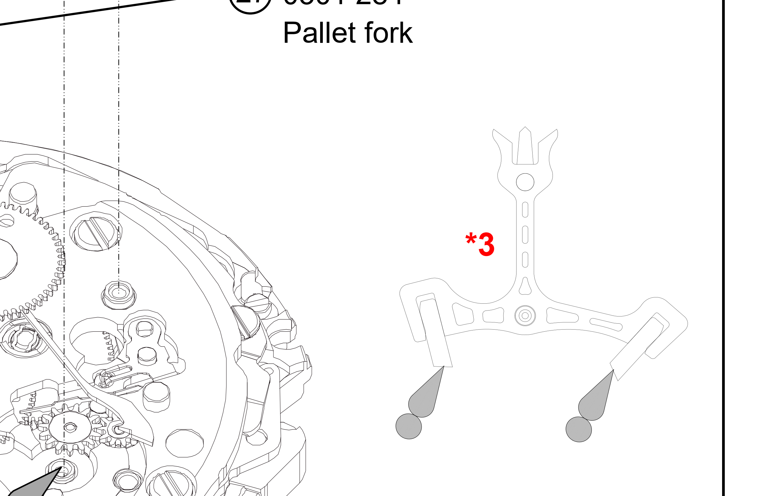

from here:
If only I saved that watchmakers photos!!!! I just thought they would be up forever! But you can still read the 2nd comment on his original thread saying how good mems is.  https://www.thewatchsite.com/threads/6r35-caliber-tear-down-findings-update.349895/

You mean from a drawing that looks nothing like the actual pallet fork?
Expand
that is exactly how it looked from the watchmakers photos that are lost. I saw it with my own eyes

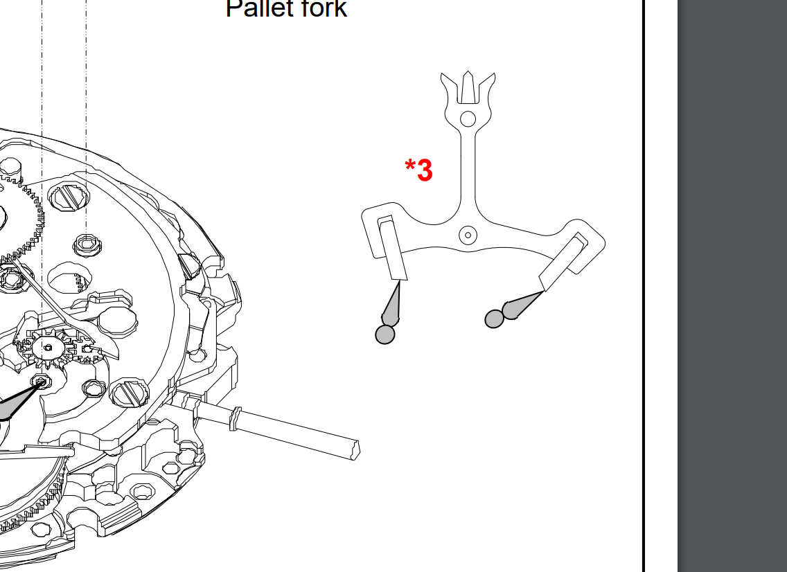

And you can see here on the 6R15 before the MEMS was used on the 6R35 and 6R55 Seiko drew it normally:
This is from the 6R15 Tech sheet:

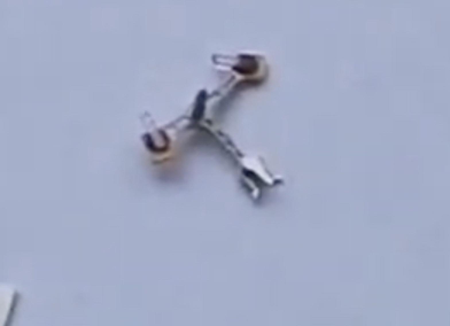

Yes I'd seen that video but wouldn't have expected an original looking at the state of the shellac when the idea is to make them light weight.
Edit
Just found this photo of an original fork and the shellac does just look as bad but there's
no cut outs on the central shaft and it appears shorter than the one in the video?
It's typical as well that he appears to jump over inserting it to get a better view.

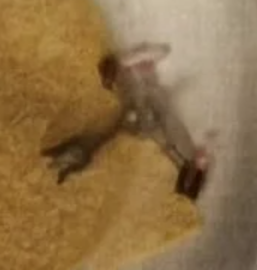

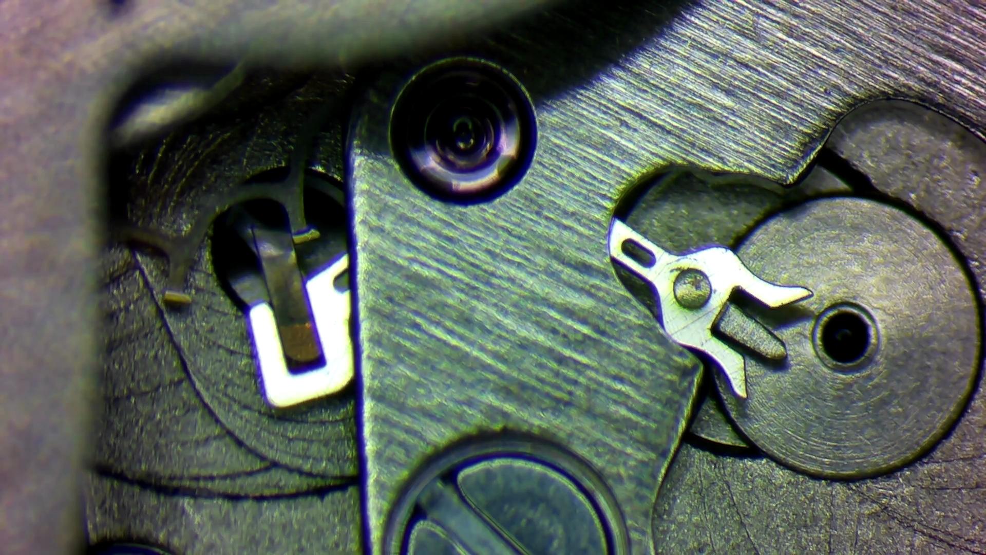

Nah, that's too blurred to draw any meaningful conclusions.  Here's something in focus. Doesn't show the whole pallet fork but you can clearly see skeletonization on the shaft and one of the arms.
0002.thumb.jpg.c64e7616e229a2e3e46b57dcc24e77c1.jpg0001.thumb.jpg.c27897d930bb611be3f2c3aeb4580632.jpg
