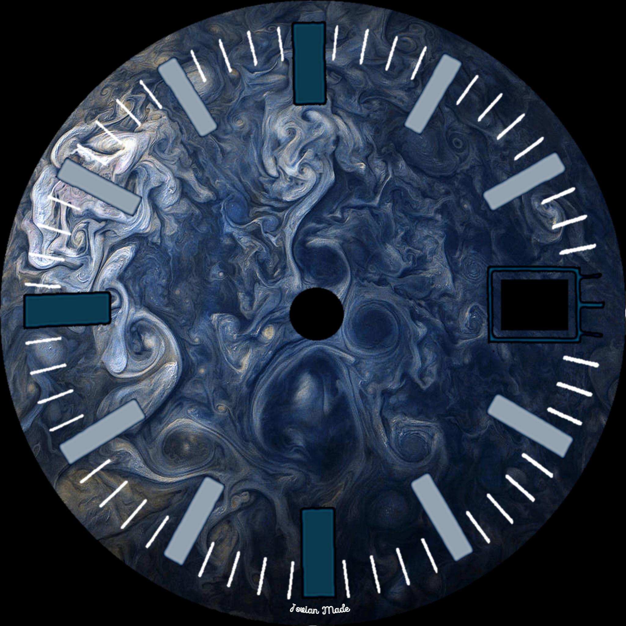

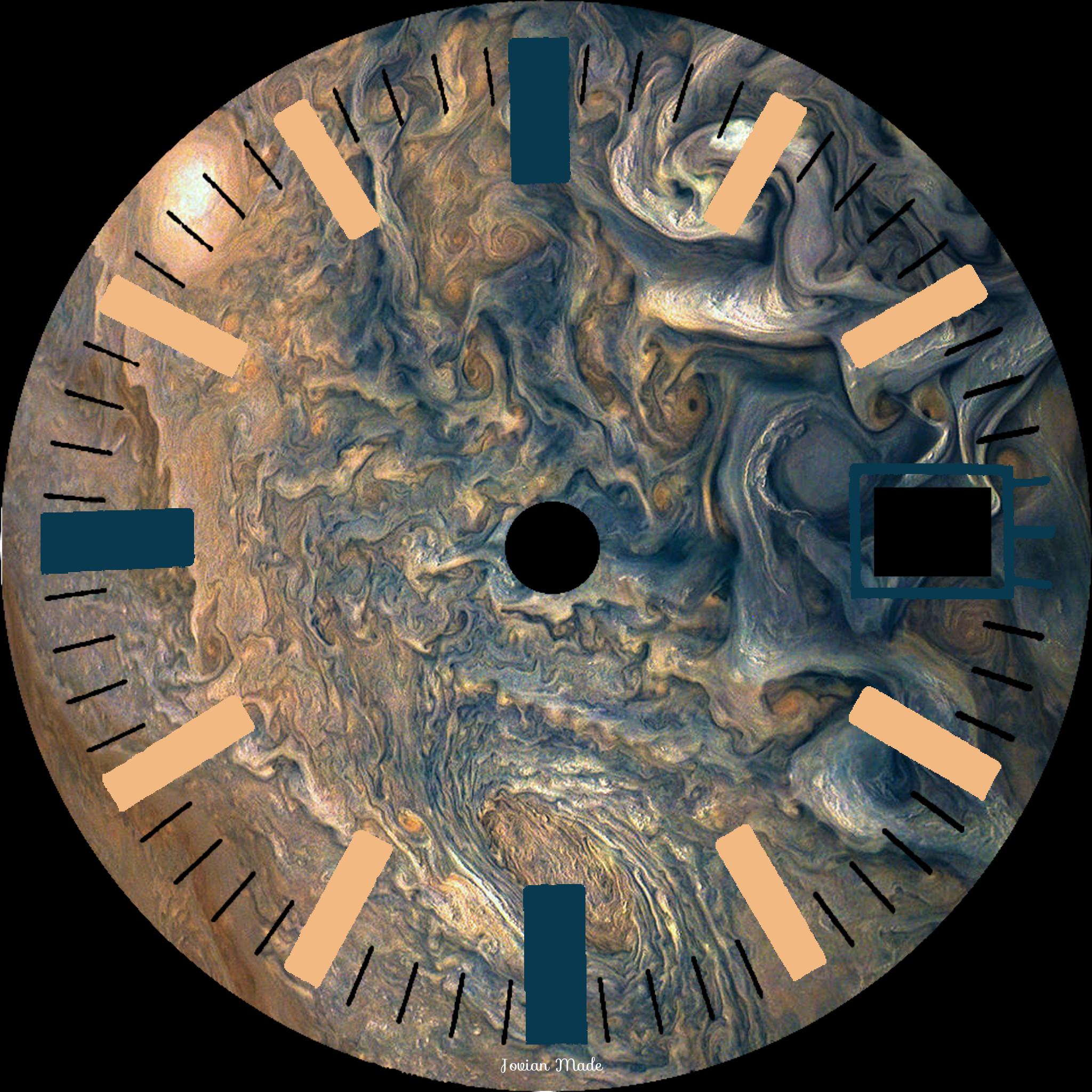

There are a couple of separate threads that discuss custom dial making, but rather than clutter them up, I thought I would place some of my own designs in this thread. After all this thread is pretty random as it is, so a little more randomness isn't going to matter much.
You are welcome to "borrow" these designs for personal use, but if you decide to do anything commercial with them, PM me first, so we can come to some arrangement. The original artwork is layered, and higher resolution.
The images are some rather stunning cloud formations on Jupiter from the NASA Juno space program -> https://www.nasa.gov/mission_pages/juno/images/index.html
I may do a little more planet and solar system themed artwork if I get the time.

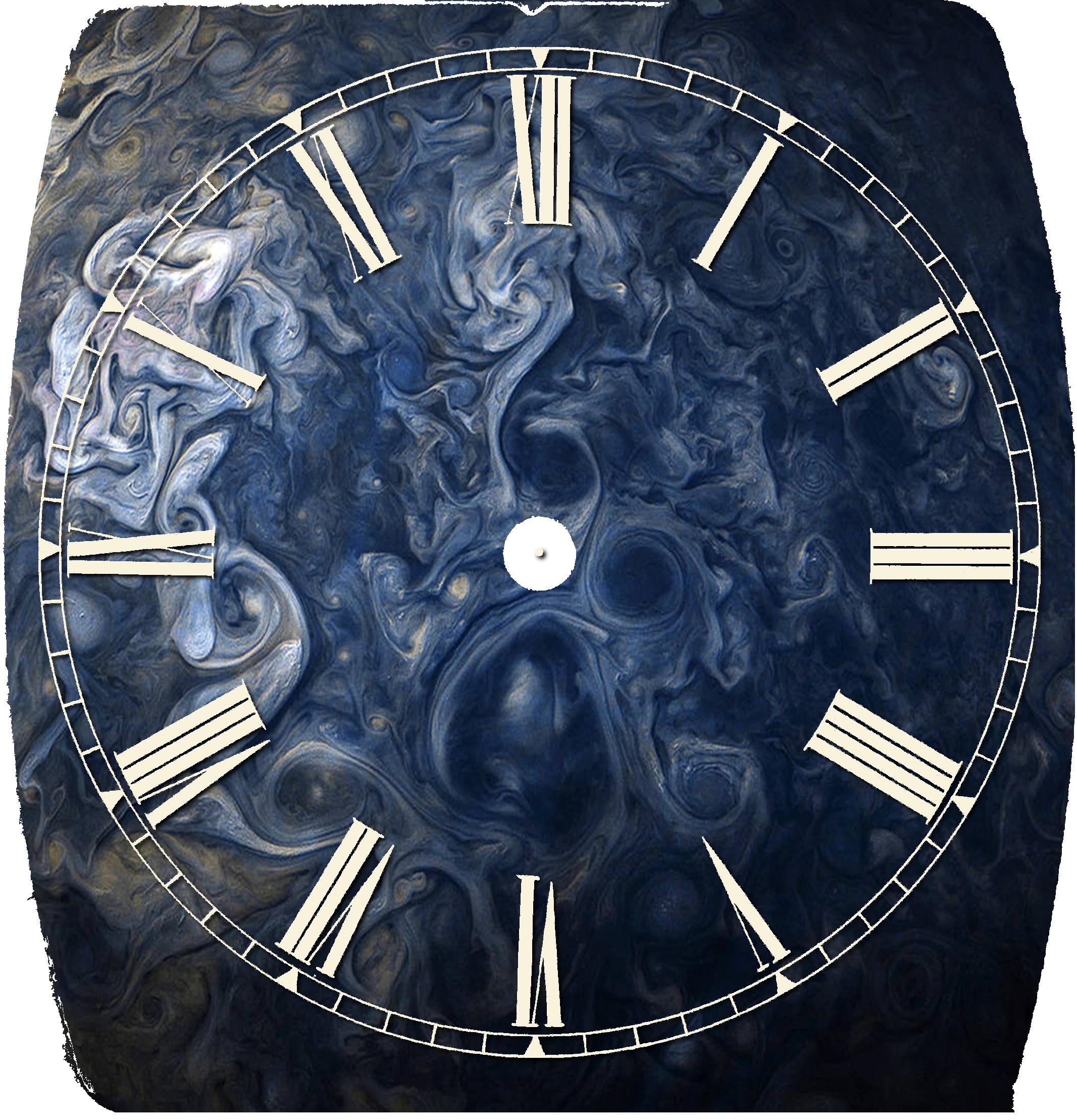

I took some closeup pictures of the dial, which I had carefully extracted from the watch, and used these to give me my dimensions.
Then I went to work... or should that be play..
This is the first draft that I feel is reasonably close to what I am looking for.
Below is the original dial.
Now all I need to do is wait patiently for the decal paper to arrive, and see if it looks presentable in real life.
I tweaked a few things, softened up a few edges, improved the drop shadow and added in some text and the Voyager spacecraft.
Whether I can coax this level of detail form my inkjet printer on the decal paper remains to be seen.
This image includes the transparency layers, alpha channel etc, so it about 5.6Mb compared with 2Mb or so of the jpg above.
