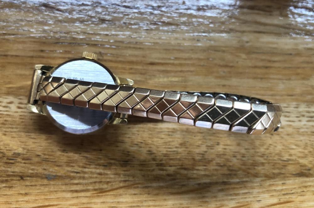

Morning all,
i have inherited my great grandmothers watch and would like to have a few links added so my wife can wear it.  Is it possible to add links to this strap?  I have attached photos for your reference.
Thanks in advance,
Chris
Some of these can be adjusted by removing links, but not sure about this one. However, even if it is adjustable you will be hard pressed to find the right links. It is an aftermarket strap, not the original.
These type of straps come up on ebay quite often, but much easier to buy a nice new leater strap...
