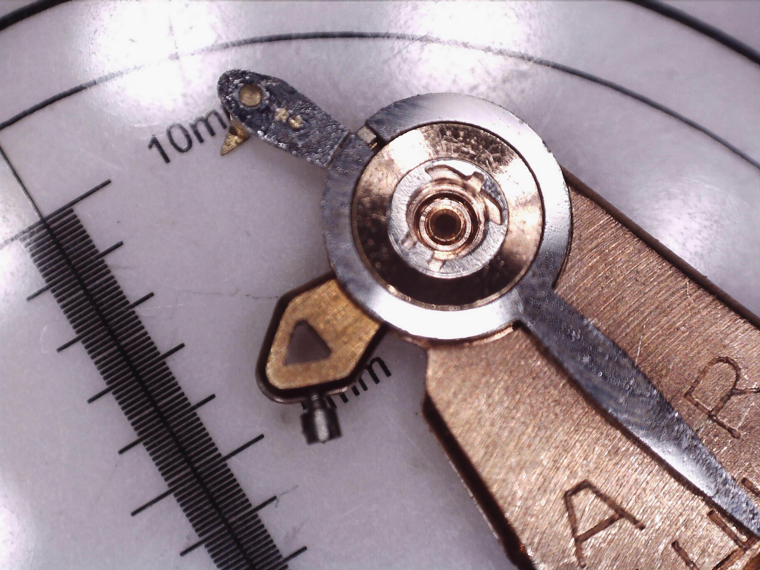

Hello,
I'm new to this forum that I've followed for a while.
I began to collect watches, also trying to service them. Not very successful so far, but I'm learning.
I have to replace a regulator on a balance bridge on Omega Seamaster cal. 286.
I don't see any screw to remove it , don't want to break anything.
Any suggestion would be appreciated.
Kind regards
Luc

Pops right out , pushed back on with friction
