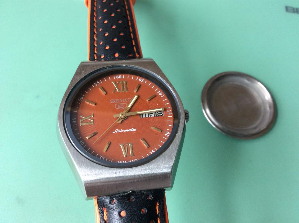

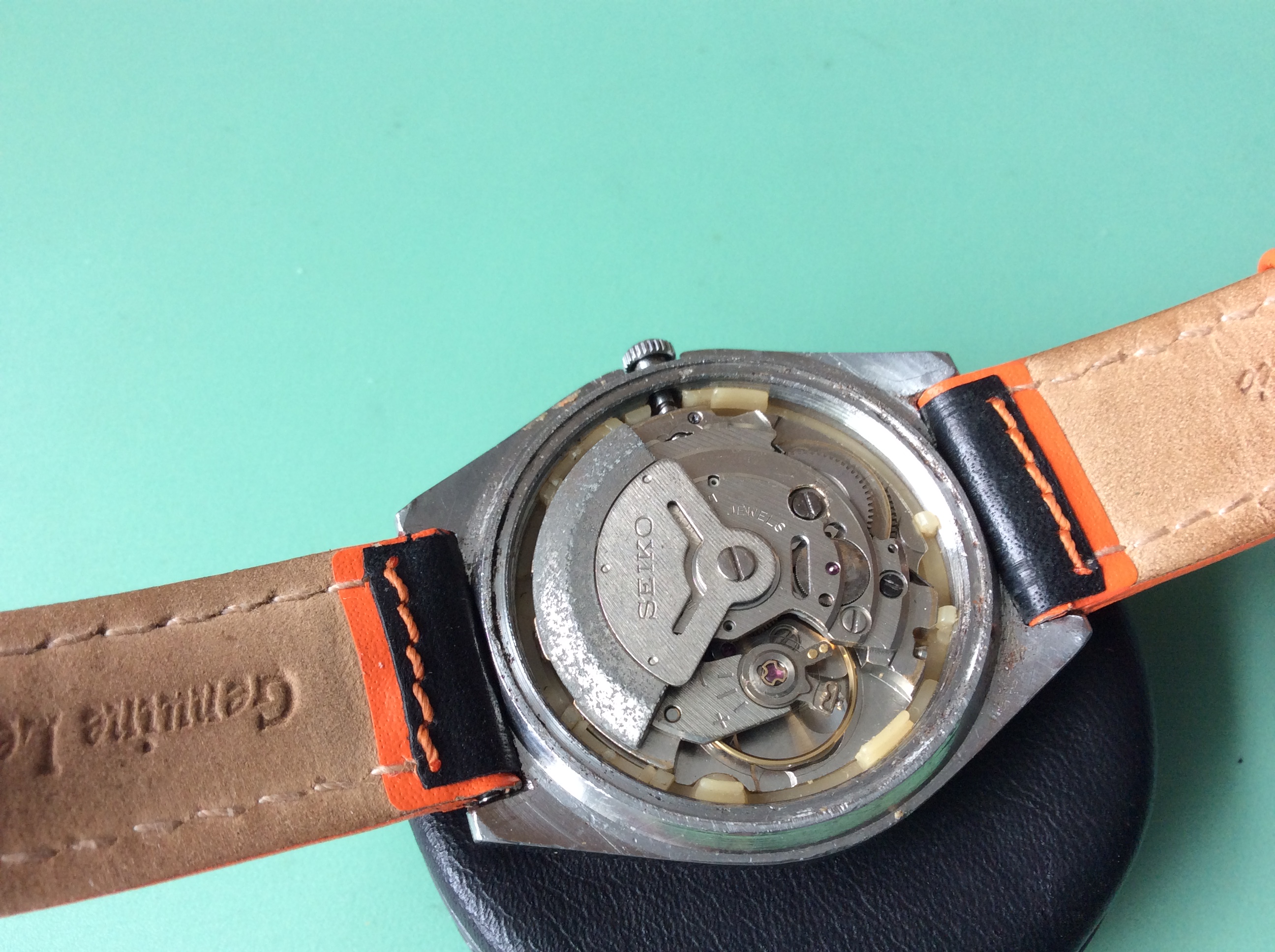

Hi all, I have this seiko that I got as a non runner, I stripped it cleaned it serviced it and fitted a new mainspring and put it on an auto watchwinder and it ran ok for two weeks. I took it off and wore it then it started gaining time like 20 mins in a couple of hours and I have noticed that about every 10 to 20 seconds the seconds hand has a little spurt and suddenly moves on by 2-3 seconds hence the gaining time. I have never come across this before so any ideas as to the cause. Thank you in advance Tony
Does the 'spurt' occur at regular intervals?  It could be wheels binding due to a bent pinion.  I would look closely at the interaction if the pallet fork and escape wheel.

it seems to be as i say anytime between 10and 20 secs you get the little spurt of 2 to 3 secs, i think i will have to take it apart again and check the pinions.

I can't know what is wrong with the mov.t but incidentally let me note that (at least) the dial fakeness sticks out.
i know the dial has been refinished the seller listed it as a repainted dial and i could see that anyway but i liked it so i bought it.
I usually remove the balance, give the mainspring a wind and see if the pallet fork snaps from side to side when helped with a oiler. Then I remove the pallet fork and check if the wheels spin true with no wobble. You can also observe endshake as well.
If the watch is very dirty a dunk in lighter fluid for a few minutes will help loosen the old oil. Remove day and date-wheels as well as any other plastic parts first.
The reason I do this first before cleaning is that sometime you find issues which render the watch not worth fixing unless you have parts. Nothing worse then cleaning a watch and then finding a fault which brings everything to a standstill!
Checking as you dismantle saves unnecessary work.

i am going to dismantle it again and check it a bit at a time, thanks for the tips.
