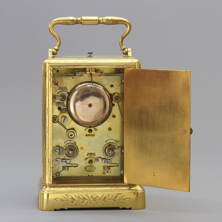

The easiest way in telling the difference between Chinese and French carriage clocks.
Chinese the strike work is always on the back plate, holes in the bell, screws poor and a very dark blue and mostly cheese head, very poor brass if you can call it brass. Platform escapements cheap looking and many look like they are made of poor soft metal. Many Chinese carriage clooks come with a centre seconds the hands are poor looking and not well finished. You don’t come across the French carriage with centre seconds but the do exist. Chinese carriage clocks that have painted panels are poor quality bad detail and most likely painted by children. The French are suburb with detail and the finish can be most delicate.
Here are a few photos of the Chinese rubbish and a few of the French good quality movements.
If you are thinking of buying such a clock let me know and I can advise you about it

1 and 2 Chinese 3 4 5 French
