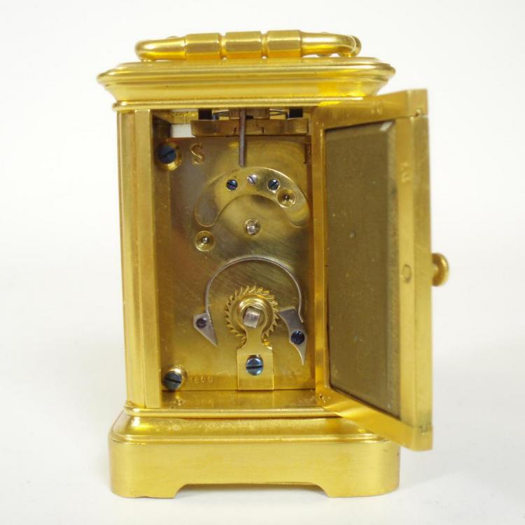

Compare that to a genuine french miniature movement,
The quality of screws is very apparent all nicely polished and blued there is a delicacy to the construction of the parts that the Chinese have never matched.
