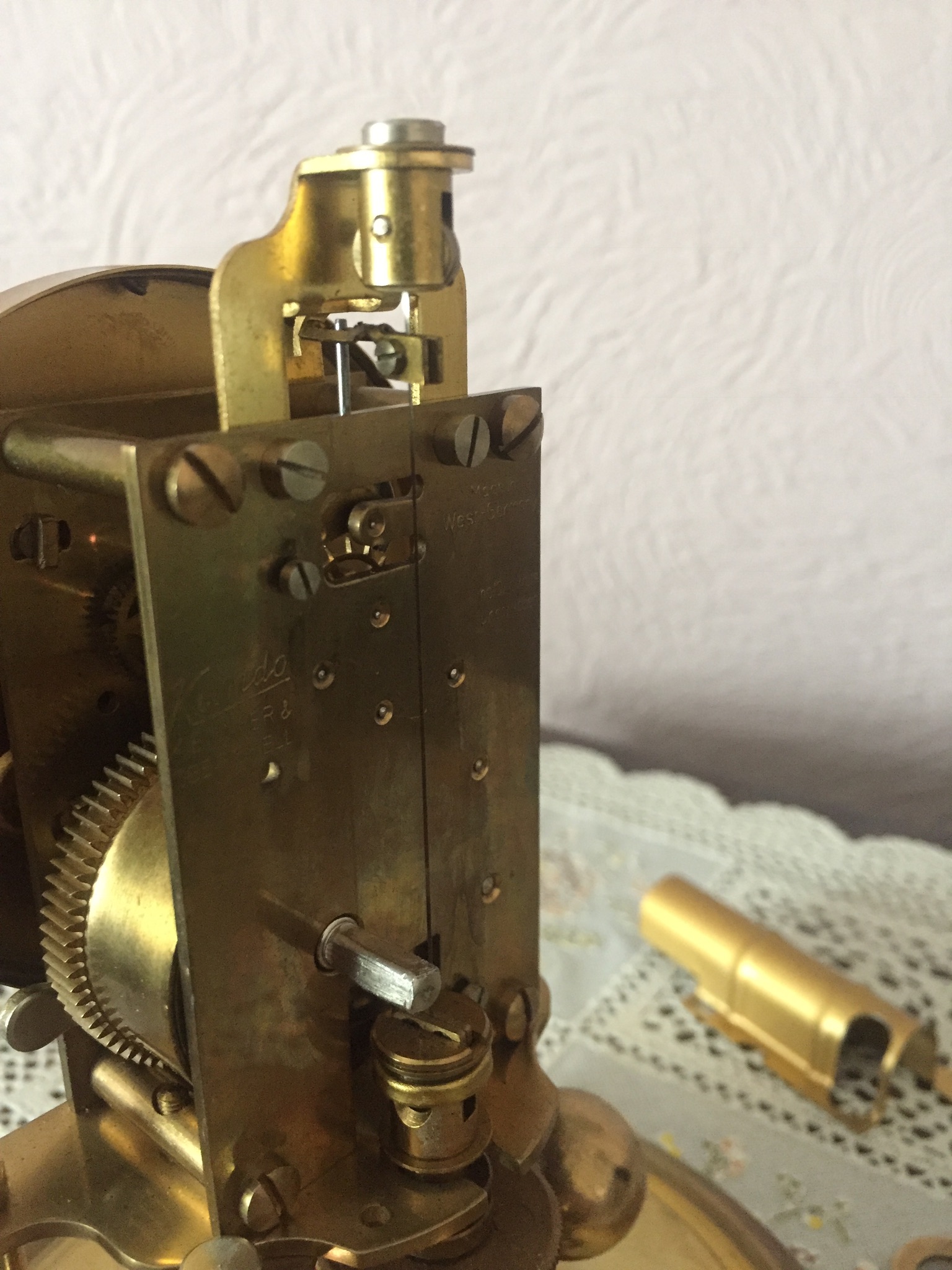

I need to replace the pendulum spring (the one the balls hang on) on a 400 day clock. Does the new spring have to be exactly the same thickness, or can there be a bit of leeway.
If it is a wind up it is essential to have the right s/spring and the same goes for the length. Also the block that goes each side of the anchor (long stem) has to be in the correct position.  This book is the clockmakers/repairs bible when it comes to these clocks. A photo of the clock would be nice and one of the back plate.
The Horolovar 400-Day Clock Repair Guide 6th Edition By Charles Terwilliger

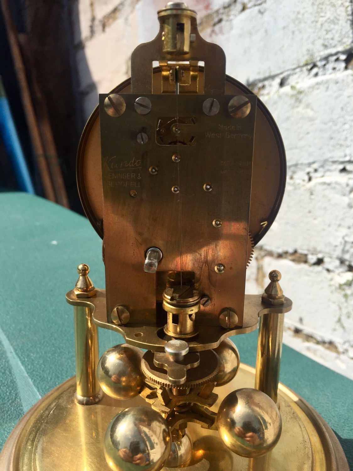

Can you give a good photo  of the back plate and the height and width of the plate and we can look it up in the book oldhippy mentioned above and give you the correct size wire. But that is only half the job fitting everything onto the new wire has got to be in the exact positions too as a few mm out can be the difference between it working or not
The spring is still in place, so I can measure it, but it’s such a small measurement, I wondered if it had to be exactly right, will one or two thou” either side matter that much?
Try and get it as close as you can. Any change in length and the clock will need regulating, to high = to fast, longer = to slow The clock also has a locking device so it still needs to be able to lock if moving with out kinking the s/spring. Make sure you don't bend the new spring

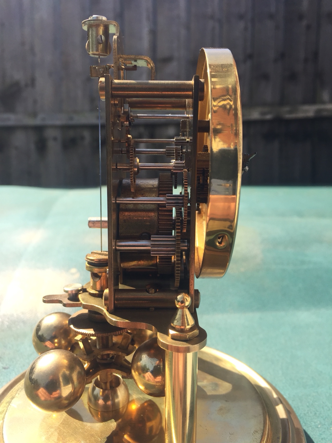

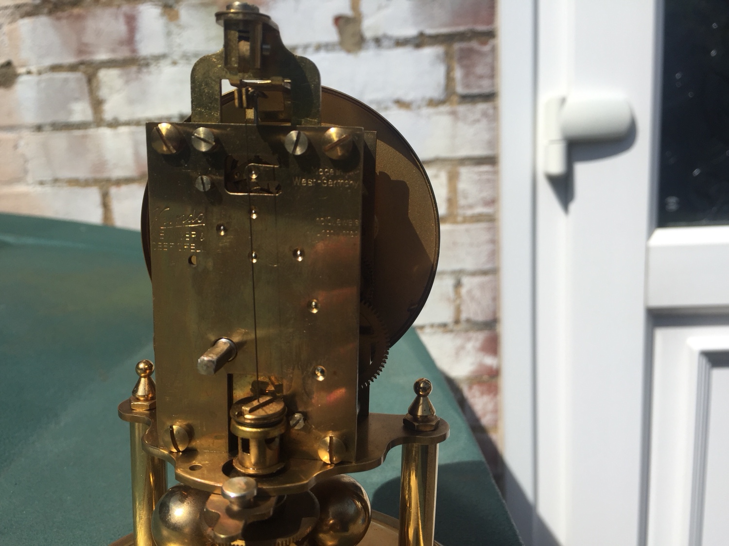

That is what’s needed. I’ll tell you how the book works. Tmuir will look up Kundo, you have the designs of the back plate and the positions of all the holes which consist of the train wheel holes and the screw holes. It gives the s/spring the thickness and the position of the blocks and the length all in a diagram. So when it comes to fitting the new one you cut to length, line it up alongside the diagram fit the blocks in position. Fit into the clock and if all is well that’s it.
That looks like plate 1407H Kundo 4 ball midget clock circa 1965
Use 0.0022" (0.056mm) Horolovar you want.
Page 133  in the 10th edition if someone else wants to double check.
It should do 10 beats a minute when set correctly.
Make sure you mark out the exact dimensions and the placement of the parts on the spring, or you can buy a complete replacement unit '5F'
