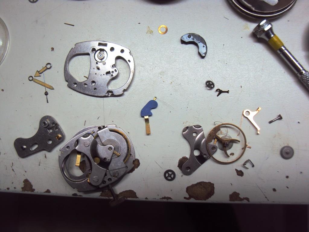

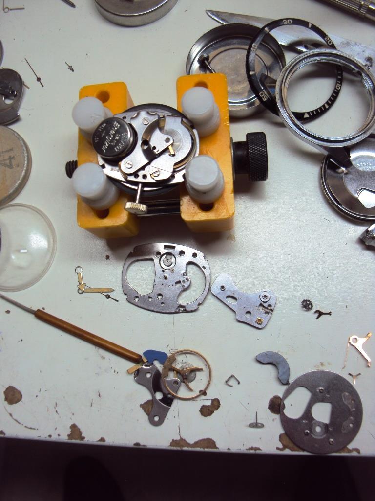

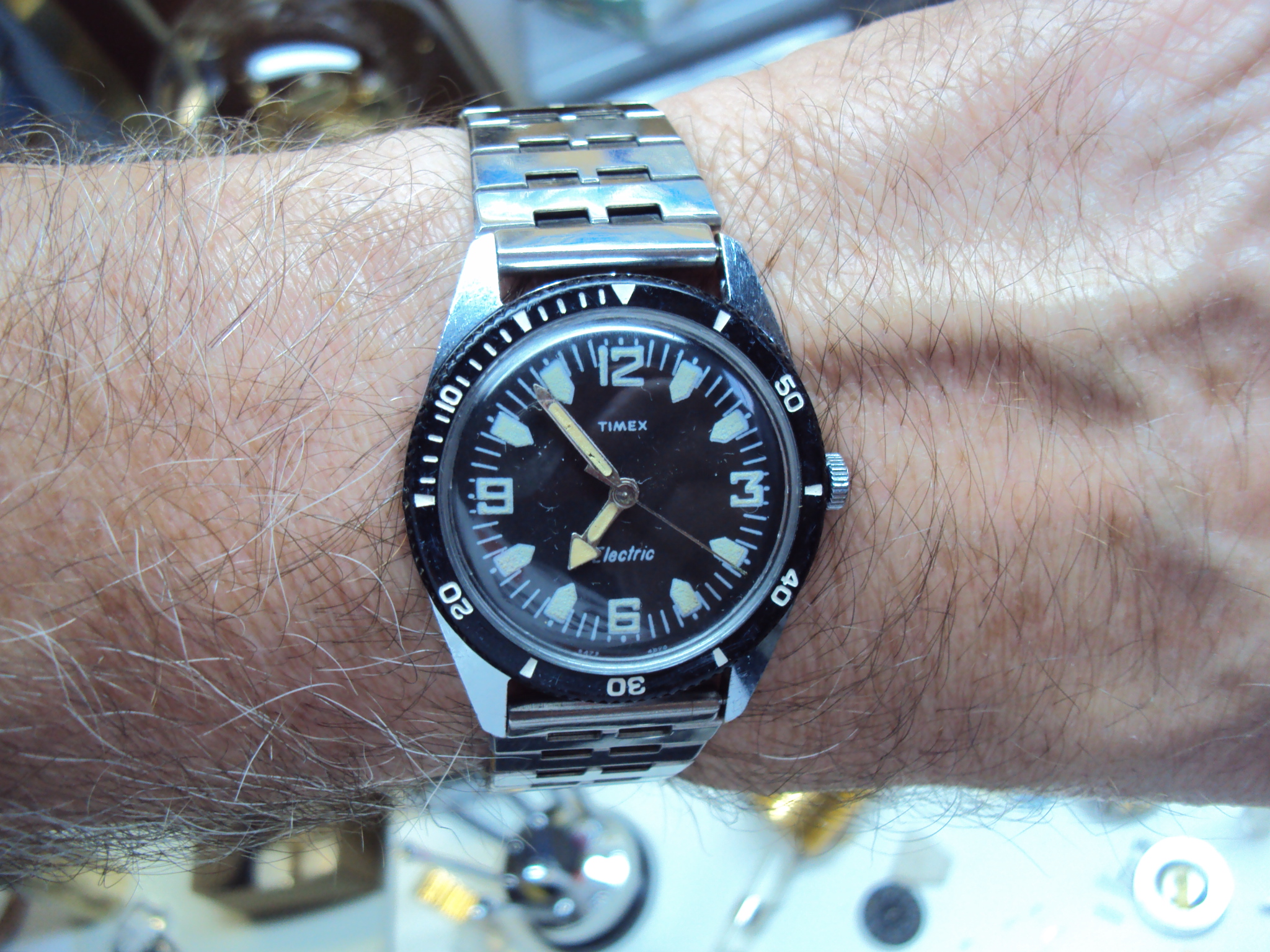

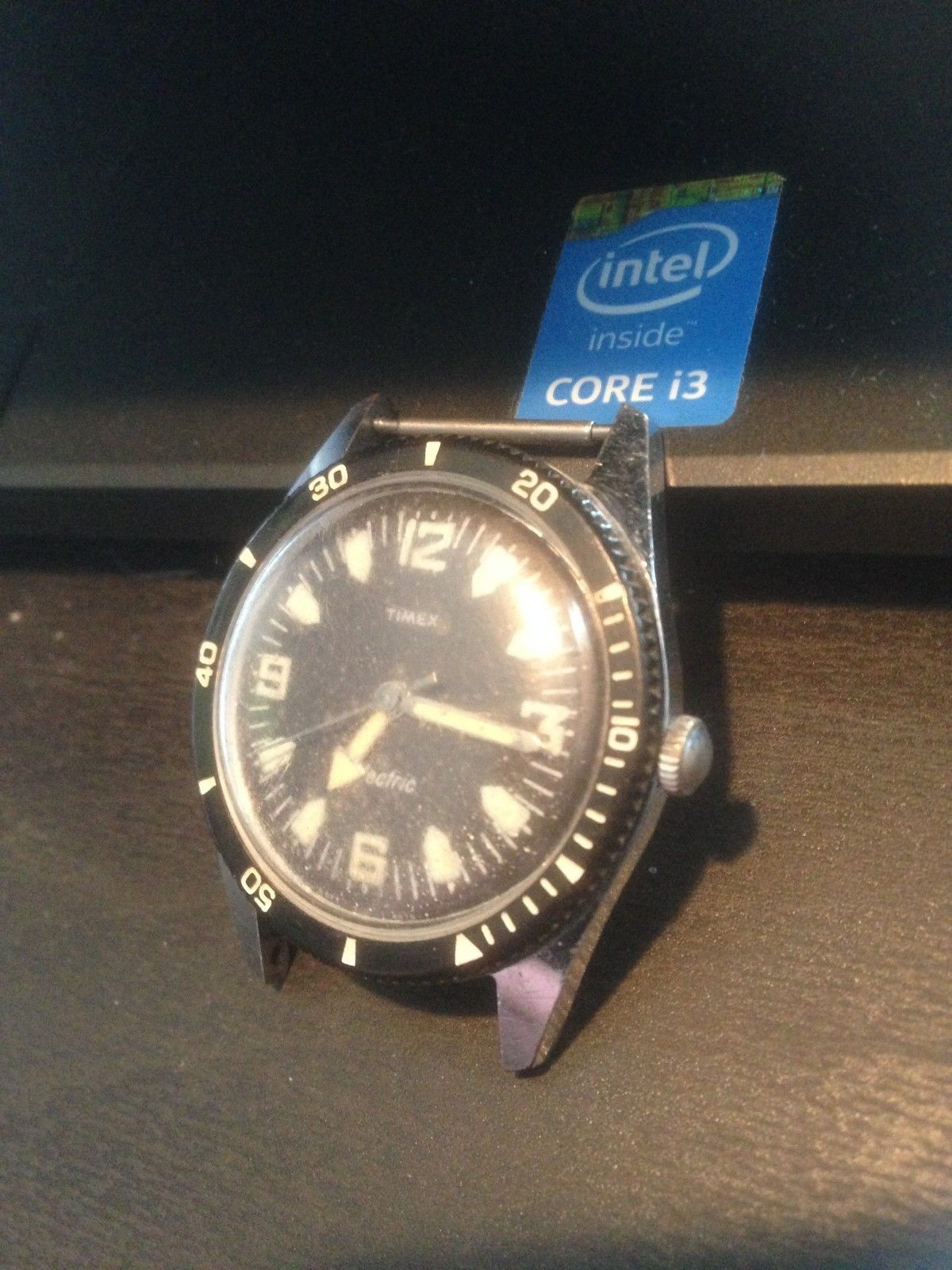

Recent EBay purchase of 1970 Timex Electric diver turned out to require more work than I thought.
In this case the stem retention clip was cracked in two and I noticed the fixed magnet had come on done.  What I did not
count on was the magnet being lose damaged coil on the balance. So I went to a parts donor and with little effort 2 became 1 again.
here we have the original seller pic and followed by the repaired watch along side it's new friends.
