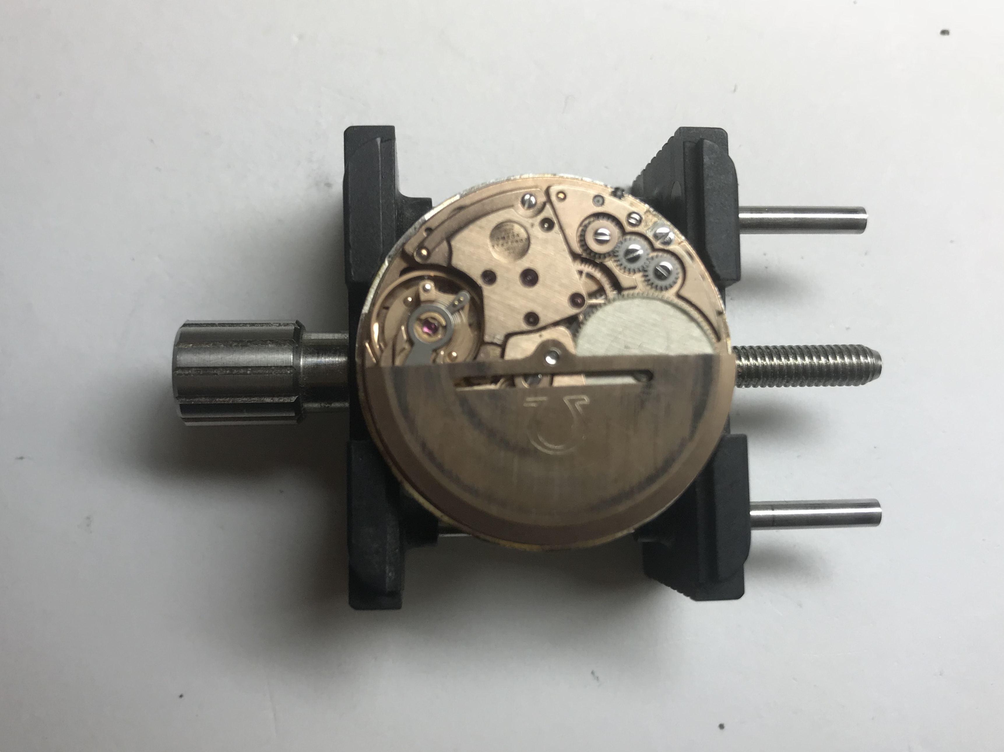

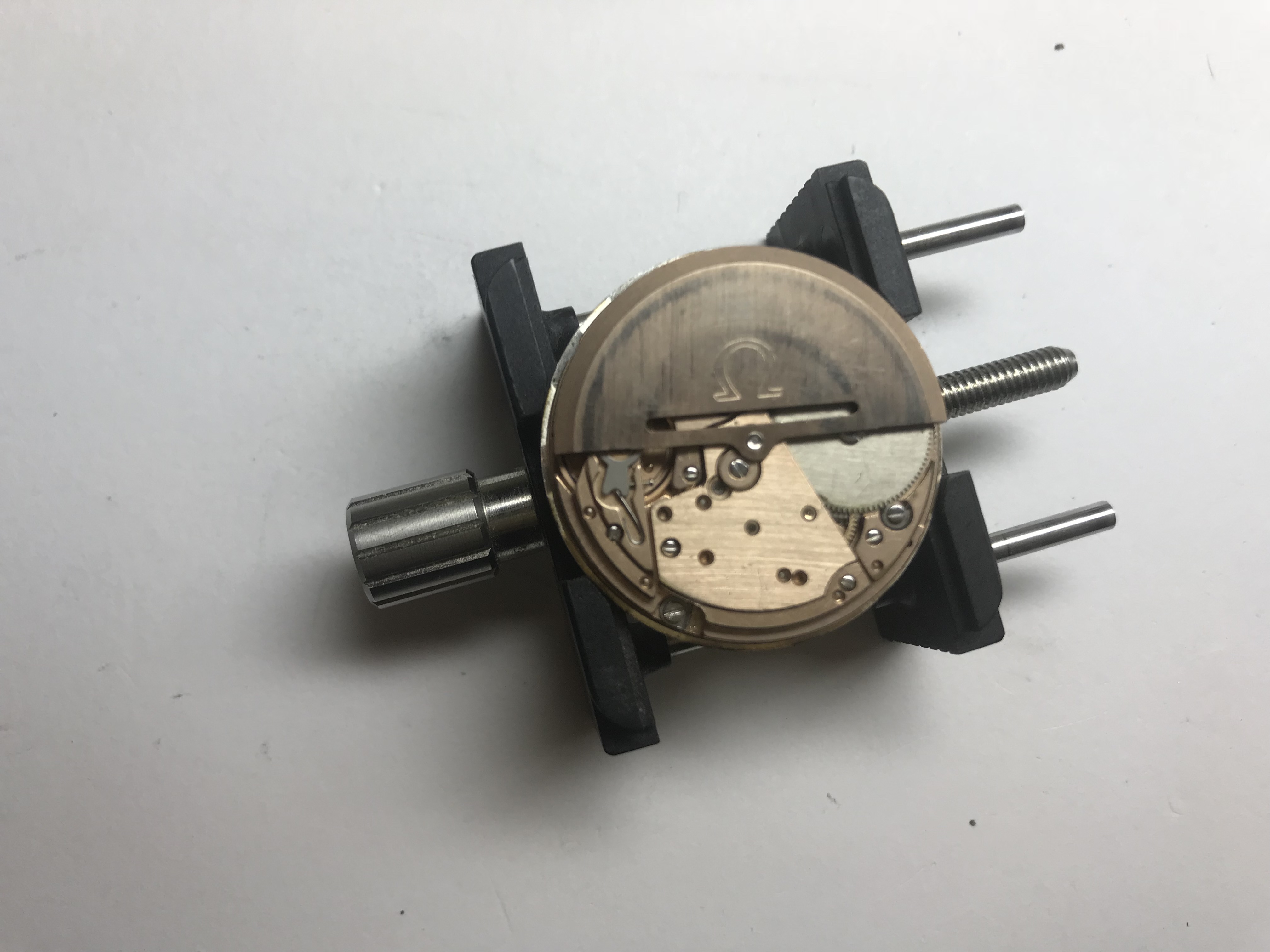

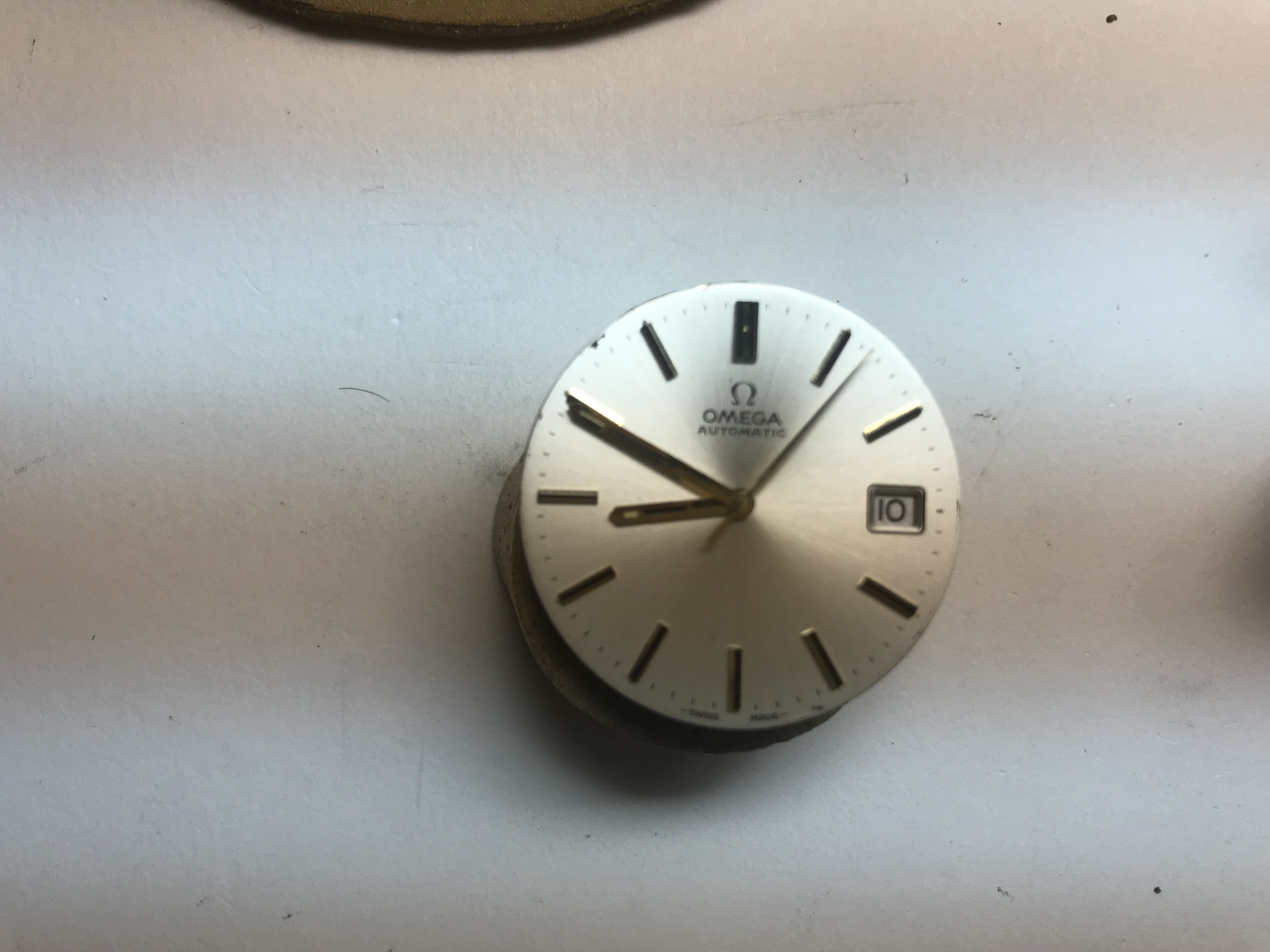

Its a 1010 or 1012 depending on number of Jewels.  Look at that circular depression on the train bridge--it should have the calibre number.
http://www.ranfft.de/cgi-bin/bidfun-db.cgi?10&ranfft&&2uswk&Omega_1010
J
35 minutes ago, rattandsonwatchmakers said:
would someone please help me identify this omega movement...i need to replace the stem and crown...i pulled the balance cock...still not movement numver....thanks...
