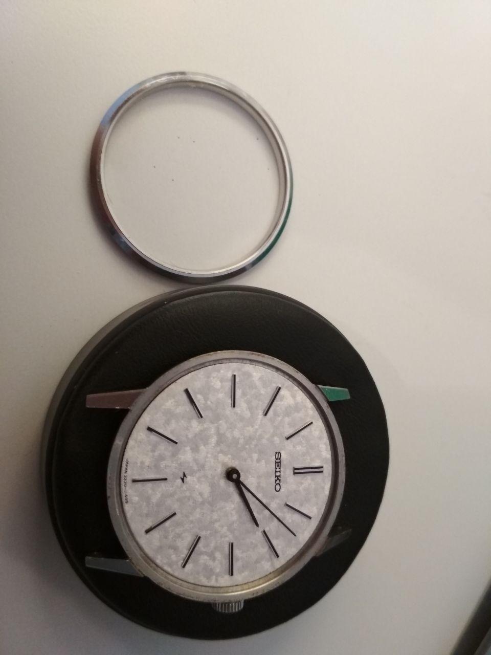

Hey Guys,
Couple of questions, I picked up this Seiko 2220-0430 with a chipped crystal. I was able with just a small amount of pressure to press the glass out from the back out of the bezel.
Am I correct in assuming that I need to use a crystal cement/epoxy to fit a new crystal?
Also, is a flat Cousins/Sternkreuz glass/sapphire crystal going to have a similar bevel to the one shown on the front face of the crystal?
Thanks in advance!

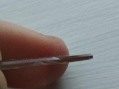

The crystal is approx 1.3mm in depth, the bezel has about a 0.6mm recess and the crystal apprears to just fit into this slot with the rest of the crystal protruding and showing the bevel. Would there be sufficient room in this 0.6mm to fit a gasket too?
The wall of the recess seems to be dead straight too, would I be right in thinking if it was an acrylic crystal the recess would be shaped to retain the crystal once fitted?

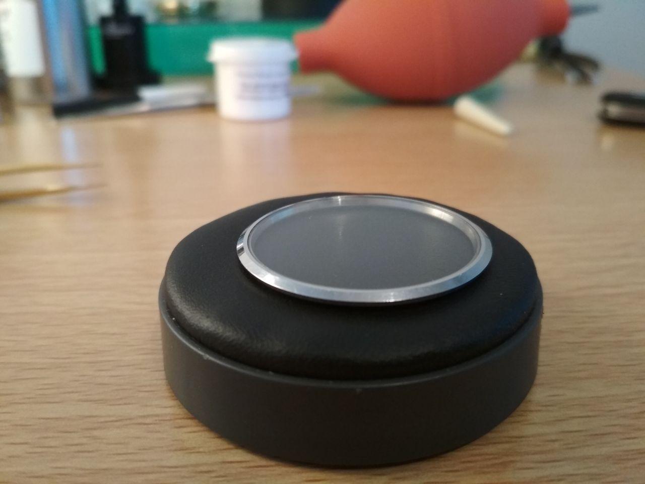

Just as a conclusion, the original Seiko crystal is of 31.0mm diameter. So I think it's safe to assume the crytal is epoxied directly into the bezel. A 0.70mm Sternkreuz MST crystal of 31.0mm diameter was a perfect fit, secured with some nasty Bisphenol-A Seiko epoxy.
