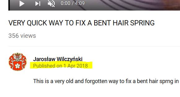

   there are videos AND  books that show "this art".   vin
