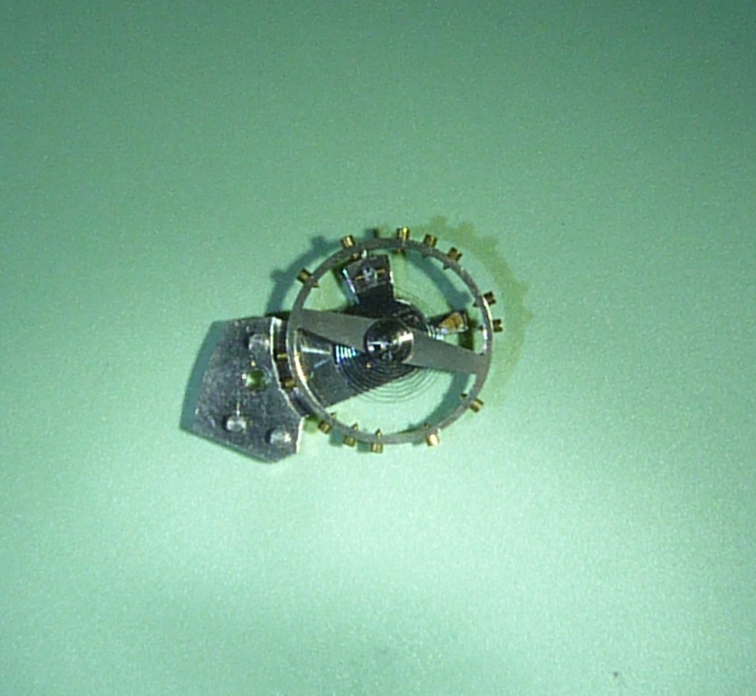

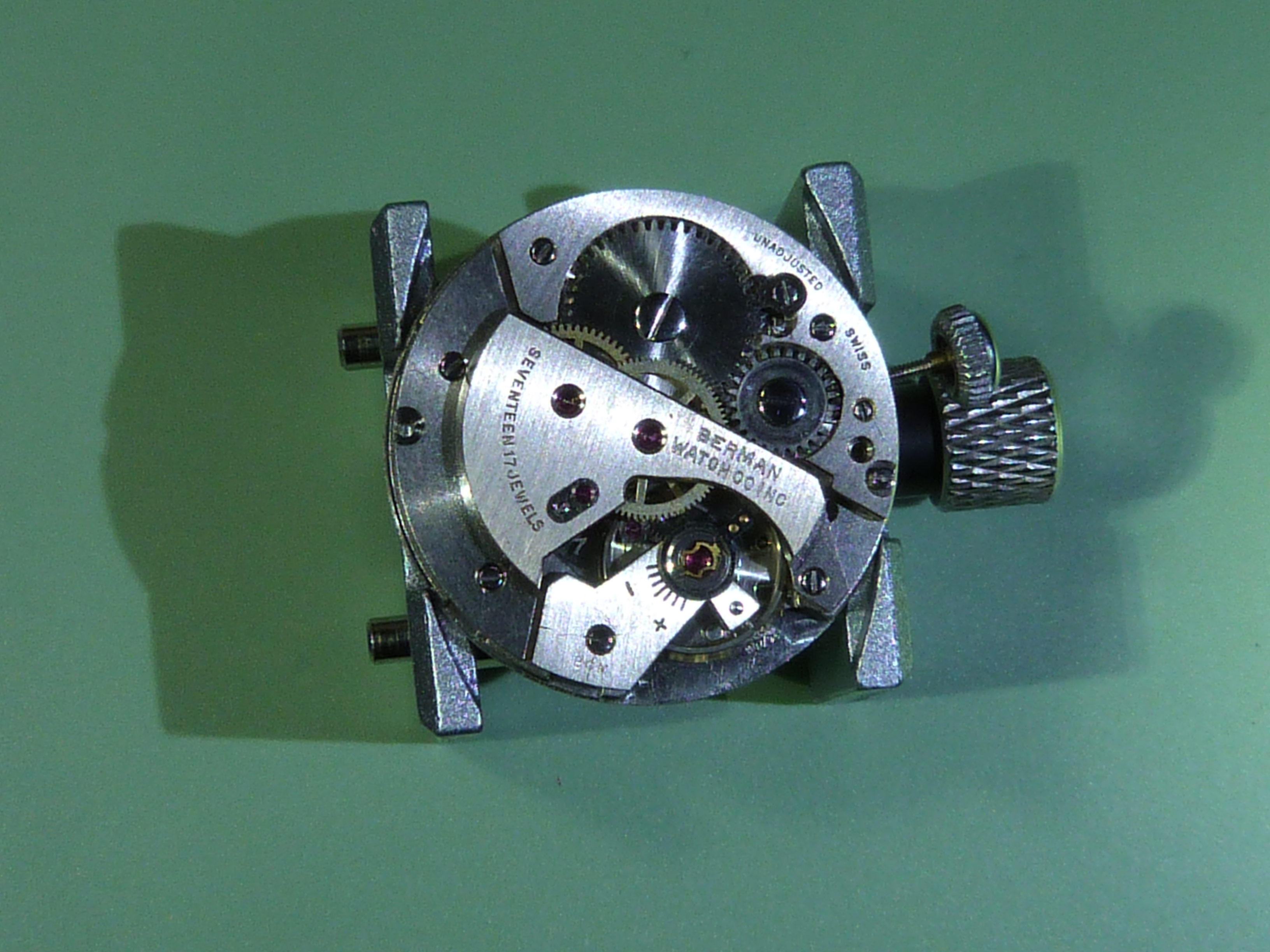

I removed the balance cock assembly but did not disassemble it. The roller jewel looked fine but I'll try to get a picture of it. The attached photo is about as close as I can get before it starts blurring.

I removed the assembly and confirmed that the hairspring is between the two regulators. There were also no signs of rubbing or anything unusual that I could see. The readings are very erratic so it still may be the hairspring or related components. I'll try to get some photos.

That it be nice to have an entirely different picture that's closer and much much sharper. But even then your problem might not be there may only be in the watch. So maybe my imagination but the hairspring doesn't quite look centered in the picture? Almost looks like they hairspring could bump into the back side of the regulator pin and maybe the terminal curve isn't quite right but the picture just I'm guessing perhaps. So put it back in the watch because that's where the problems occurring. Look very very carefully and yes it's very hard to see hairsprings at times. Follow the hairspring from the stud to the regulator pins make sure the rest the coils are bumping into that when they open up they shouldn't be anywhere close. Then make sure the hairspring looks flat really isn't a lot a clearance if the things not flat it can touch the balance wheel arms.

Your hairspring is distorted, it should be a smooth curve from the stud to the regulator pins. It's also not centered due to the distortion, in this photo it's shifted towards the lower left, assuming the pivot is in the jewel.
Have a look at this video.
