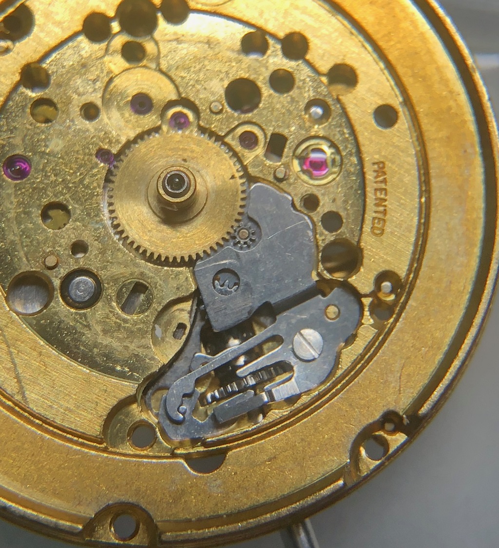

Ok so my questions. Here is the movement tech sheet I was using.

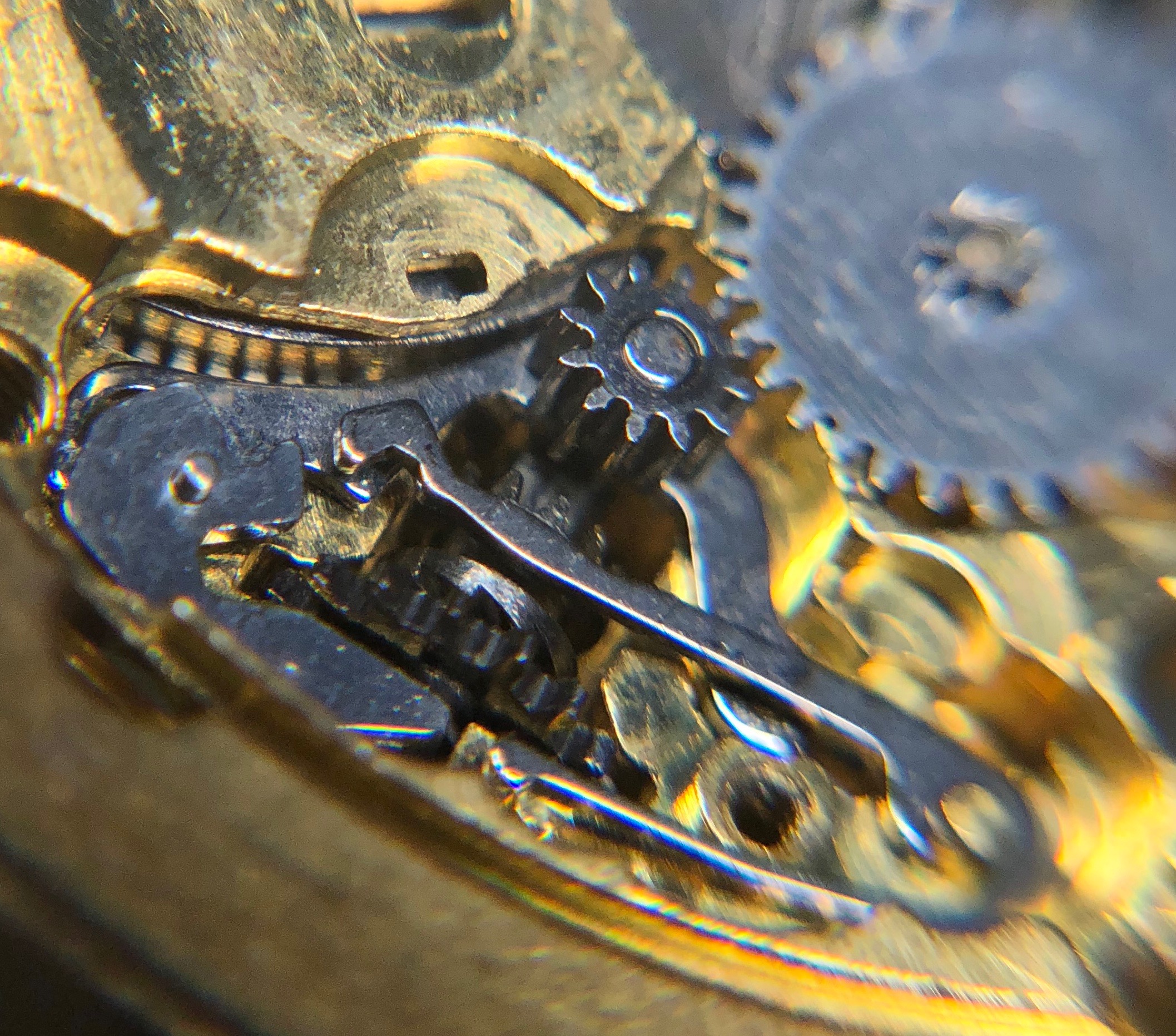

Crown set bridge. The crown locked in place but it wouldn't engage any gears. Any clue what went wrong? I'm assuming what they call the sliding pinion is in the wrong location or I'm missing tension on it? I just can't tell from the diagram what I did wrong. Photo as I assembled it:

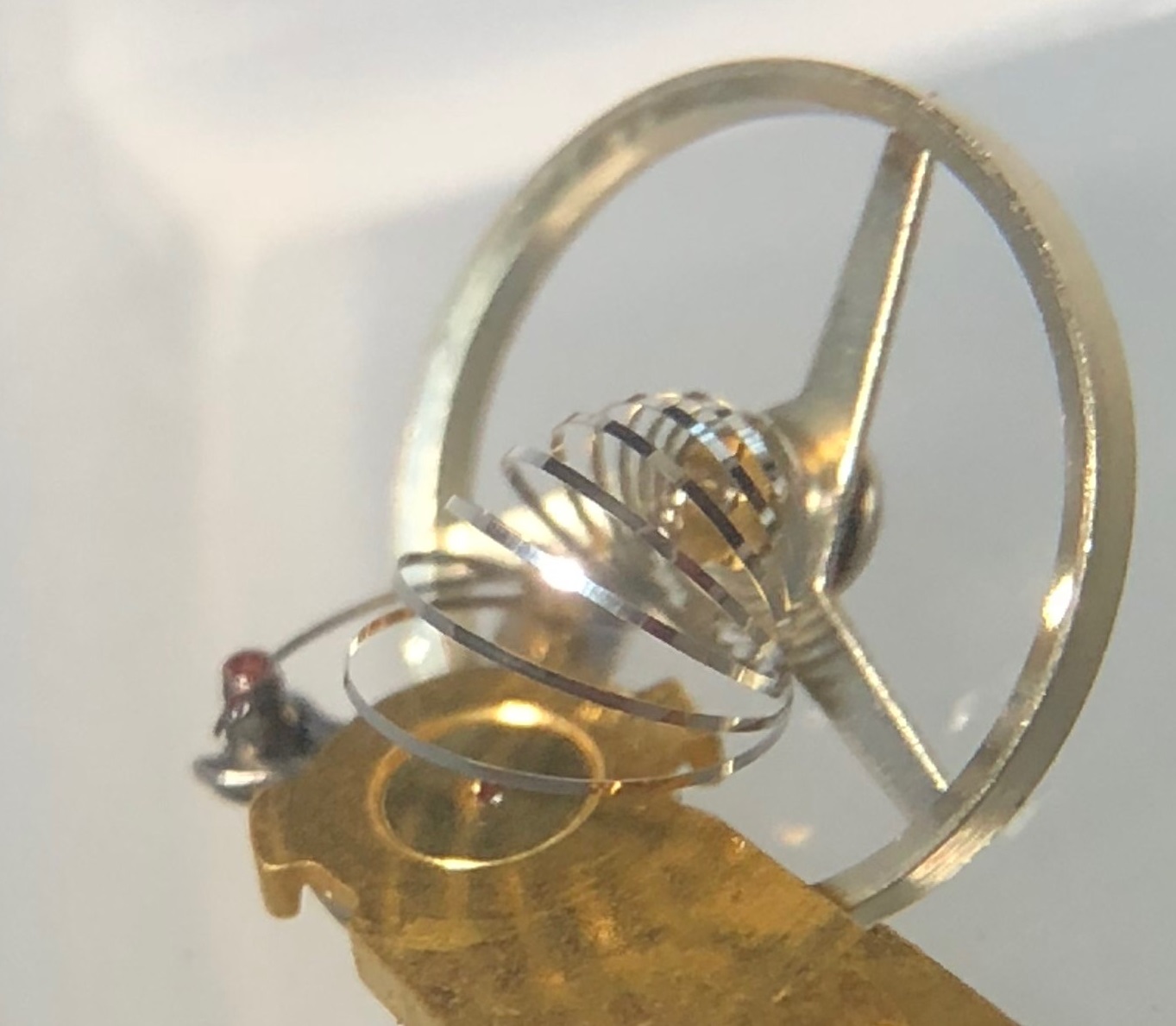

The balance wouldn't freely spin after assembly. My assumption here is the staff didn't make contact with the top and bottom pivots? Should I have taken off the regulator to seat that jewel correctly? Did I mess up the staff? Two photos:

re crown set bridge - the set lever should hold the winding pinion against the clutch wheel.. ie the two parts with the ramped teeth should be forced together when the set lever and its spring is installed.
A pic without the bridge would assist diagnosis.
Balance wheel. Can only see one pivot clearly.. the other should look the same. You would usually get the balance in place and the balance bridge in position before tightening everything down gradually while making sure the balance spins. Tightening the screw in one go will break the pinion if it is not safely in its hole. If the balance spins one way and not the other then the impulse jewel is not in the fork at the end off the pallet lever. If all is in place correctly but the balance is still sluggish then you may need to clean the balance jewels again.

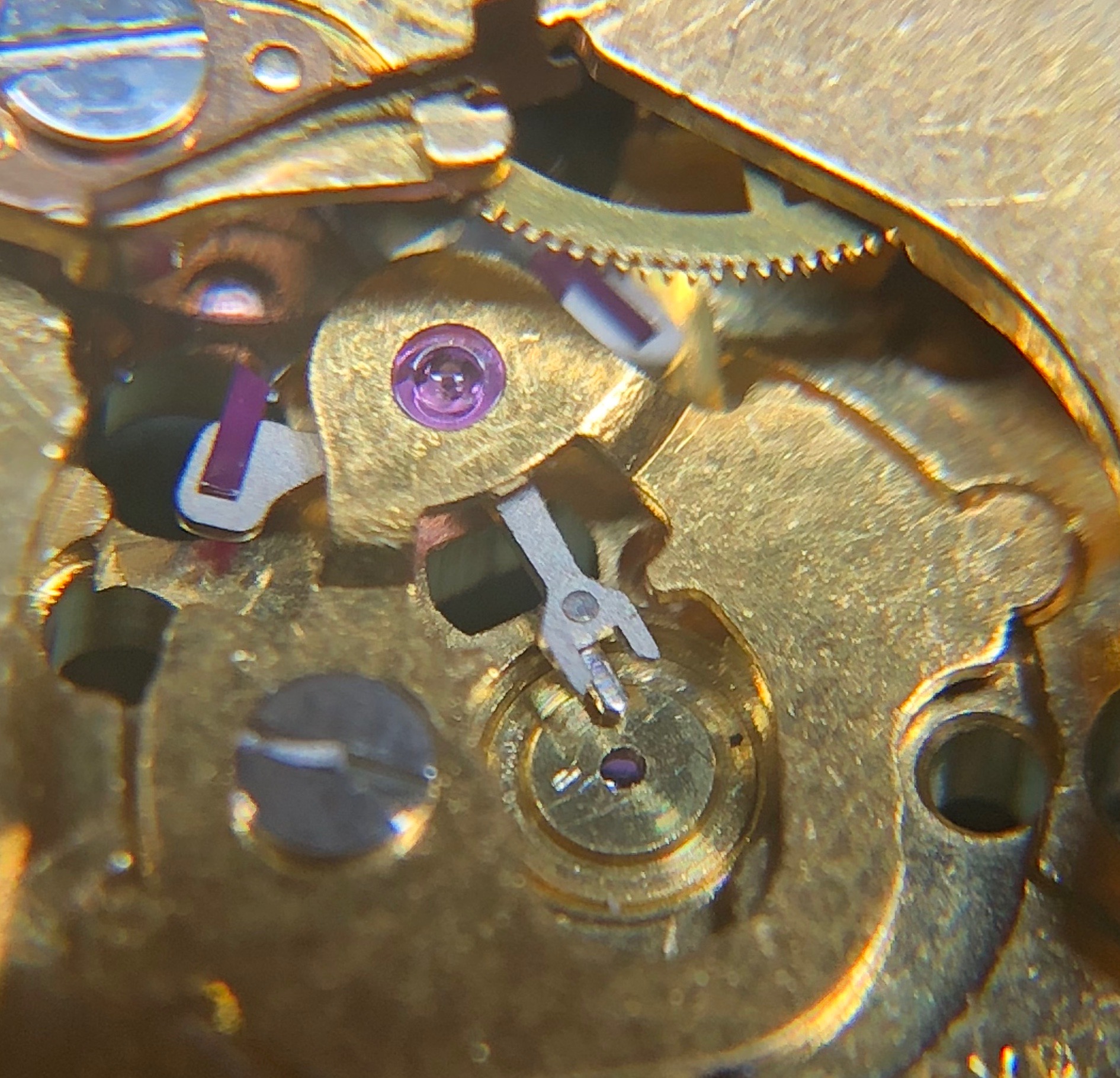

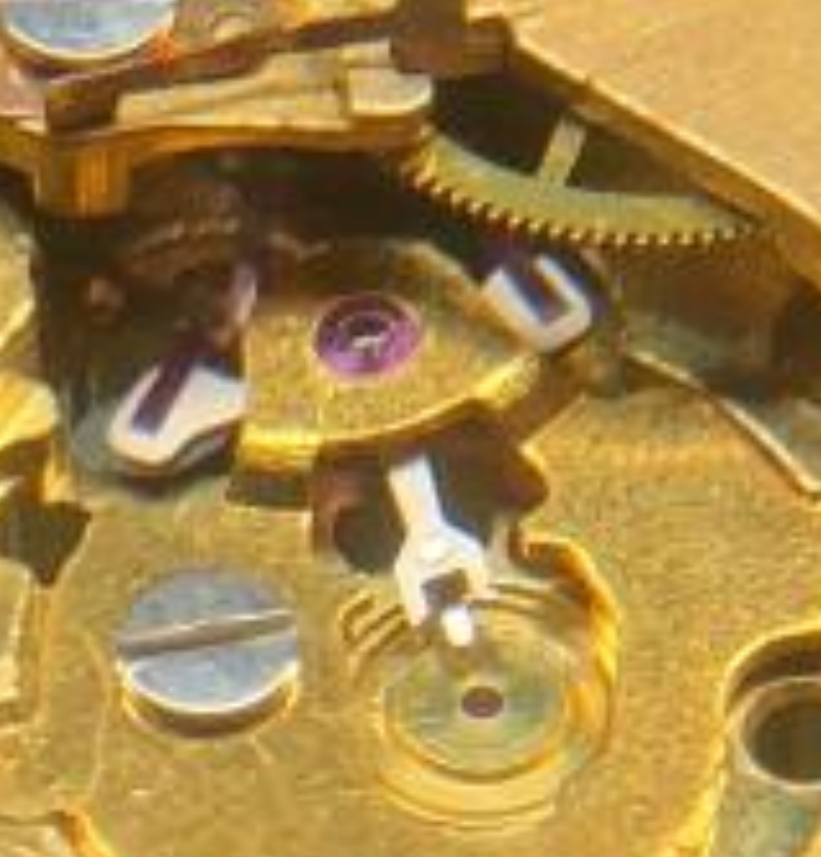

It looks like the pallet fork is not in the right place... It is not evenly lying / rather slanted. Is it moving freely from left to right and vice versa? (maybe it is just the angle of the photo).

The pallet fork moves with each rotation of the escape wheel. With photo can not judge if it is evenly lying or not. However you can check yourself by gently notch the fork from both directions. If it moves with escape wheel it seems to be okay. Remind that you should check the pivot of the pallet fork before tightening the screws.

For sure the pallet can't stay in the middle like that. Definitely something is wrong with that escapement.
Thanks everyone for the advice!
I think I had the pallet installed incorrectly, I was able to wind it up slightly and make the escapement tick after this try. As far as I can see in my loupe the pallet isn't damaged. For the balance, it has a tooth looking jewel, impulse jewel? where should I put this during installation? In the fork? Should the spring have any tension?

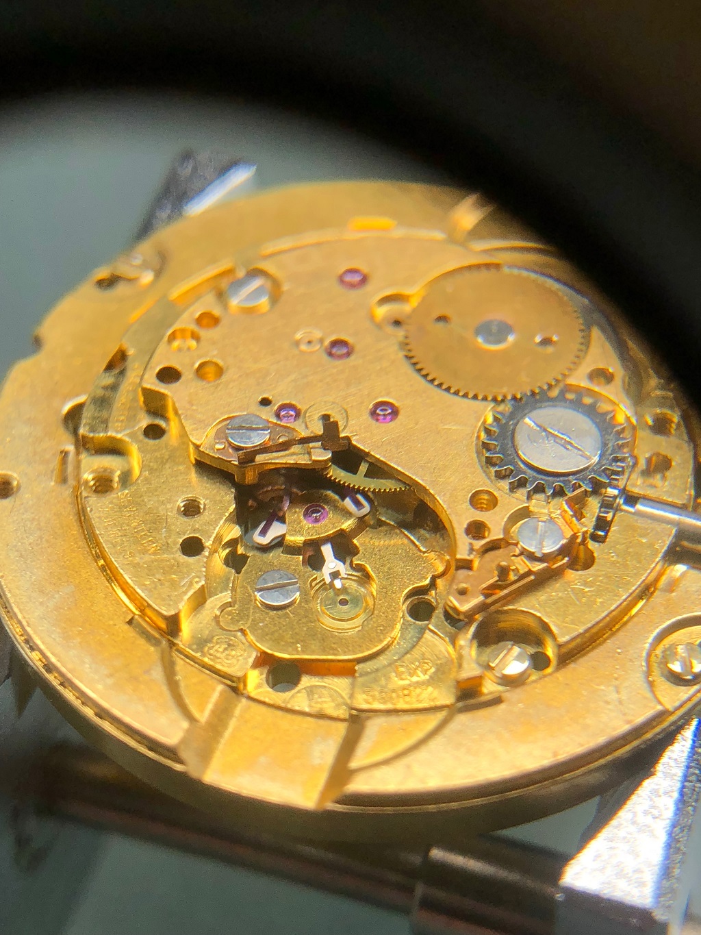

Now on to the crown. Here is a pic with the set bridge removed. What is wrong with this picture? I feel like the spring isn't in the right place. Actually I think maybe the sliding pinion is backwards?
These pics are all through a 10X loupe and my iphone, this works amazingly well.

The roller jewel on the escape wheel should rest between the banking pins ( no tension). This can be checked with the pallet fork removed and the balance cock reinstalled. And looking between the banking pins make sure the roller jewel on the balance wheel roller table is perfectly between those pins.
