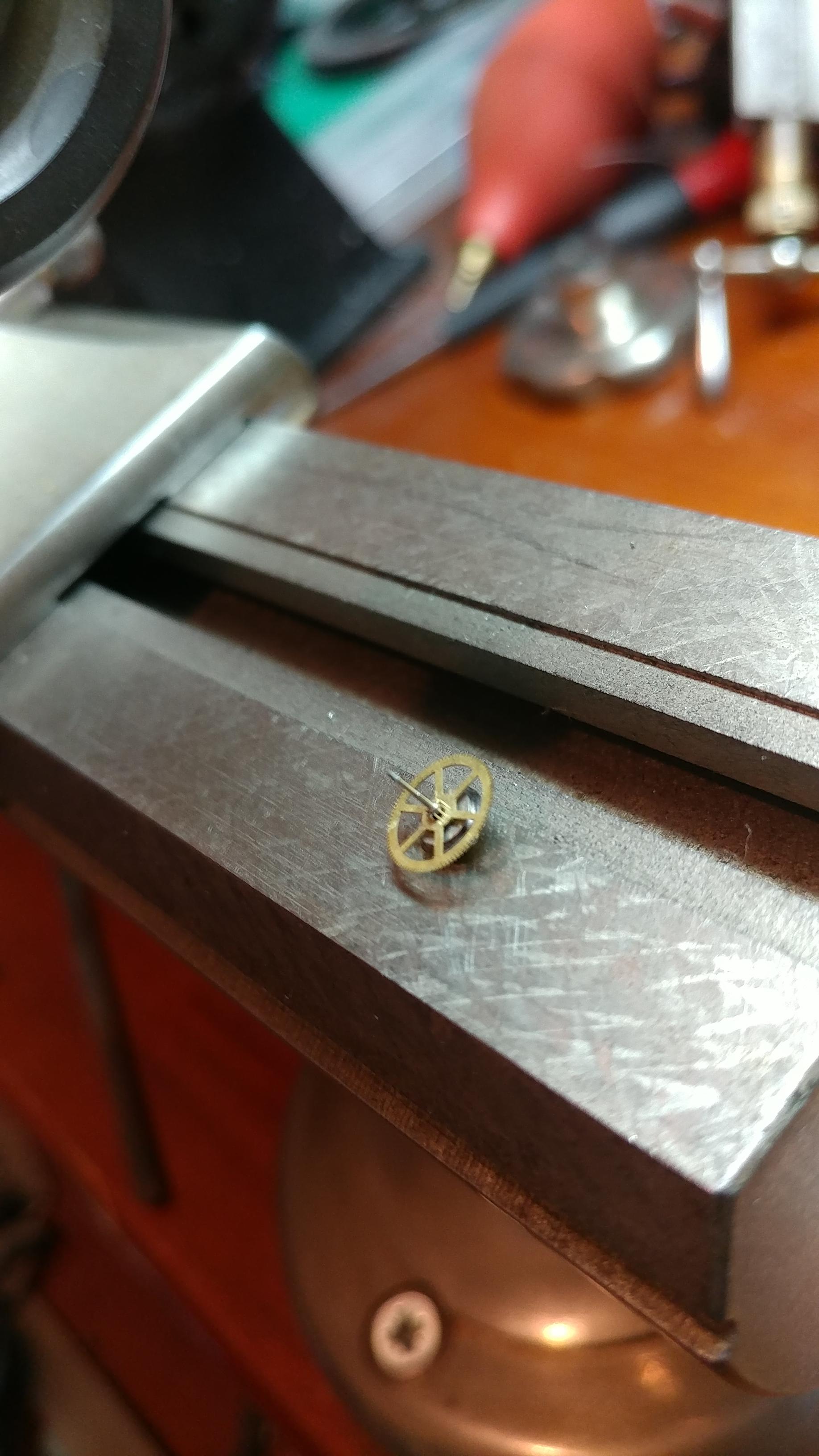

Never seen that done? It's a pretty small pivot. Which side is broken? Is it where the chronograph hand is?
Yes, it's where the hand fits. Ill attach a picture. Is it better to cut it down to the pinion and then drill it and turn a pivot and friction fit it?

Drilling and replacing the pivot should be the preferred method IMHO if parts are rare. Rather than changing the whole wheel, this will save scarce resources. Chronograph runners are the first parts that get unavailable, guess why?
For skilled and well equipped workers this repair is fast and not very difficult to do. Last year I got a WW2 chronograph in my workshop for repair. Both chronograph runner and minute register wheel had their pivots broken and sapphire jewels cracked.
Tools used: Lathe, center drill 0.20mm, drill 0.25mm (both tungsten), Pivofix or Jacot tool:
Frank
I would not do this on the hands side. Removing the hand, you will pull the new pivot out of the staff. But a staff can be turned, it is similar to turning a balance staff, but the long thin pivot will be tricky.
Would it help turning with a  bigger diameter where fitted on the existing shaft, so more friction there.

Hi, thanks for the walkthrough, the problem is I dont know how to hold the wheel, I dont want to break those springs.
Usually there is a brass bushing in the.center bore where the long pivot must pass. A thicker plug will prevent this.
