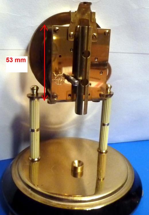

If you can give me the make of the clock I can give you the exact spring you need. A pic of the back plate and its dimensions will help with the Id. The thickness of the spring is critical with anniversary clocks.
It's a Kern (K+S) miniature, and the old spring  (no longer available to measure) was 7,5-8cm Long.  Vertical side length of longer side of base plate is 53mm.
I was unsuccessful in photographing, due to strong mirror effect.
Without a pic of the plate it is difficult to be sure. In my 400 day book it has some Kern & Link movements and some Kern & Sohne movements but none of these equates to the measurements you have supplied. I found a web site that has some Kern miniature movements and suggested suspension spring sizes. Here is the pdf from it.

Here`s a pici, for what it`s worth. Thanks for your trouble
Bob

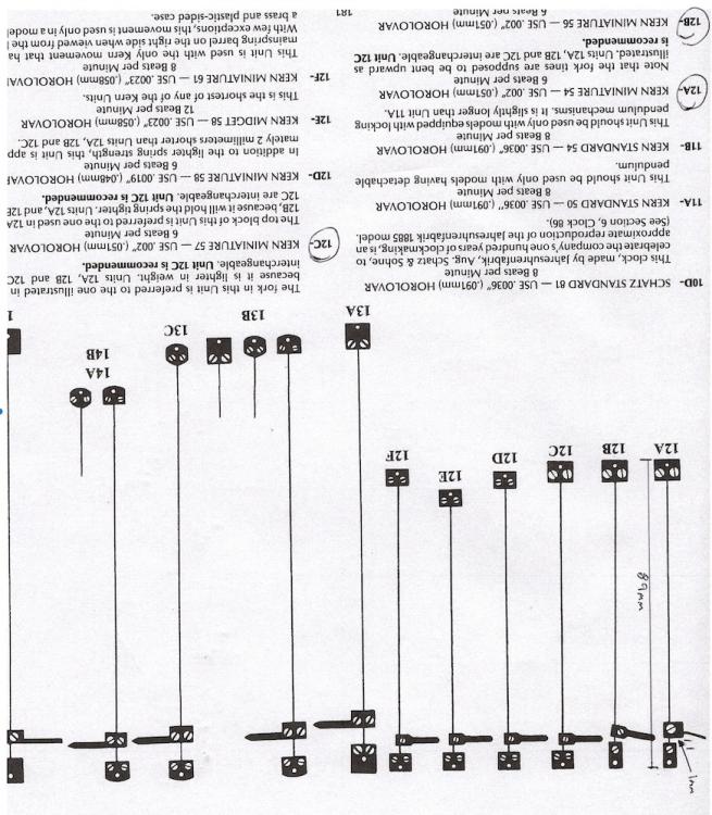

In my 400 day book it has a Kern & Sohne Miniature which matches your pic.  It was produced in 1958. If this is the correct calibre the spring that should be used is as follows:
.002" (.051mm) HOLOLOVAR
The length of the spring & the position of the folk are critical. I use the 400 day book template drawing to get these correct. I could take some measurements from these if you have not got this book.
Bob please find attached the measurements you require for the fitting of the suspension spring >Also note if you clock is the Kern Miniature 58 then a weaker & shorter spring is required. you can use the drawing to to compare wether you clock is the 54,56,57 or the 58.

Thanks all of you.  In the mean time I found that I actaully had the 2 books - the  Repair Guide of Terwilliger, as well as the Repair and Restore your 400-Day Clock of Joseph Rabushka.  Just moved house, and I lost sight of them in the ensuing chaos, but have just found both.  It would seem to be the Kern Midget clock (plate 53x43mm) shown in Terwilliger as 12E with a spring of strength 0,051mm.  In this second-Hand book, someone has corrected this in pencil to  0,056mm.  Will try both.  Although only slightly thicker (10%), I read somewhere that a 10% Change in thickness, results in in a Change in rate of 30%.
