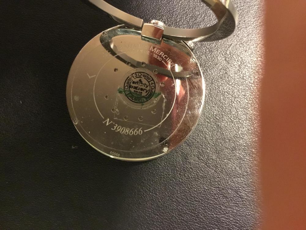

Hello,hope someone will be able to help me,I have questions concerning Baume & Mercier alarm clock,movement ETA#804191,clock is running after movement replacement,but alarm is not working.Is there something specific about alarm,I checked technical info,it's not helpful.anybdy worked with this movement before?
I would greatly appreciate any help I can get.
Attached are pictures of the clock inside and outside.
Thank you in advance,
Vitaly Maze/ watch24AA098B-CED0-45F4-B009-89D1A3270AC8.thumb.jpeg.9cd277c97479dd059c0781911c4ed3de.jpegmaker
Make sure the movement tabs has good contact with the piezo in the caseback. You  maybe need to bend it out a little. How did you mount the hands if you didn't now the alarm hand was in the right position?
