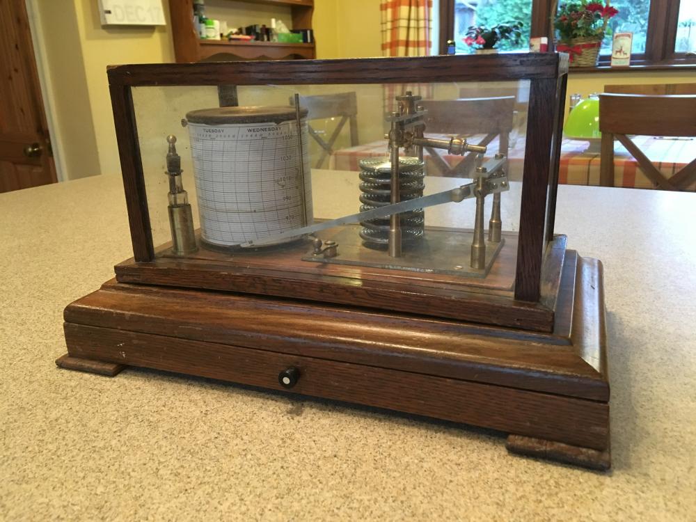

Santa brought me one of these as another project (because I completed so many of the ones I planned to do last year... honest...). Has anyone here ever worked on the bellows from these? At least one of the capsules in this set needs to be re-vacuumed. It looks like it’s been resoldered but has air in it and makes the stack too high, also it won’t respond correctly to pressure changes like this, but I’m not expecting a perfect calibration here!

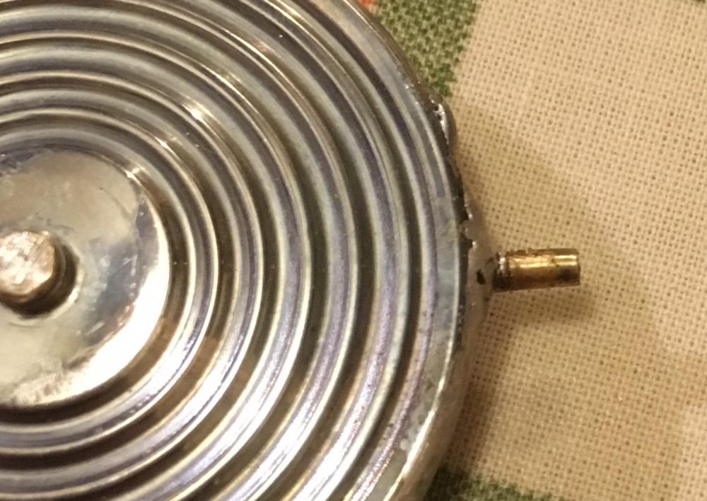

I’m thinking that I could make up a small brass tube, insert it into the solder joint, suck the air out then crimp it closed before sealing with a blob of solder. It looks like this is how the rest are formed.
What I don’t know is how much of a vacuum I need to achieve.  Will it be enough to remove as much as I can with a large syringe or am I going to need to acquire a better vacuum pump? It feels as though if these were really pumped out then the plates would collapse? Thoughts welcome, shared wisdom, knowledge or experience very welcome!
Have you tested the barograph to see if its working at all? in your photos the recording arm is set far too low have you tried adjusting it with the large brass knob above the stack to bring the arm up onto the chart. Simple way to see if the aneriod capsules are working is to put the barograph in a large clear plastic bag leaving air in the bag seal at the top and squeeze the bag if the stack is working the arm will move as you squeeze and increase the pressure and fall again when you release.
Aneriod capsule stacks can still be bought but you would be hard pressed to get a stack of 7 but stacks of 6 or 8 can be bought but are expensive.

OH - good news is that the clock movement is running, despite the seller saying it wasn’t. It’s  pretty hidden inside the drum and all I can see is the platform through a regulating hole. Amplitude is pretty low, but it’s a lever escapement so should just need a good clean and service.
WLS - I haven’t tested all of the capsules, but to get the right range of movement I assume they all have to work. I have established that the lowest one is sealed but filled with air and therefore too high and will not compress properly under external pressure. There isn’t enough adjustment on the brass knob to get the pen onto the chart. I could adjust the arm on its pivot pin but I assume the first lever arm  (connected to the bellows) should be more or less horizontal in the middle of the pressure range. I have seen new capsule stacks for sale but they seem to cost about what I paid for this project... and the fun is in the learning, not just getting a working item :unsure:

Time for an update on this... which appeared to have suffered a few challenges over the years.
1. Bellows
Some research led me to discover that I needed about 1”Hg vacuum inside the leaky capsule.  We still make some old bellows at work and have equipment which might have done this job... a vacuum bell jar with an inductive heating coil inside.  Sadly I only had one part to practice on and I didn’t want to ruin it... nor break the equipment!
So I found the original hole and made a new short piece of brass pipe and soldered it into the capsule in the same way as the others
and made a vacuum pump from a syringe and bicycle tyre valves. This all worked well and whilst I couldn’t measure the vacuum, the capsule contracted down to the same height as the others with the best vacuum I could get.  All was good until I tried to crimp the brass tube so I could cut it off and solder closed.  I had hoped that it wouldn’t leak in this process, but sadly I was wrong.
If I’d had plenty of brass tube then I could have had a few more attempts, but I’d had to make what I had from a brass bolt and didn’t fancy turning loads of them, even if I’d had any more suitable bolts.
In the end I decided to do a temporary fix until I had more time to play, so I held the capsule compressed in a vice and soldered it shut. When released from the vice it retained about 50% of the compression. So it now has a little more air than it should do inside which will make it slightly temperature sensitive, but probably no other effects.
The end piece of the bellows which connects to the lever arms was a home made replacement (possibly the bellows has been taken from another barograph), and the link pin hole was in the wrong place. I modified that today after the pictures below were taken.
2. Case
I had to strip all this apart as it was warped and the joints were loose, plus the drawer didn’t fit properly. I managed to retain most of the original varnish then waxed with Liberon black bison paste
3. Lever mechanism
I stripped all this down and cleaned the brass and polished all the pivots. Cleaned the dried up ink out of the nib and the bottle. All the brass had a grained finish so I refinished in the same way, without making it look brand new.
I was going to use horological lacquer on the brass, but it didn’t seem to be finished that way in the first place so I opted for a coat of clockshine wax from Meadows and Passmore. I've never used that before so we’ll see how it goes. I can always strip it and lacquer later, but stripping off lacquer in the future would be a pain.
Bought new charts and ink from Barometer world and voila...
I still have to service the clock but since it is going I wanted to run it for a couple of weeks to see if it has any issues.
I’ve had it running for a few days and made some calibration adjustments (there are a couple of option holes on the linkage); all seems good now but really need some bigger swings in atmospheric pressure to be sure.
More to follow when I strip the clock down (one day)
