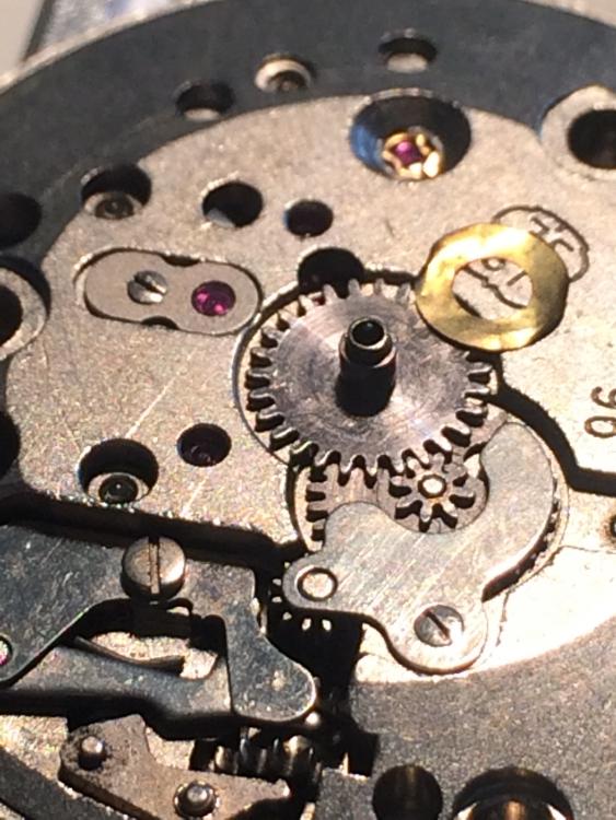

After reassembling my FFST 96 movement I have a thin spring washer over (or shim) I don't know where it go's...I can only guess it go's on the hour wheel
and watch face....see picture     IMG_3228.JPG   Thanks Bill..

Donald deCarle’s books are a pretty good start Practical watch repairing is pretty old, but is a contemporary of the watches many of us work on.
The dial washer you have there looks a bit mashed. It should be gently curled along one diametral axis and fitted this way up:  http://ticktickticktick.com/wp-content/uploads/2014/04/flieger-08-e1398649245424.jpg
