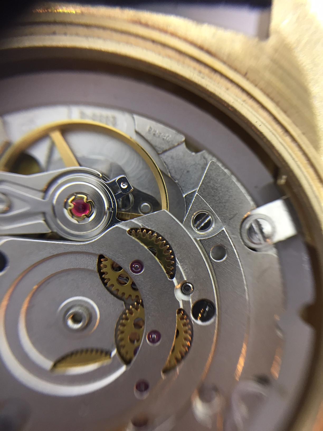

Check anywhere there might be a pivot being interfered with, (centre seconds is a common one if the second hand has been put on without supporting the jewel), that the train bridge is flat, and not being pressed on by the auto bridge, also where the auto transmission wheel post goes into the barrel bridge, there's an opportunity for pressure...
Another one that just came to mind, make sure the auto bridge isn't pressing on the regulator on the balance cock...

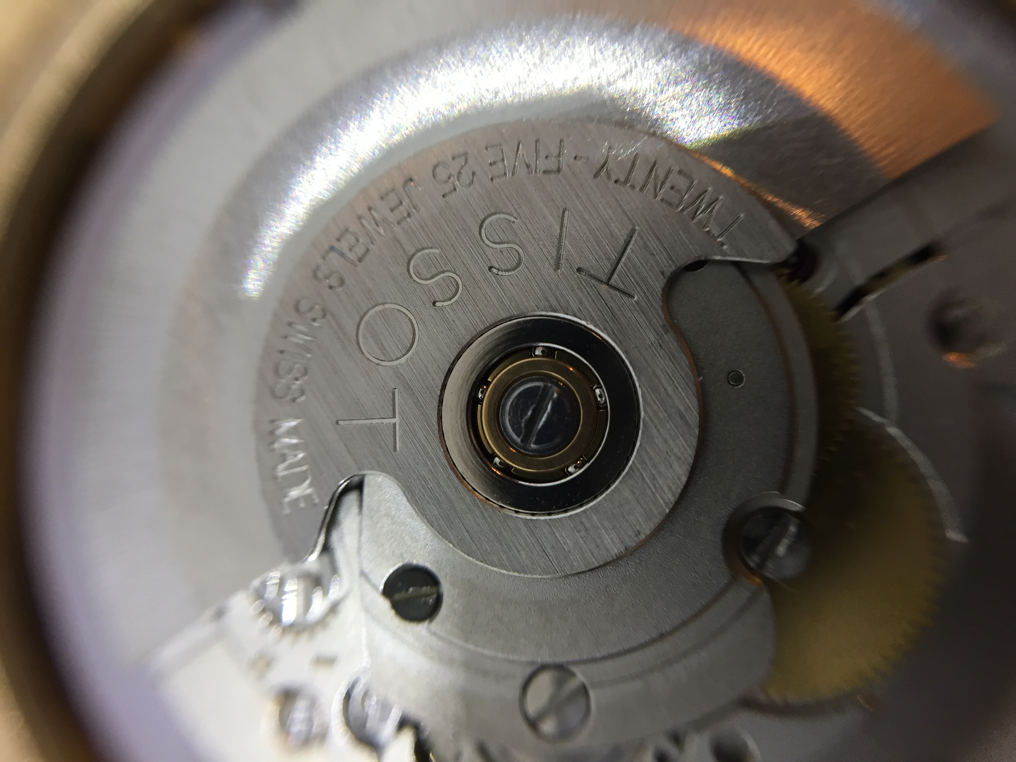

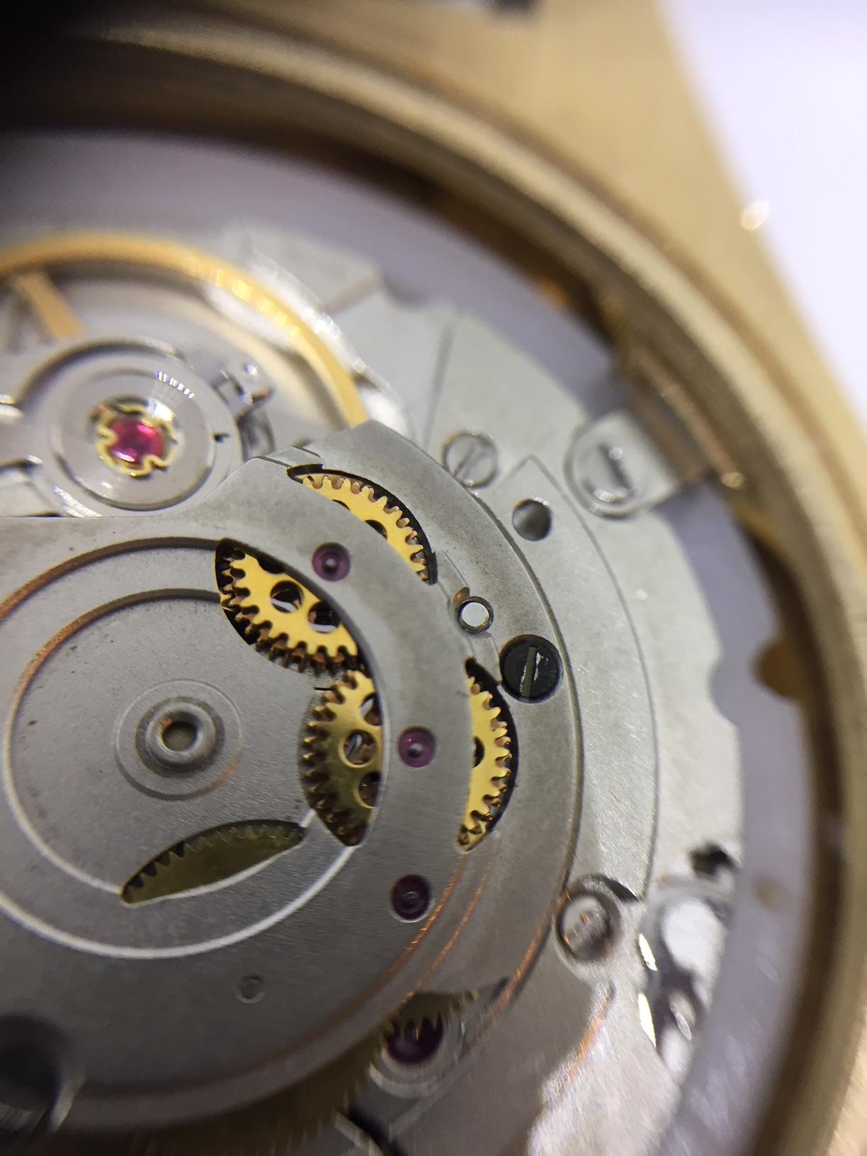

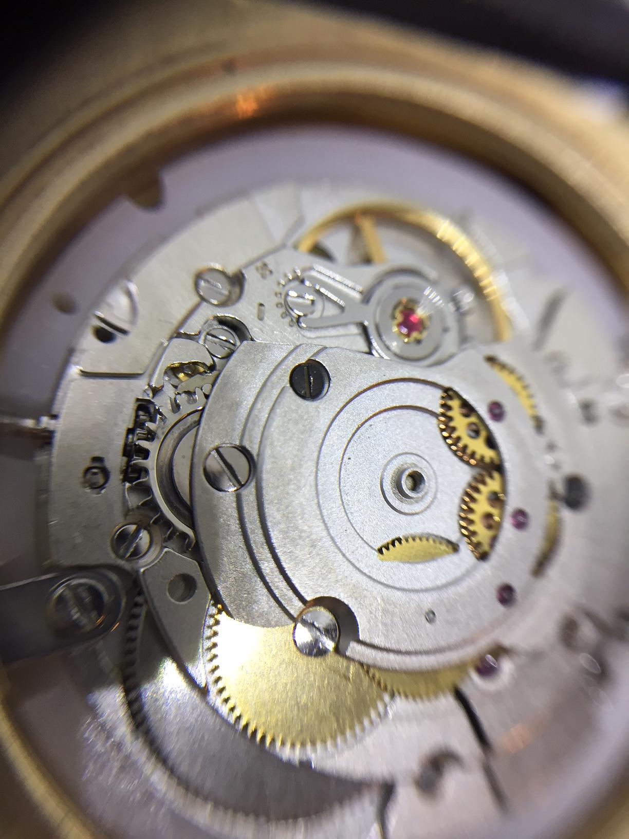

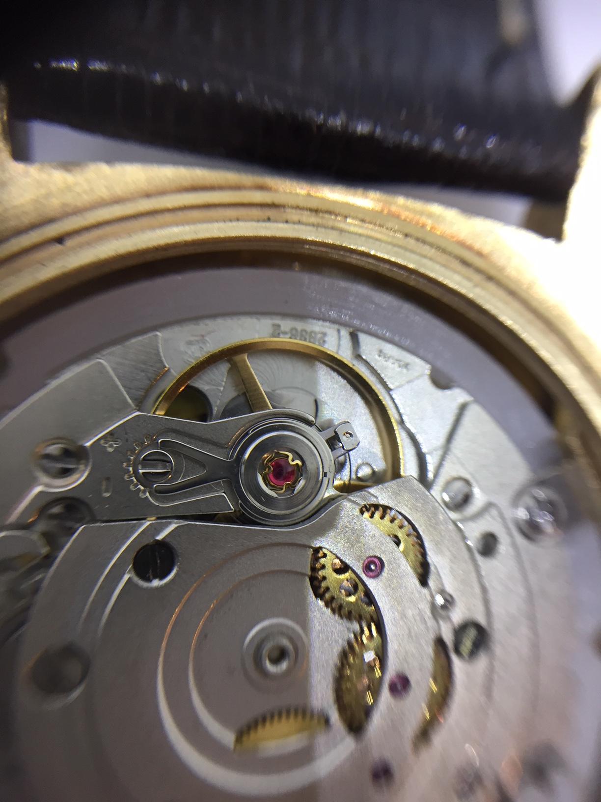

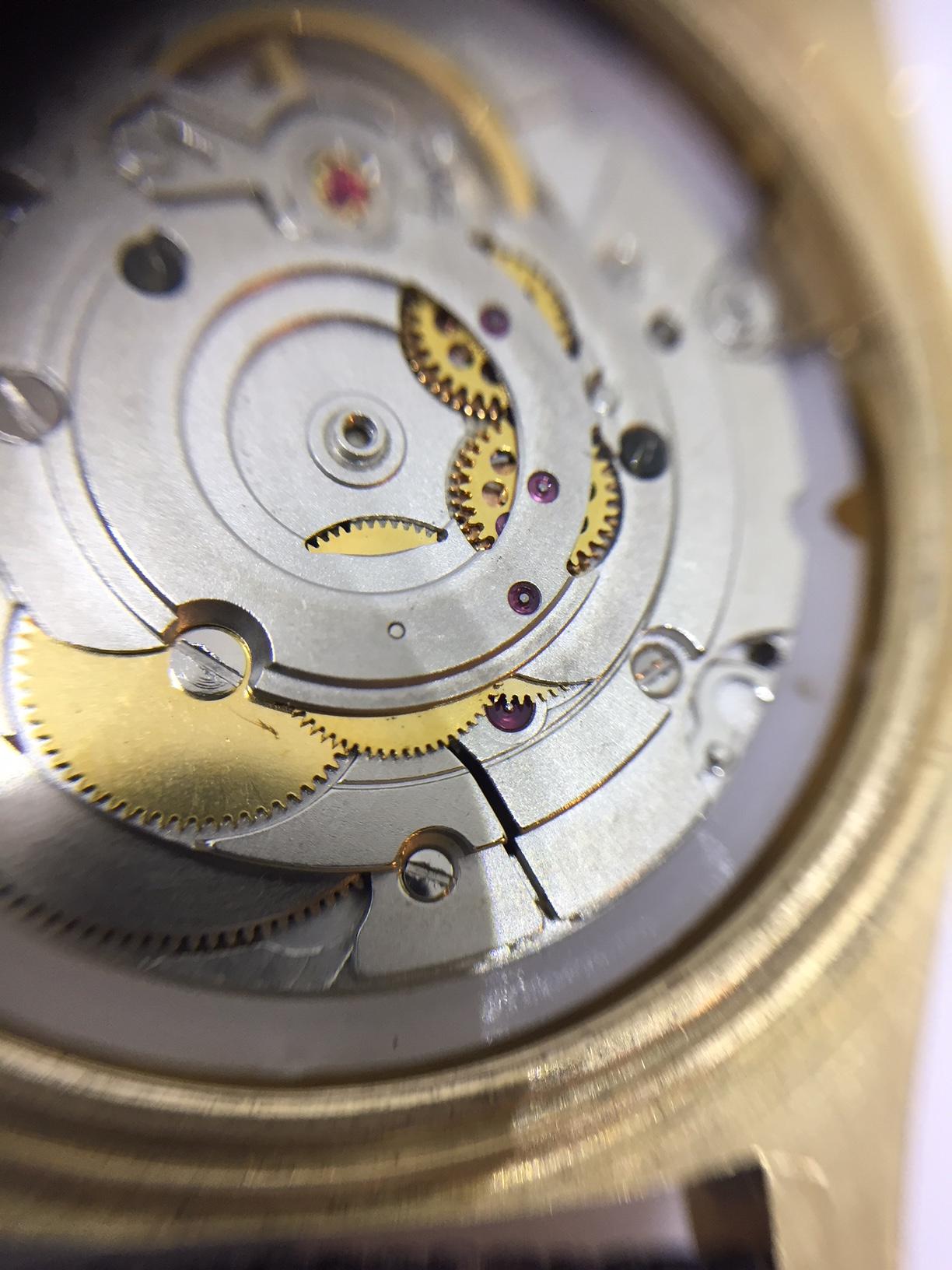

Thank you for all the great responses. Taking the advice of clockboy I’ve included 2 short videos so you all can see the movement, screws and how things are seated. In this condition shown in the video, the watch runs flawlessly.
As soon as the rotor is placed on it again it stops within 12 hours. I’ll post another video with the rotor attached. I’ve changed the whole auto assembly to a new one so I don’t think the issue is there. It must be something else. Could the mainspring barrel cause this?
