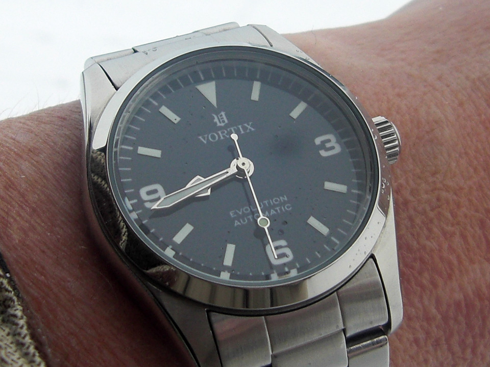

I've been wearing this almost every day since I finished it in mid-September.
The first picture is from yesterday evening, waiting for the guy next to me to taxi away so the fuel truck could safely approach.
The other two are from this morning. It snowed overnight, and was still snowing when I left for work.

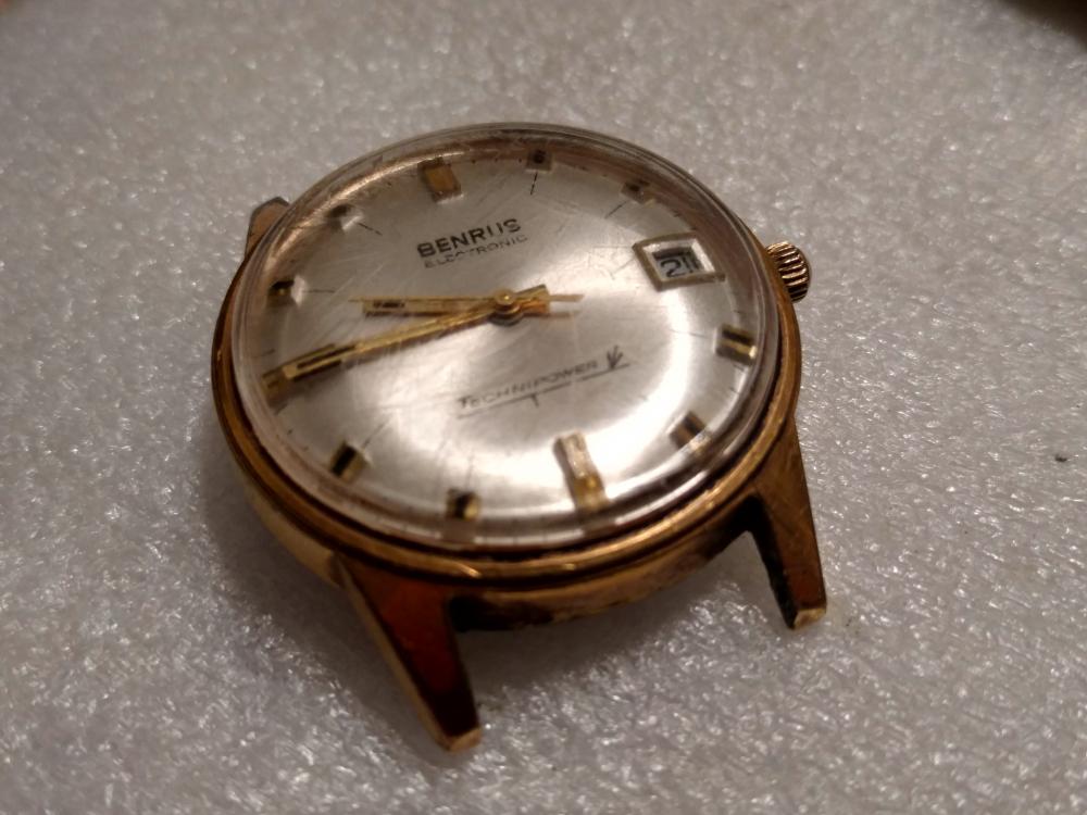

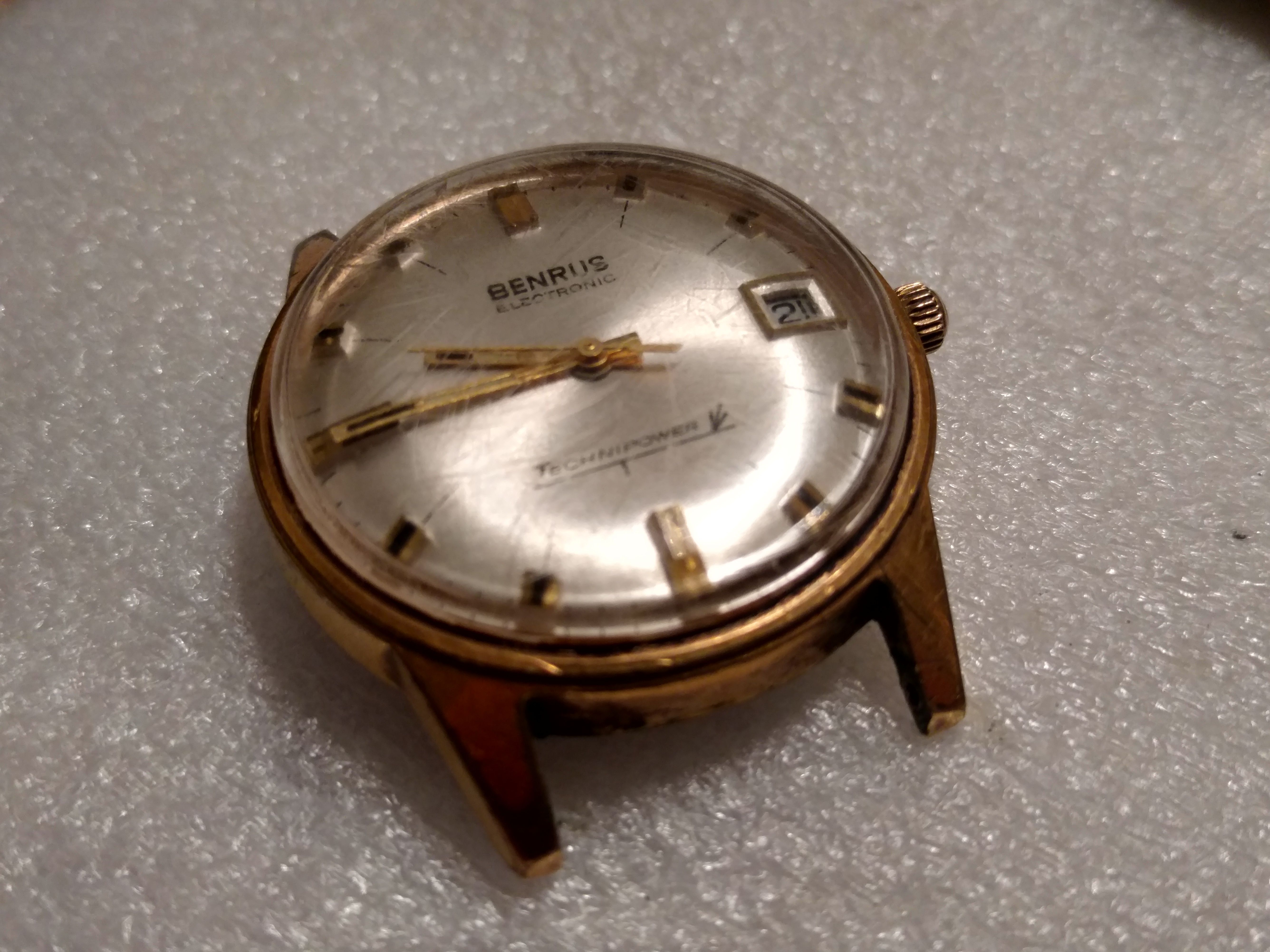

This little puppy arrived last night in pretty poor condition but I wanted to wear it today so I got working on it right away.  This one was a "gamble" because the seller said "not working, not a watch person, as-is".  Even though the description almost pushed me away, I saw a Benrus Electronic Technipower watch in the pile of junk watches.  When they arrived last night, all the quartz junk was actually that....broken junk.  However, the Benrus looked like crap too but I thought it might have a chance.  I put a battery in her and nothing.  I put another battery in and nothing.  I take the crystal out, split crown then movement and waddya know, DIRT!  I cleaned it up (not professionally, I don't know how to service electronic movements) put a new crystal in it and voila, a working watch that looks awesome!  Pics below:)

This looks like ESA 9154 is that correct? I've worked on several electronic ESA 9154 and 9157. They can be either finicky even when they are working correctly (suddenly they may stop working), or super strong runners with chronometer-like precision.  Not all of them are split stem either! Please see the image I've attached.

@noirrac1j This is not good to hear that it can just suddenly stop working....any telltale signs when it needs a service?  Now it is good to know that you have parts;)  Yes sir, ESA 9154!  Also, do these movements get oiled like your standard mechanical movement?  Thanks for that diagram...saved for future reference:)
@ramrod The dirt was all over this thing on the inside....I'm thinking someone left the back off for quite a long time because I have never seen so much of coating on all the parts.  It's a shame the way people treat them.  The crown is a split-stem and some are more difficult than others. (I still have limited knowledge of the PROPER way to remove them, haha)  However, I use a pair of tweezers and fit them between the case and crown and just keep wiggling them inward and the stem will come off. Sometimes it feels like I'm going to break it but haven't yet.  I know I know, one day I really will but so far so good!

Yes the movements can be robust and I've serviced mine using the conventional oils and/or grease for the keylessworks and jeweled settings. The main reason for it to stop working is a fried transistor/capacitor or a broken copper winding in the coil--be careful; with the board if you overhaul. If the movement works sporadically, or you need to shake it each time you re-set the time to get it going, the brake lever may not meeting that peg I talked about. When you pull the crown out, you will see that the hairspring stops right at  the end of its arc just before the impulse stroke. Whe you re-engage the crown the brake lever is release and the hairspring has a klittle" kick start" that gets its swing-arc started, and is then taken over by the induction coil and the magnet that is attached to underside of the hairspring. That is another area that needs to be cleaned very well and properly aligned. Oh one more thing... you cannot take the circuit board off until you remove the hairspring and vice versa( first replace board on, then hairspring).
P.S. Also, use a new battery!

Finicky little things I see....thanks so much for that!  I'm wearing it now so I figured why not, try the hack...lol, I must not have heard it last night but it makes a clunk when it stops and the way you just explained what it does makes complete sense.  My biggest concern would be not to damage that hairspring THEN the coil!  Was it fairly easy to reassemble?

Yes, the assembly is straightforward. Only replacing the the circuit board and getting the hairspring properly aligned are a little bit troublesome.
@noirrac1j That's what was concerning me the most, haha.  Will be extra careful when I give it an overhaul, thanks.  I hate to ask but are the Timex Electric's any better?  When I looked at them, they appear disposable even more so than their mechanical counterpart.  I have at least a dozen broken ones and about 5-6 that are working.
