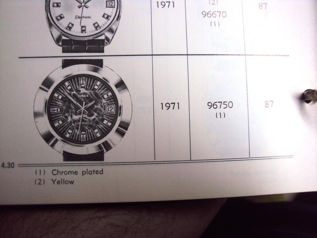

I see 78 stamped into the case back so that dates the quartz watch to June 1991.
Your "Electric"  has a model 84 where the "Electronic" has a model 87.
Both are same size linge so can be changed out.  The one you show is familiar to me but for some reason I think was not sold via the US catalog so will check my book latter tonight.  The difference between the Electric and Electronic was the introduction of a small regulator board for the current flow to the coil.
Share this post
Link to post
Ah I knew something was odd.  your watch is a franken.  Someone swapped the case out.
The dial is from 1968 and the case was not introduced until 1971.   I just put up a few electric parts watches under my ebay seller id ( pack43 )  One of them is the correct cushion case if your interested.  I think that was the only parts one I had left but I get stuff in all the time.  LMK if that would interest you and I'll make a note to keep an eye out for one.

Wow , you are fast...good eye . Yup , I swapped the movement to that case . It came from a non'-running backset . I think the hacking switch is dirty on the non-runner .
I think I'm watching the correct case and offering you have for my red electric... And hope I'm not violating any forum rules by showing it .
