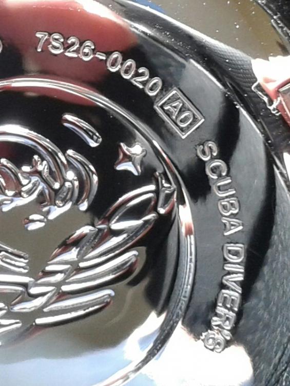

I'm modifying another Seiko and have obtained a replacement caseback from Dagaz to show off an improved replacement movement.
I would like to have lettering engraved/etched in a curve like on the original caseback (as shown) but to reflect the changes I have made.
Don't laugh, but I approached Timpsons, who use a Rotary diamond engraving set-up. To be fair, he said he could do it on a curve but it wouln't be anywhere near as precise as the outgoing caseback. I also approached a fine jeweller who makes jewellery and can do hand engraving, but his costs were too high in comparison to the watch.
I have a local engineering company who have experience of laser etching small cylindrical metal objects and he said he will look to see if it's possible for him to configure it to achieve a radiused set of lettering.
I know this is not strictly 'Watch repairs' but any other ideas gretly appreciated. N.b. this is just a £200 Seiko so cost is an issue and if it seems too difficult or costly I'll just leave it blank.

If you really want nice engraving on your back find somebody who does laser engraving. I've seen the results of laser engraving on the back of watch cases it's turned out very very nice. Produces very sharp detailed lettering unfortunately it's very expensive. The machine I'm thinking about cost roughly $100,000 and the starting price for anything basic is a little over $100. Unfortunately from your description is not in the budget. Otherwise diamond tipped engraving but it's not going to look as nice.

Thanks John.  Yes, I think it's this route or leave it sterile. I'm going to see what my friendly engineering guy can come up with. I just chuck him a few beers worth and he uses his works equipment in his own time.

If you now should engrave/etched it? It should say 6R15-0020  instead?
But as you have changed some many parts it's not original anymore?

Ha. Yes exactly.  I was hoping to get SEIKO 6R15-0020  DIVER'S 200M  and maybe 'sapphire ceramic or something like that.  I'm not concerned about the originality.  Until recently my seiko Skx007 was my go-to watch and perfect for my 6.5" wrist but I wanted something a little more refined.  It seems that Seiko aren't in too much of a hurry to update this line and I think the new turtles are nice but a different line altogether.

Here we go.
I'll say it first. The "Built, Not Bought" is a bit self indulgent 1980's Escort Mk3 boy racer....but then I was a teenager in the 1980's.
However, I think the radius/curve is just about spot on and Daryl, my engineer buddy did a great job working out the best way to do this.
Interesting & informative posts Tunokies. A couple of questions did you resolve how to get the backs etched/engraved & are the backs in your last post new or are they polished. If so what was your technic.
The one on the right is the outgoing new unused caseback, pictured next to my new one on the left from Dagaz and laser etched by my engineer buddy Daryl.
