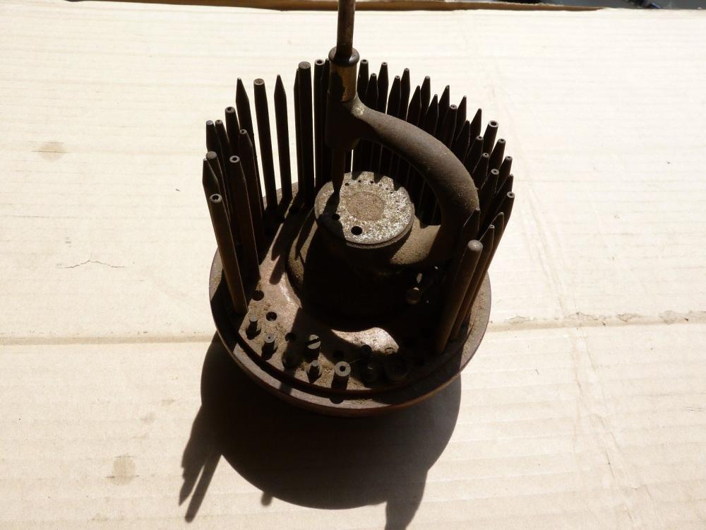

I ultrasonic cleaned them a few at a time to get rid of crud and dirt then put each one in a hand held drill and cleaned them with very fine grit wet and dry paper then each one with wire wool. The punch ends  which had a flat polished surface I left I only polished the shafts . Took me about a week to do the whole lot.
Just received my K&D staking set from EBAY its not to pretty now , but using the great ideas for everyone here, I have started to clean everything up.It is not missing any parts & I'm pleased.
The cleaning is going well however two of the holes in the die plate are plugged, with balance staff parts I would imagine. I bought a cheap set or tiny drill bits that instantly broke.
Any good suggestions on how to unclog these?
Again thank you all for the advice on buying and cleaning ,I wouldn't have got it correct without your help.
I took before pictures and will post them with the after pictures when done.

I started out using only abrasives to clean up the stakes as described here. Currently (today in fact!) I start with an overnight soak in EvapoRust to remove most of the rust and convert what's left to black iron oxide. Then I use fine 3M radial bristle disks to polish up the working and marked ends. I take great care with the working ends to insure that I do not round over corners, etc. Usually the highly polished working ends are the least rusted parts of the stakes.

Here is the after photo waiting for the dome

On 8/30/2016 at 11:53 AM, TimFitz said:
The plating and paint were both falling off so the rust cleaning removed the rest. Perhaps black enamel would be nice? what do you think?
I'm partial to the light green that some of the old Star and Boley sets are painted. But black enamel would look very nice too.
5 hours ago, TimFitz said:
Here is my finished $45.00 K&D staking set all cleaned up & the new glass dome arrived today. All finished.
Now back to watch repairing.
The only thing I'm missing is the centering punch, I have tried all the usual places recommended from all the websites. I will eventually I'll find one. If anyone knows where I can pick one up please let me know. Thanks
