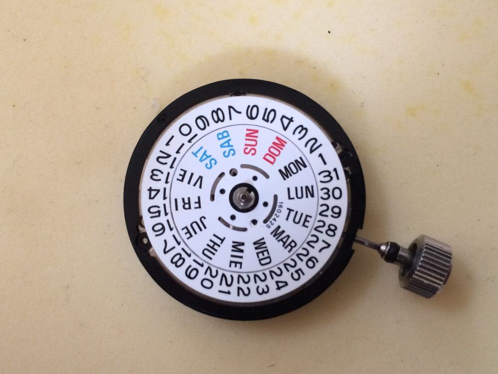

I have been working on a Seiko SKX007 watch for a while. The original SKX007 movement was fairly damaged. Seems like the balance wheel was not tight enough and whoever owned this watch in the past continued to use the watch. This cause the rest of the movement to get scratched and damaged. It is a 7S36 movement.
I bought an inexpensive used Seiko watch, with a 7S26 with the plan of replacing the damaged movement. The major difference between these two watches is the location of the crown. The SKX007 has the crown at 4:00 while the Seiko 5 has it at 3. This causes the day to be misaligned when I install the SKX007 dial.
 As you can see from the first picture, the date is aligned with the crown. But when the crown is placed at the 4:00 position, the date and day at 3:00 is misaligned.
I removed the date wheel on both of the movements. The black one is the original movement. The white is the one from the Seiko 5. The only thing I notice that is different between the movements is the position of the date driving wheel (black wheel on the upper left corner of the movement on the second picture).
Is this what is causing the date to be misaligned?
Same movement. You could take the black datedisc and daydisc from the 7S36 movement and transplant it to the 7S26 and hey presto you have a working movement with the date and day at the right place. That is the only difference. The other is that the 4 a clock watch has a dial where the dial feets are at a different place.
I think I’ve found the answer to my own question. I replaced the Seiko 5 date wheel with the date wheel from the SKX007 and now the day-date are aligned at the 3:00 position with the winding crown set at the 4:00 position. I am assuming the day-date wheels are assembled different for both models.

Yes, that's what I will do. I didn't expect the discs to be different. I hope to get this watch completed tonight. It has been sitting on my box for quite some time now.

The day disc is different depending on the crown position, and also between A and B to C versions.printed on them. See below document and compare with P/N printed on the disc.

I will be using the disc and dials from the SKX007. There is a very slight difference with the alignment of the Seiko 5 which makes the day to be misaligned when the crown is set at the 4:00 instead of the 3:00.

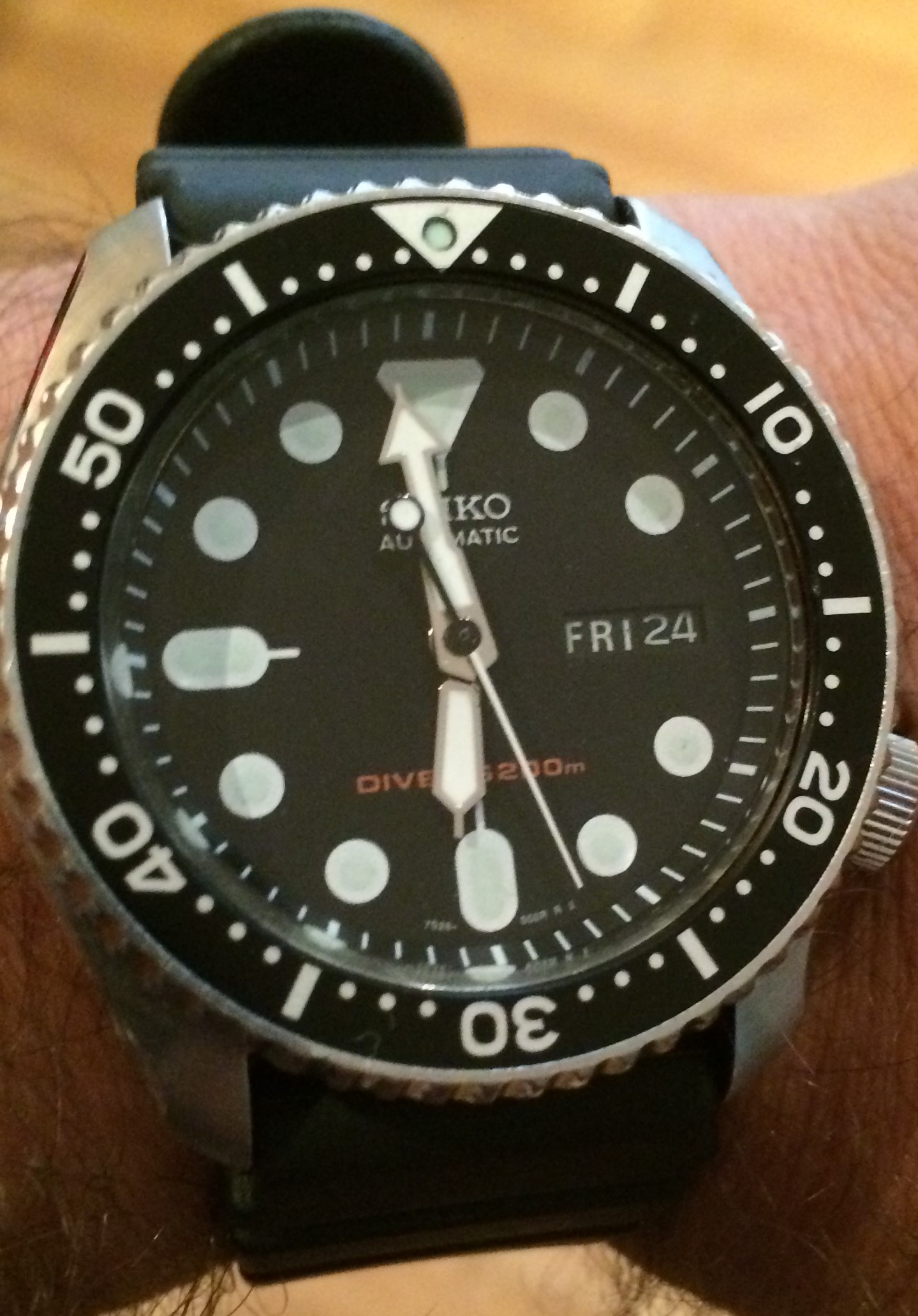

Nice work with the discs. But i don't really think you got the hands in the right position? It looks like it is in good condition? i Say keep it as is?
Edited by rogart63
You're right. The hour hand is slightly off. I will be resetting them today. It is in very good condition for such an old watch. I really like the look of the SKX007 dial and the black day-date sets it off nicely. I think it will stay this way for a while.

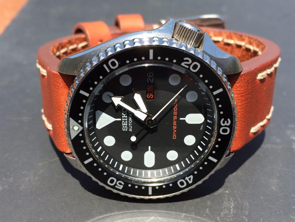

I finally got around to reset the hands to a more aligned position. The leather strap I ordered was delivered today, along with some Silicone grease. Since the watch was open, I greased the caseback gasket and the stem O-ring. I am really liking these thick leather straps.
