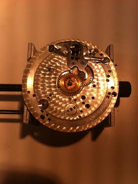

A friend of mine need some help. This watch has a broken balance staff. He has been to two different watchmakers and none could help him. So now he going to have a go at it himself. But we nor the watchmakers could tell the movement. They guess it was some kind of AS 137 ? And the other said an English movement?  Anyone recognize it? Sorry but this is all the pictures i have now. If we can remove the balance how should we measure the pivots if we haven't got any? Both broken :(

Interesting thanks clockboy and oldhippy. I will take a look at that. Have some more pictures. And my friend is measuring the movement right about now. So we can see what ligne it is?
It has a kind of strange looking keyless work. Perlage and a reed's adjustment on the balance bridge.

Asked David at vintagewatchstraps? But he never seen that movement before. And he looked through bestfit and smartchild books. But can't find any similar movements.
At that time many watchmaker companies bought the movements and made some modifications to it. Like mine Stowa above. They have different shaped bridges, keyless works or finish, but the critical parts are the same.
Try find the movement from the other end! Measure the broken staff exactly, find similar ones in the database and finally check the movements associated with the possible staffs.
Anyone have the Ronda CD. Where you can search on sizes? Thinking of  buying it from redrosteruk . But i don't have a cd player on my computer so should need it on a memorystick. Is it any good? Is it worth the trouble to fix it over to memory stick?

Thanks to all for your help . szbalogh and syfre . Did take the measures i had an looked on Cousinsuk ronda staffs. Found one that was as near as i could come. It was a Postala. Googled postala and hit the nail riight in the middle. Made my day:Dhttp://bdwf.net/forum/showthread.php?t=72531
