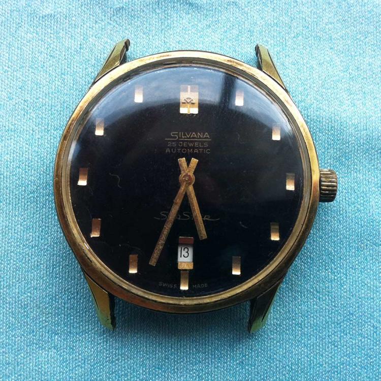

So I have a Silvana Sea Star from my father-in-law which works but has a broken seconds hand and a cracked glass. The watch has an ETA 2472 which looks very clean. I'd like to replace the broken seconds hand, have a clean of the outer case and replace the gasket. Ultimately I'd like to attempt a complete service - but feel the need to undergo a bit further practice and learning before I do that.
I'm struggling to find any information on the Silvana Sea Star and feel completely lost trying to select a seconds hand on the Cousins spare parts section; or the gasket & glass with no information. I'd like to replace the glass too but can't afford to buy an expensive press and I'm not aware of another method to remove and replace the glass.
Anyway, there's a picture of the Silvana attached. Any help or pointers to give me a head start or advice about taking some first steps.

For hands, info from this site might help some, it lists the hole sizes in the hands for the ETA 2472 movement.
http://www.ranfft.de/cgi-bin/bidfun-db.cgi?10&1ranfft&b&2uswk&ETA_2472
Then it's a matter of length and style, perhaps you can find a picture online that shows the original seconds hand.
A press need not be expensive, especially if that's an acrylic crystal. You will need something to measure with, such as a set of calipers, to get the dimensions of the existing crystal and gasket so you can order proper replacements.
