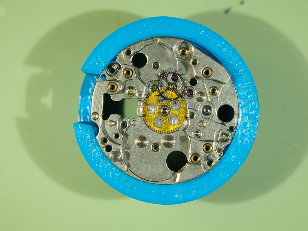

First thing to go back is the centre wheel and cannon pinion
Don’t get carried away and fit the centre wheel bridge yet, pop the escape wheel into place first because it won’t go in with the bridge in place.

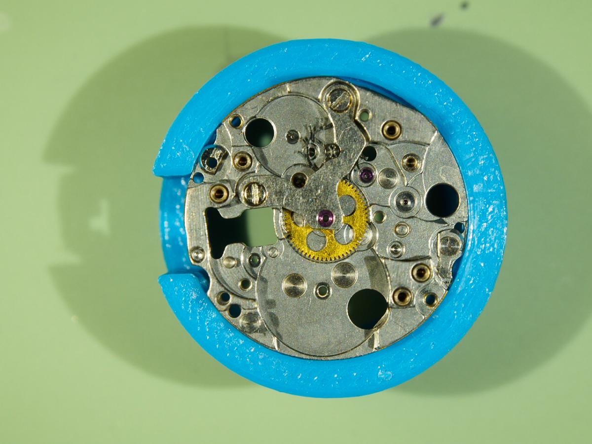

The next thing is to gently lower the train wheel bridge into place. I find it helps to fit a couple of the retaining screws just by a few threads or so, while you jiggle and cajole the pivots into place
I don’t fit this one just yet as the spring makes it quite tricky, and even more so if the bridge is not secure. So leave it until you have all the pivots located and the rest of the screws nipped up. It is prone to taking flight so take care with it. I have found a small piece of Rodico helps hold it in place while you line up the screw, and it stops it taking off.
It can be a bit tricky to get all the pivots in place. I have found a sewing needle helps to lightly nudge the wheels into position. Make very sure that everything is free before you nip the retaining screws and that the wheels spin freely. There is a bit of rust damage to the bridge which is a bit unsightly. If I had another one I would have swapped it.

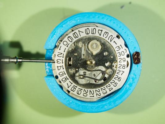

Gently lower the date ring into position and then it’s retaining plate.
It can be a bit fiddly to get everything lined up. Maybe have a bit of practice before you fit the date jumper and the tricky little spring.
When you do finally have the plate in position and the screws located don’t tighten them down just yet. If you look closely you will see that the date jumper is lying under the date wheel. Once you have the plate in place and the screws lightly holding it, you can ease the jumper out from underneath the ring and it will locate itself into the date ring.
Here it is in the correct position.
Now put the date indicator finger on and tighten it up.
Don’t forget the small washer that sits behind the dial. As I mentioned earlier, some have them some don’t. Not sure if they were lost or not necessary. I know that we don’t need to fit this just yet, it’s just a reminder before you replace the dial.
 Now is a good time to make sure  that everything works. Check that the watch winds, check the quickset and make sure the date wheel flicks around as you wind the watch through 24 hours and the date finger makes a complete revolution.
