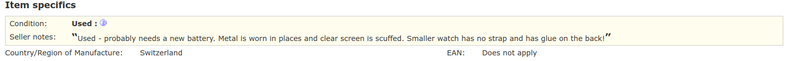

I am now a couple of quid the poorer, but the proud(?!) owner of this two for the price of one. Who can resist a 25 jewel automatic for less than the price of a sparkplug for the lawnmower.
Apparently it/they might need a battery.
I've got a few of those in the shed, maybe something like this might do the trick
The ladies watch is a "Delvina", and you might think that name would be easy to research but "Delvina"  only narrows it down to three possible origins. Time will tell. Who knows, when we take a peek inside we might get more clues.
I am a little worried by the implication that it/they might be "cogs parts steampunk" as there are no pictures of "the works", just external views, but there is no evidence of anybody doing anything too destructive  to them apart from abusing the Delvina with a little superglue.
On the plus side, if it turns out to be just a bunch of steampunk cogs, at least I'll still be able to cut the grass.
