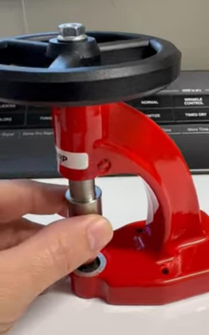

Looking at the video. That’s too much slap in the shaft, for that price I would send it back it’s way too sloppy.
That’s what I was thinking too. It is very disappointing though!

The movement on the shaft makes it look like a cheap Chinese tooltbh I wouldn't be impressed at all for the price. And like Richard said thats regardless of how well it works. As a comparison this preowned KWM cost me 28 quid , German made, the shaft has almost zero side movement fully extended. Another sold the following week with less dies for 18 quid.

This a link to a short video I made about the Robur tool I bought. What are your thoughts about the side shake? Should I send it back, or should I try to do something myself to fix it?
Can you confirm what the label says on the front.

I bought the tool from Cousins UK. They asure it is original. So I wouldn’t think they sell Robur tools that are fake. And when I contacted Cousins about the problem, they said they had to contact the company in France that makes them.
It says TBRP group. When I contacted Cousins and also brought up the label in the front because it didn’t look like the normal blue label with the name Robur on it, but they said that is the sticker that represents the company group name in France that makes the tools.

It would appear then since TBRP have taken over they've lowered their standards as yours is a completely different casting to the one shown in the photo.
Yes, it seems like it’s not what I was expecting it to be. Probably the old ones were better made.

Good point, taken over and the standards have dropped.  If so, avoid the company .
That is a lot of slop in the spindle, I’d definitely be sending it back, and asking that Cousins pay for the return shipping.
