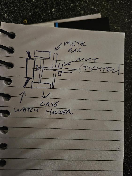

Just an idea.  For snap backs, adjust a case holder so the back is free but it holds the lugs.  Glue a nut to the back, drill a hole in a metal bar, just large than the  thread of the nut.  Put another nut a bolt , pass through metal bar and screw the bolt into the nut on the back of the watch.  Tighten the other nut, a bit like a pinion puller. I'll make a prototype and post a picture.
Here's my idea, the adjustment screw in the holder may get in the way, so could be substituted for a hole in a piece of wood. Can you tell I took art at school?  Hehe
Pulling a disk from the center tends to contract the perimeter, so although you could get a good mechanical advantage with such a setup, I think it might make the mating edges of the case and back bind that much tighter...
People have described pulling a crystal out from the center like this, in which case the shrinking of the perimeter would be helpful.

Almost like you need a push in the center and pull on the rim as you pull the entire thing:
Just wondering if there is some kind of cam or spring system that would automatically push on the center as you pull the entire thing a bit like a presto tool in reverse?

Pulling on the center of the caseback   will reduce its perimeter helping to release its tension. Same as pressing a snap back on has the opposite effect, one reason why some snap ons are tough to get back on by hand. Always push on around the edge, never the center. So in theory your idea should work, i think the problem is keeping the watch held in the case holder. I think it pull straight out, ideally the set up needs to pushing onto the watch case but then you have the risk of breaking something like the lugs.
Pulling on the center of the case back will cause it to dome outwards, reducing its diameter and causing it to grip the case even harder, as pointed out by @Geotex above.
🤔 i dont get that, i can see how pushing the center would splay the rim edge outwards.

Reducing the caseback diameter will grip the case harder ?

Haha yes i do get it 🤦‍♂️senior moment, too busy thinking about the missus fashion watch that i did 2 days ago, the retaining lip was on the caseback not the case. I'll go back to sleep now 😅

I chose to superglue a rather large bolt (rather than a nut) to the case back when I did this in order to get more surface area.  I also filed and polished the head of the bolt which originally had some raised lettering on the top.
With a large enough bolt you should limit the amount of caseback bending if you were to use this for pulling snap on backs
