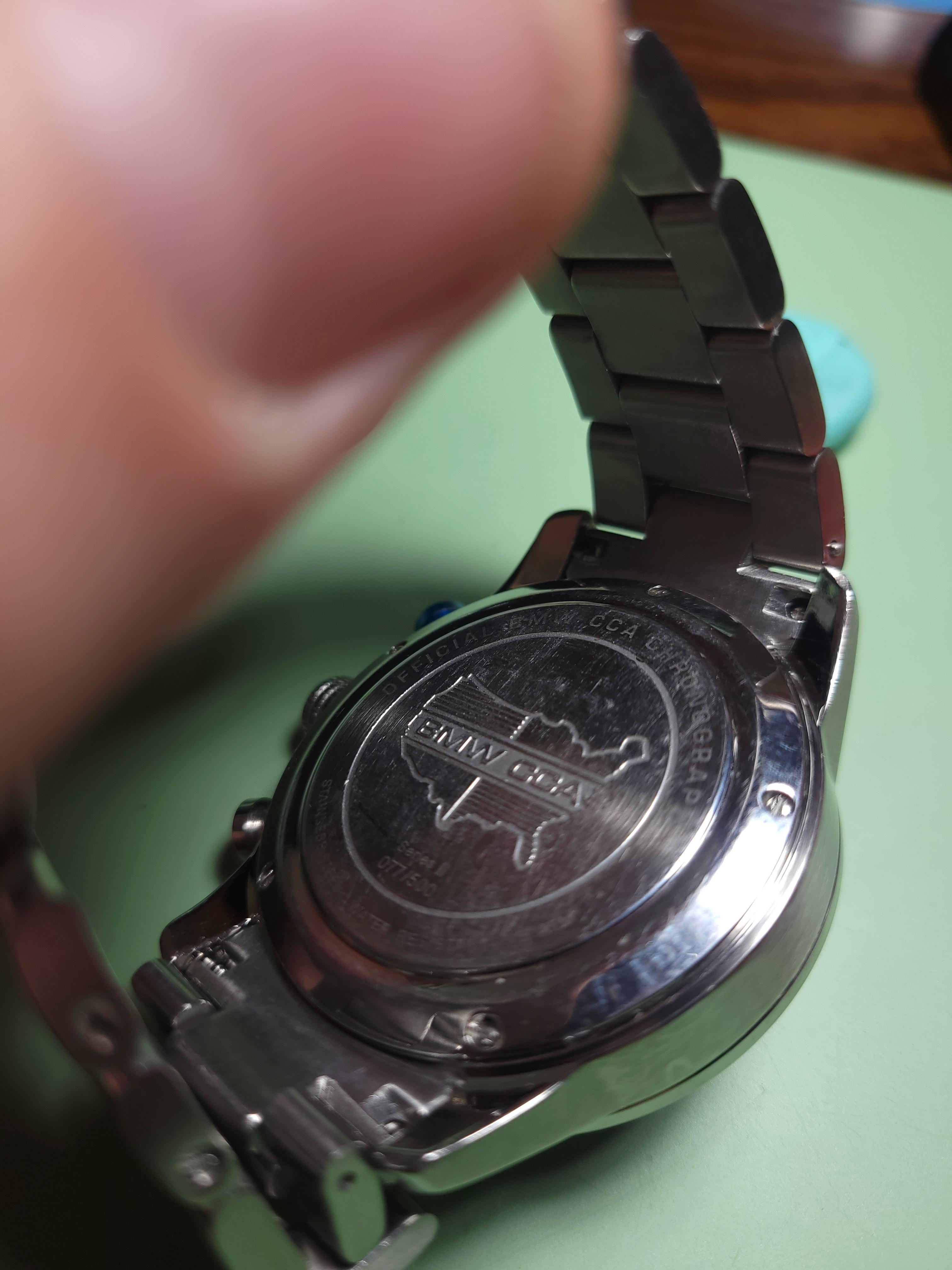

"Can you fix a watch with no hands?" BMW CCA quartz chronograph
