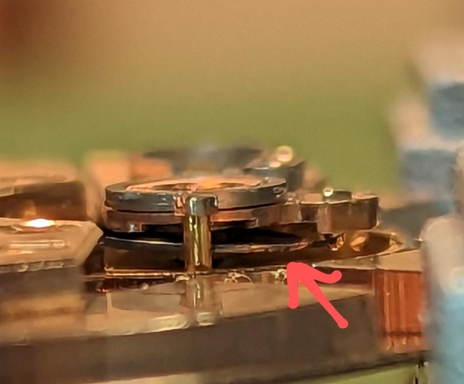

Working on an Omega 490 and when installing the balance wheel it wasn't moving freely.  When I checked the spring it was tilted at an angle.  This isn't normal, right?  Any ideas as to why?  The wheel itself appears to be level.  *After cleaning and cap jewel oiling I installed the balance wheel and tested it. Spun/oscillated freely.

Are you sure both pivots are present, to me the wheel also looks to be not level.  With both jewels removed can you see both pivots through the jewel hole ?
I would go with one of the pivots is missing

Usually a twist somewhere on the spring. If the spring look flat when unassembled then the likely cause is at one end of the spring . The spring is held fixed at two points the collet and the stud, so a twist at either end can make  the hairspring raise up like this. In my experience its almost always at the stud end unless someone has been faffying around with the collet. Mostly due to the balance assembly being removed a few times. The weight of the balance wheel tucking down where the hairspring is pinned at the stud. If handled roughly and stretched this is where the twist can happen.

As paul quite rightly says the problem looks more to do with the balance wheel not installed correctly or a broken pivot.
If you check the pivots, and they look fine, then during installation I would investigate whether the stud needs to be deeper into its hole in the carrier, or if the spring has been deformed.   I'm with Neverenoughwatches on that one.  I just got done working on an old Illinois 18s which, when I first opened it, looked like the stud projected rather far up and out of the balance cock.  More than most.  When I reassembled after cleaning, it would not run right until I had pressed the stud all the way in, right up to the base of the hairspring.  Once the stud was sticking up out of the top, she ran like a dream!  The hairspring was not twisted on this watch, but I think it may have been fitted with a stud which was meant for a thicker balance cock.  I see weird things on some of these antique watches.
You never can tell sometimes.  The watch wants what it wants.  On most, the stud needs to be level with the surface; on some the stud is so short that it comes up just below the surface; and on still a few others it is best if it sticks up like a stubby periscope.  If the pivots and balance and its jewels are all good, I'd look hard at how the stud is mounted, as well as the rest of the hairspring to see if it has been twisted.

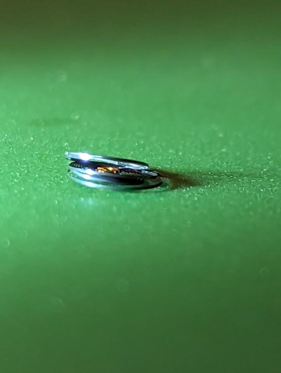

Hi all,
thank you so much for your input.  Removed the hairspring and it was twisted - too advanced for me to make any adjustments.  I'll try and source a balance complete or just the hairspring.

If you are sourcing a replacement part you have nothing to lose attempting a repair. If you consider this part having value then practice on something less so first.

When you say removed, did you remove it from the balance cock and then take it off the balance staff?
If you did that, could you post some photos?

Omega watches typically have a very soft hairsprings easy to twist if you don't have a lot of experience with working on watches. Omega watches also have the problem of being an Omega watch which means parts can be expensive. Then typically swapping hairsprings is not in your best interest. So basically you're looking at a balance complete.

I did remove from the balance cock and staff.  But before that I mistakenly tried to unscrew the regulator spring when my screwdriver slipped and destroyed the spring.

A new balance complete is the way to go.
In case the balance wheel got hit by the screwdriver, its out of poise now.
On this forum, you can learn rebuilding it to a balance complete.
