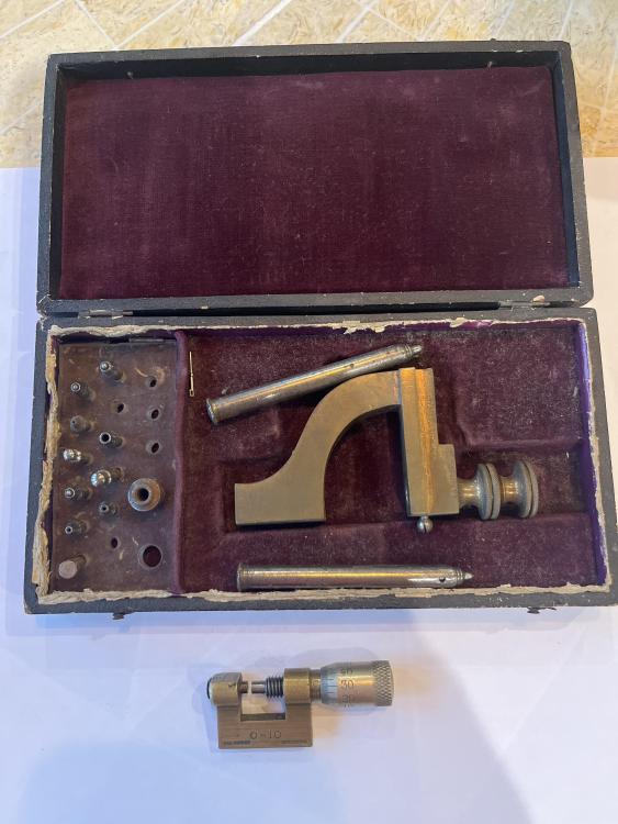

Hello, anyone know what these tools are please?
