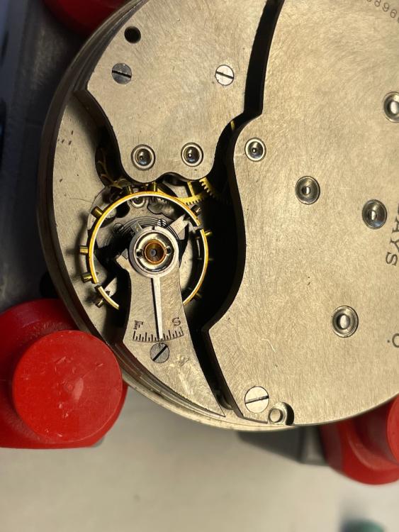

Yes. If that's not what you are experiencing...start looking for something rubbing. A 1st guess is that one of the hands is rubbing against the hole in the center of the dial. Especially if you now have lower amplitude in face up/ face down positions.
By OceanSprint · Posted
Once a movement has the dial and hands put back and it is recased, would you expect the assembled watch to have the same amplitude as when the movement is in a movement holder and is without hands and dial? Thanks -
C07641+ not sure what the "+" is for after the last digit.
