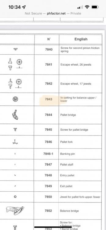

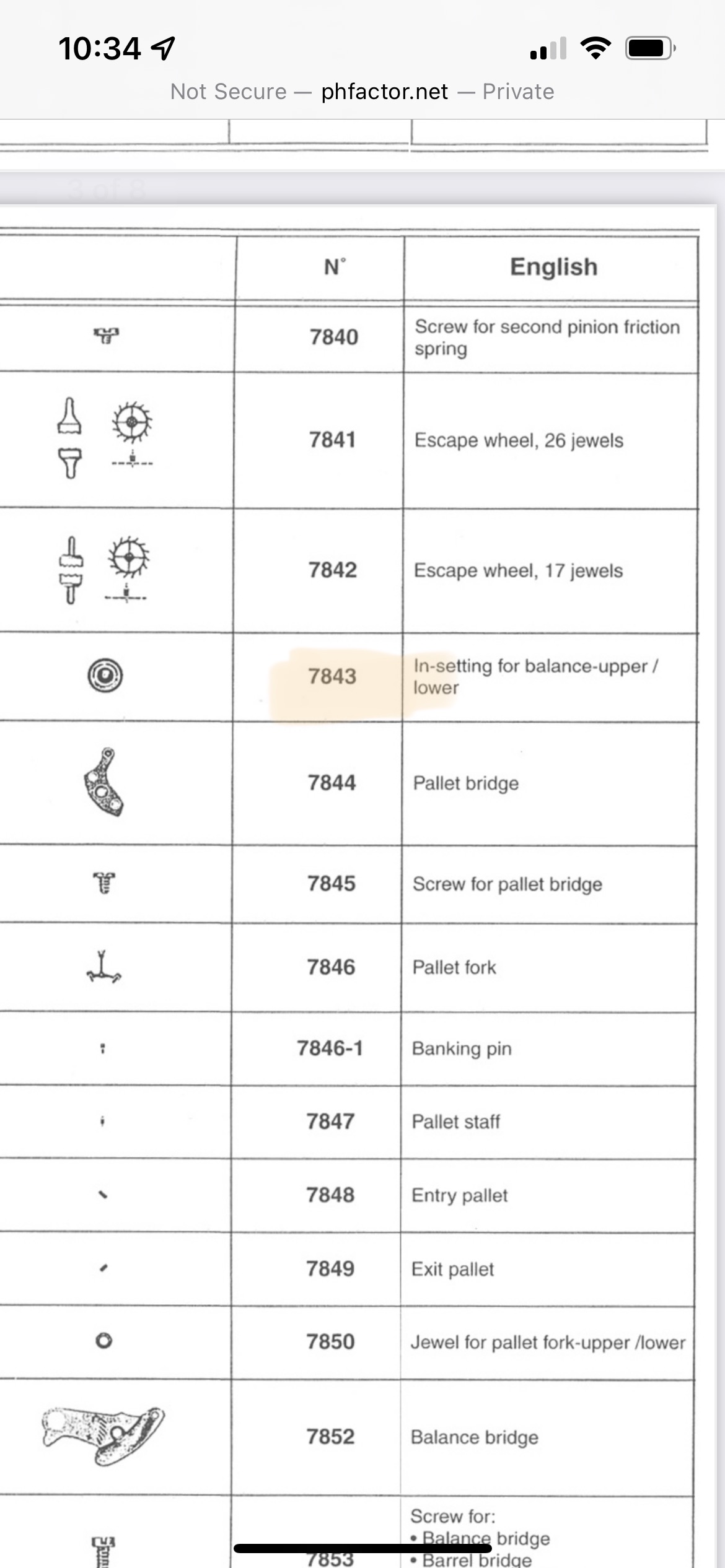

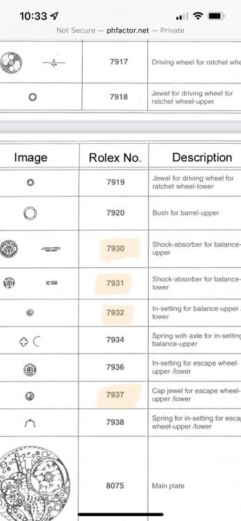

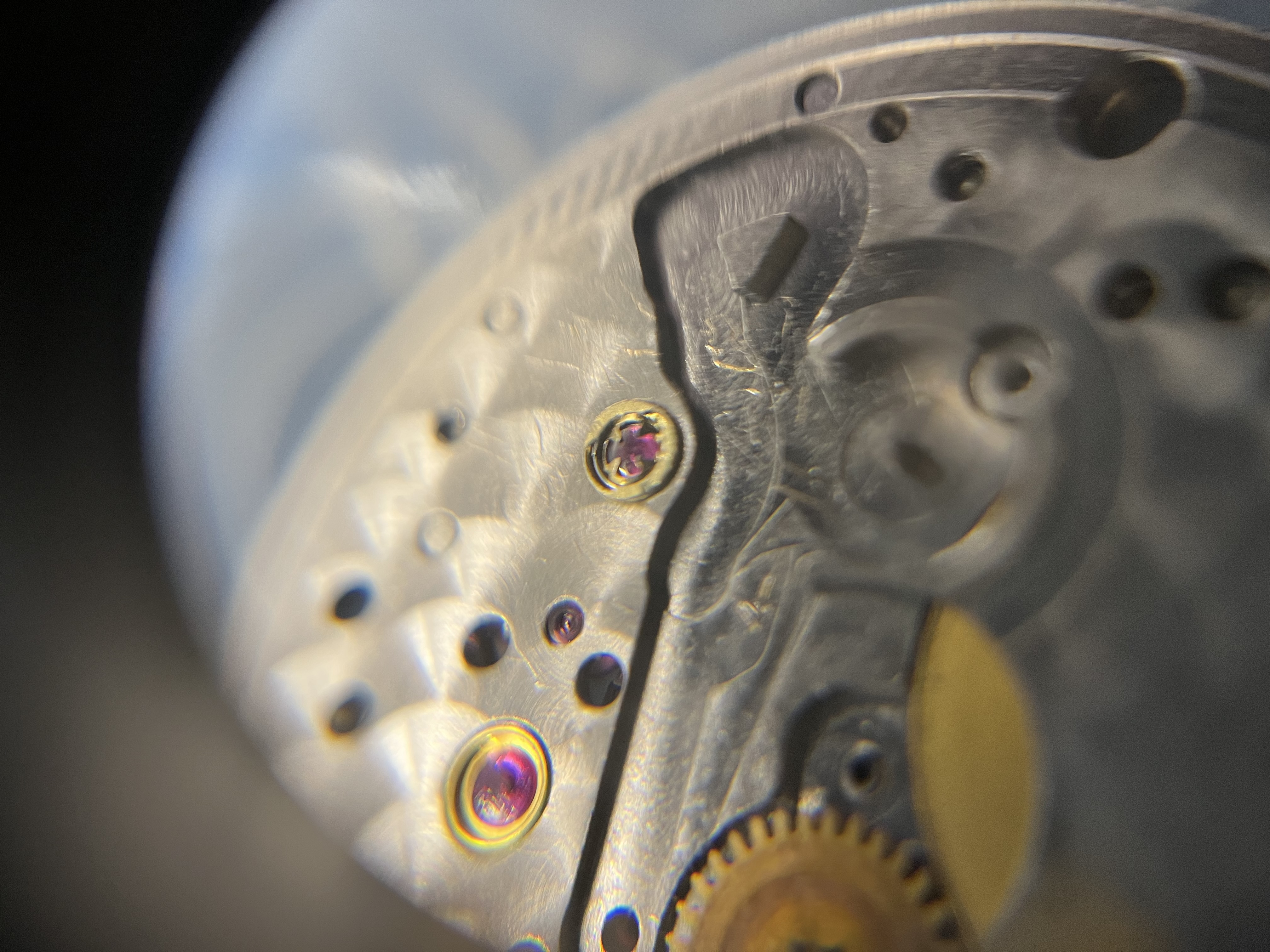

Hey playing around with a 1530 and the balance has too much shake. I noticed that the setting for the entire shock absorber jewel is not flush with the mainplate and looks like it’s been tapped on before. The jewel cap spring is also a little deformed but seems to function.  I was going to just replace the entire thing but I’m not sure if the exact part number
In looking at the parts lists, I’m not sure if I need the “shock absorber balance”
or the “in setting” of which there seems to be 3(?)
