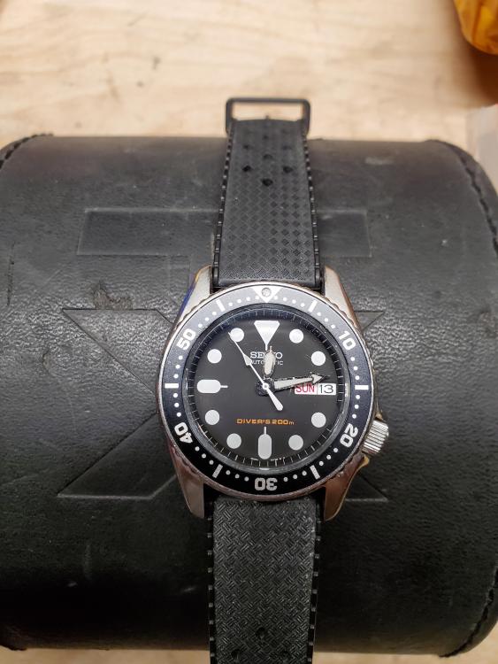

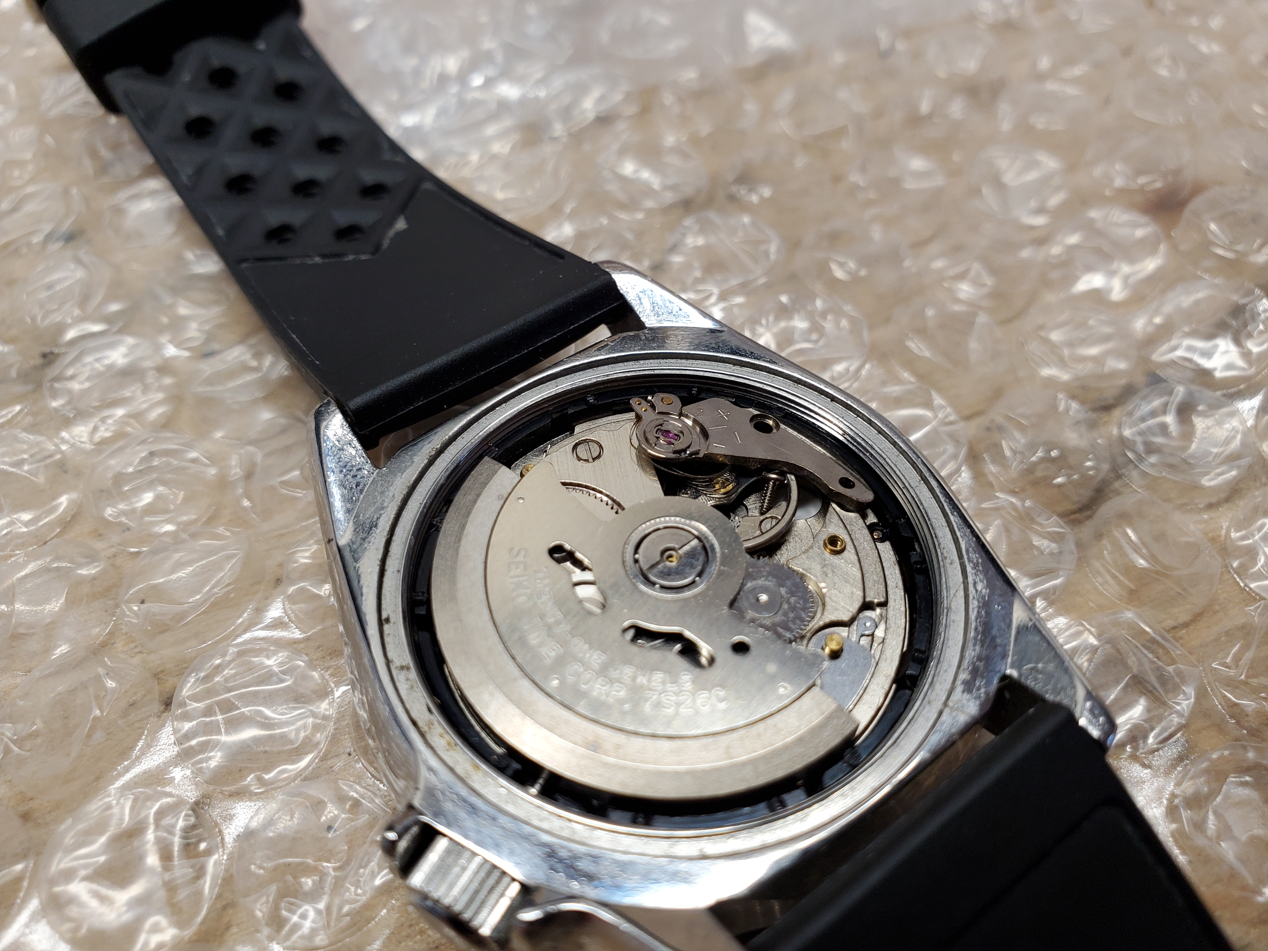

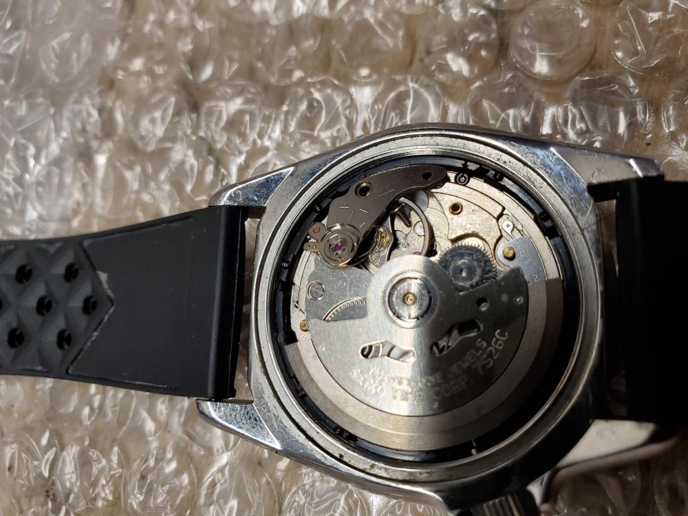

I bought a non-functional skx013 with the intent to repair (7s26c). If I have to I can replace the movement. Upon opening the case I found the balance wheel assembly bouncing around in there along with the screw. Of course attempting to reassemble was unsuccessful. The pallet fork seems to function properly without the balance wheel in place. When reassembled it seems to me the balance wheel is possibly sitting too deep and touching the main plate? Waiting on some properly sized screwdrivers before attempting further disassembly.
Ouch, with that balance loose like that a lot of ugly things probably happened to the pivot and hairspring. Based on the fact that the balance is so close to the mainplate I’d hazard a guess that the pivot has broken off. You can buy a new balance and fit yourself, but that’s not always a simple thing. Probably best to grab a donor 7S26C and use it’s balance complete.
I wish I had a balance wheel to compare it against. Would this happen if the jewel on the mainplate was missing? I think there is something else going on as the palet fork no longer appears to snap back and forth.
Can you get the balance assembly out cleanly, or is it trapped somehow? If you can, remove it and take some photos of the hairspring and pivots. Then remove the rotor. You will ideally need to take the movement out of the case and put it in a holder to reinstall the balance (this one or a replacement). Otherwise, the case will interfere with the balance and your lines of sight, and make the job 10x more difficult.

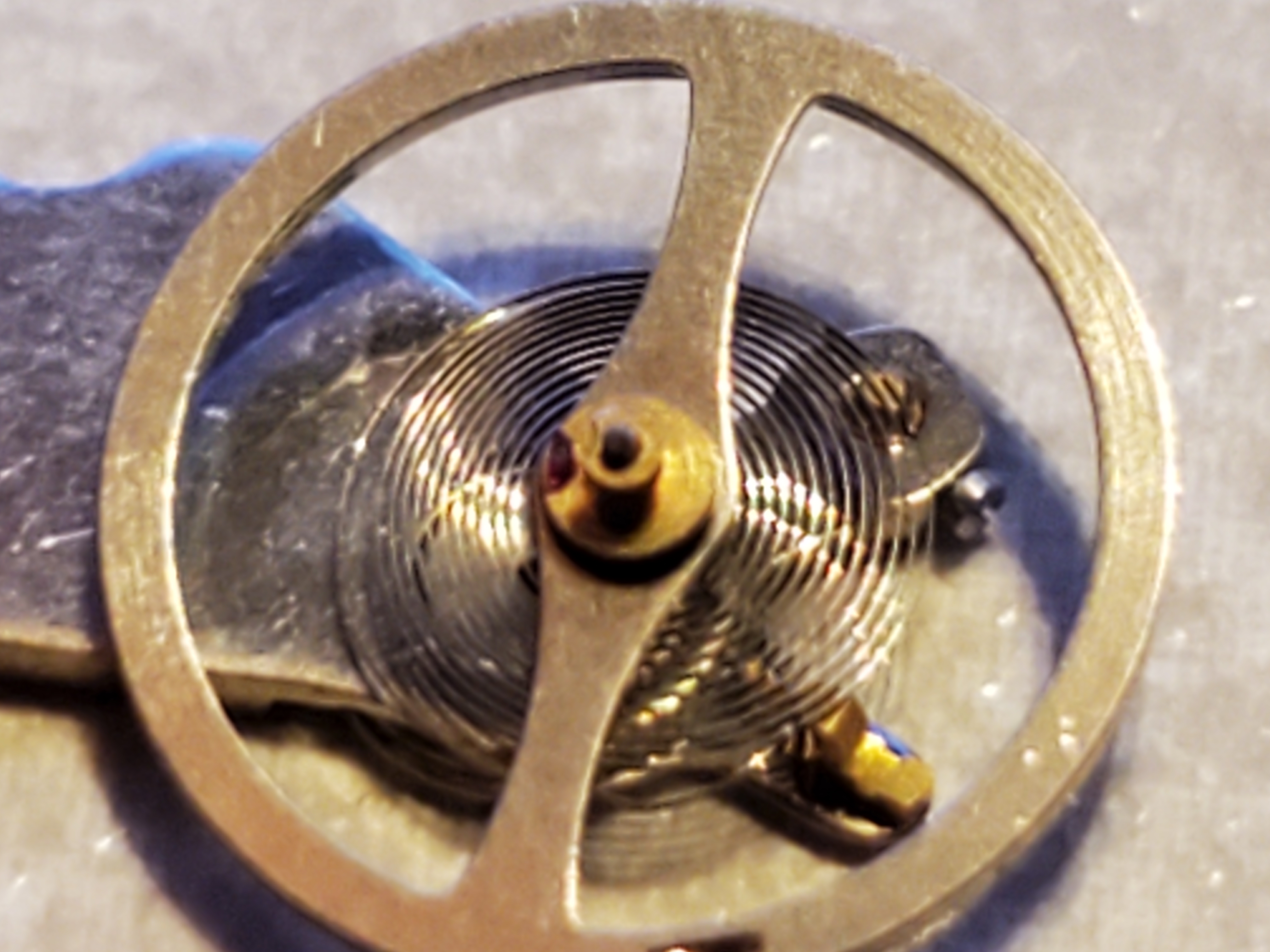

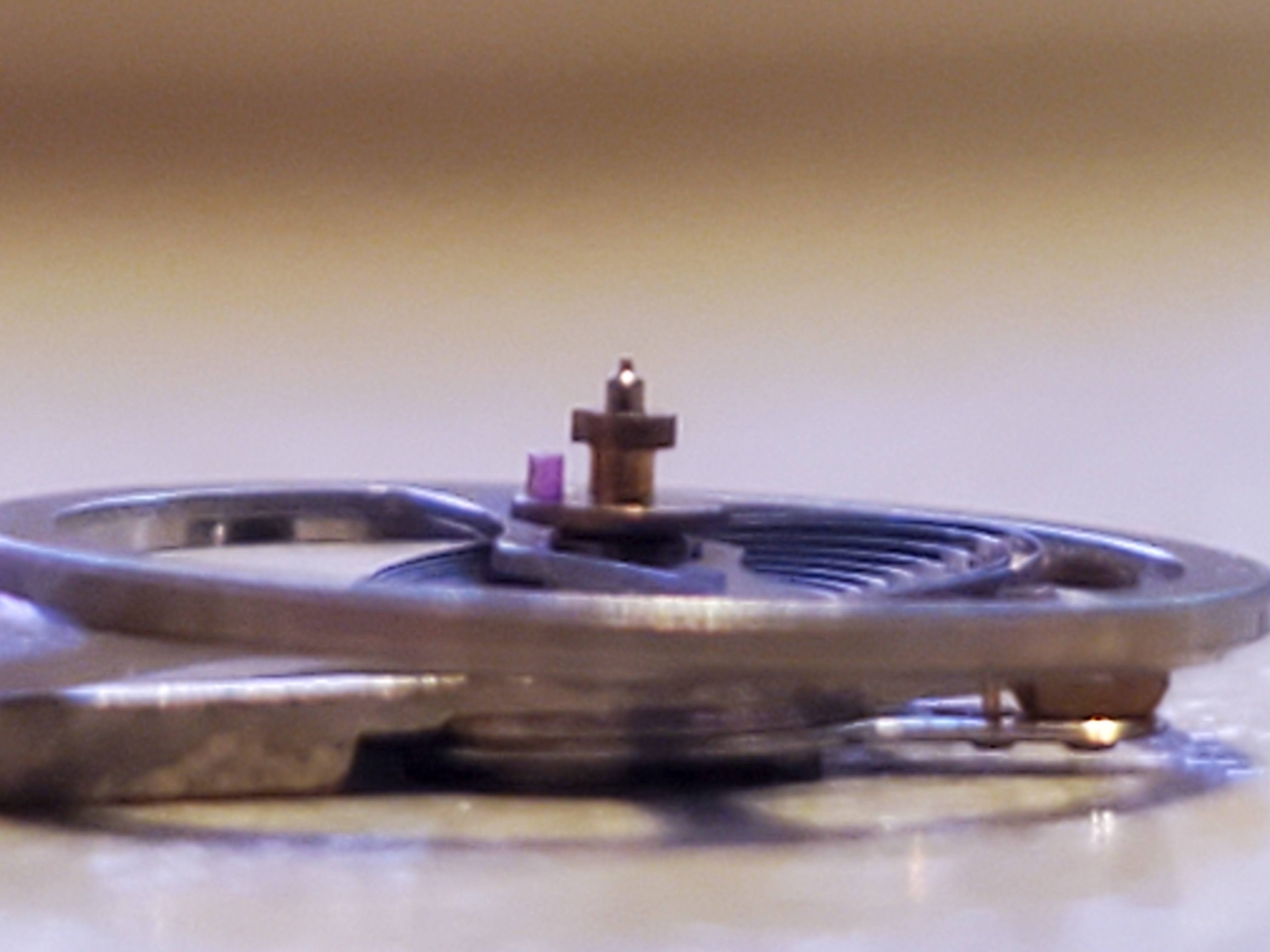

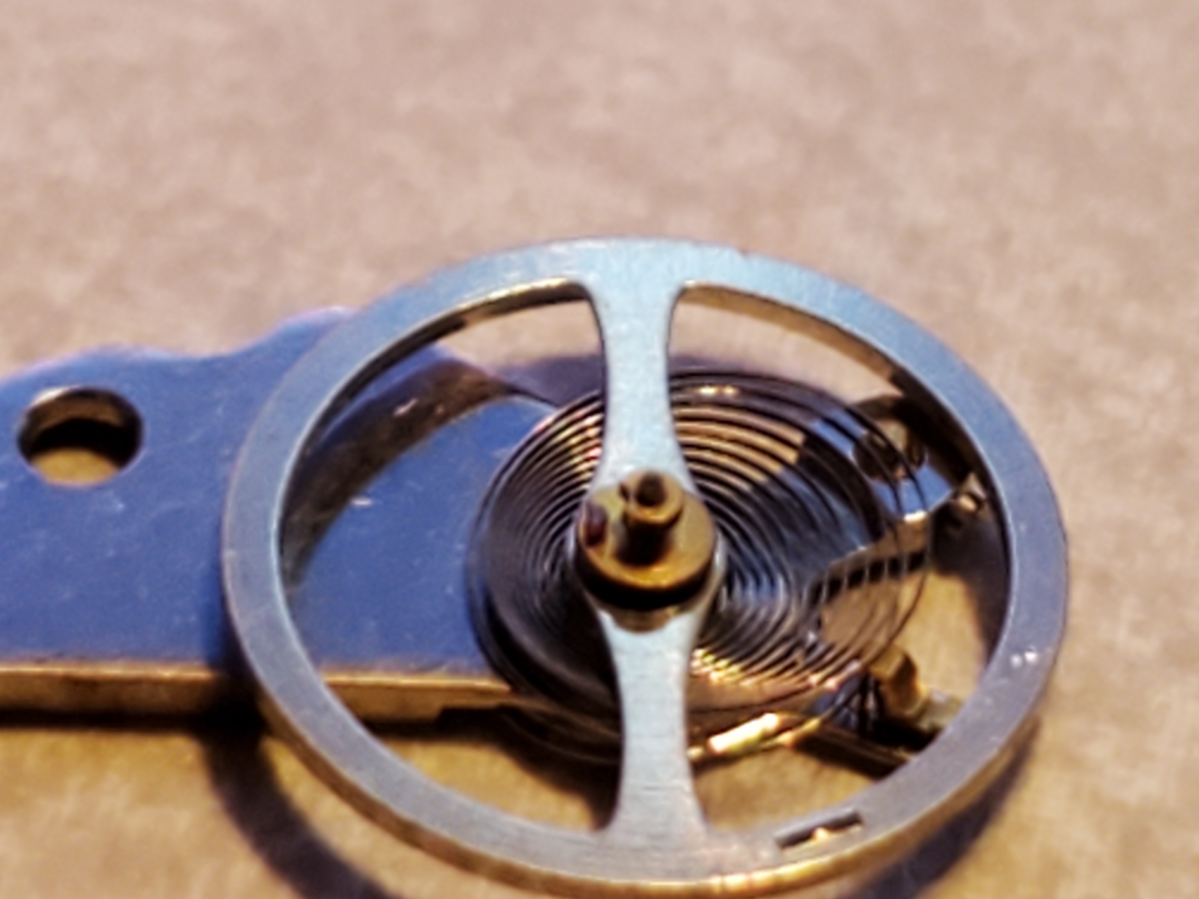

I tried to take some better pictures maybe someone here can tell me if that's broken off.
Expand
If you can get a clearer 1st picture. Try pulling back a bit with your camera and zooming in to help it get better focus. The pivot does lot short though so it is probably riding on the shoulder leaving the top pivot loose in the jewel hole. Good time to try a staking set if you have one.

Anyway, back on topic - I suspected the pivot was gone when I saw the first pics. Pretty much the only way the balance could be that close to the main plate. The later pics just confirmed it. I think I've seen enough 7S movements to last me a lifetime...
