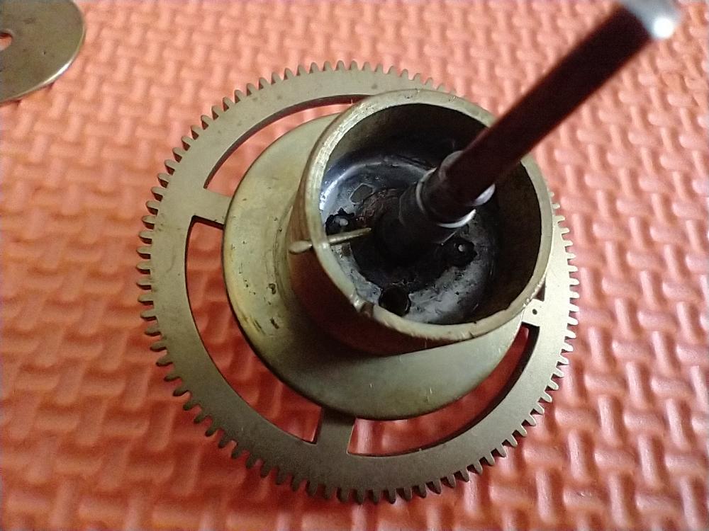

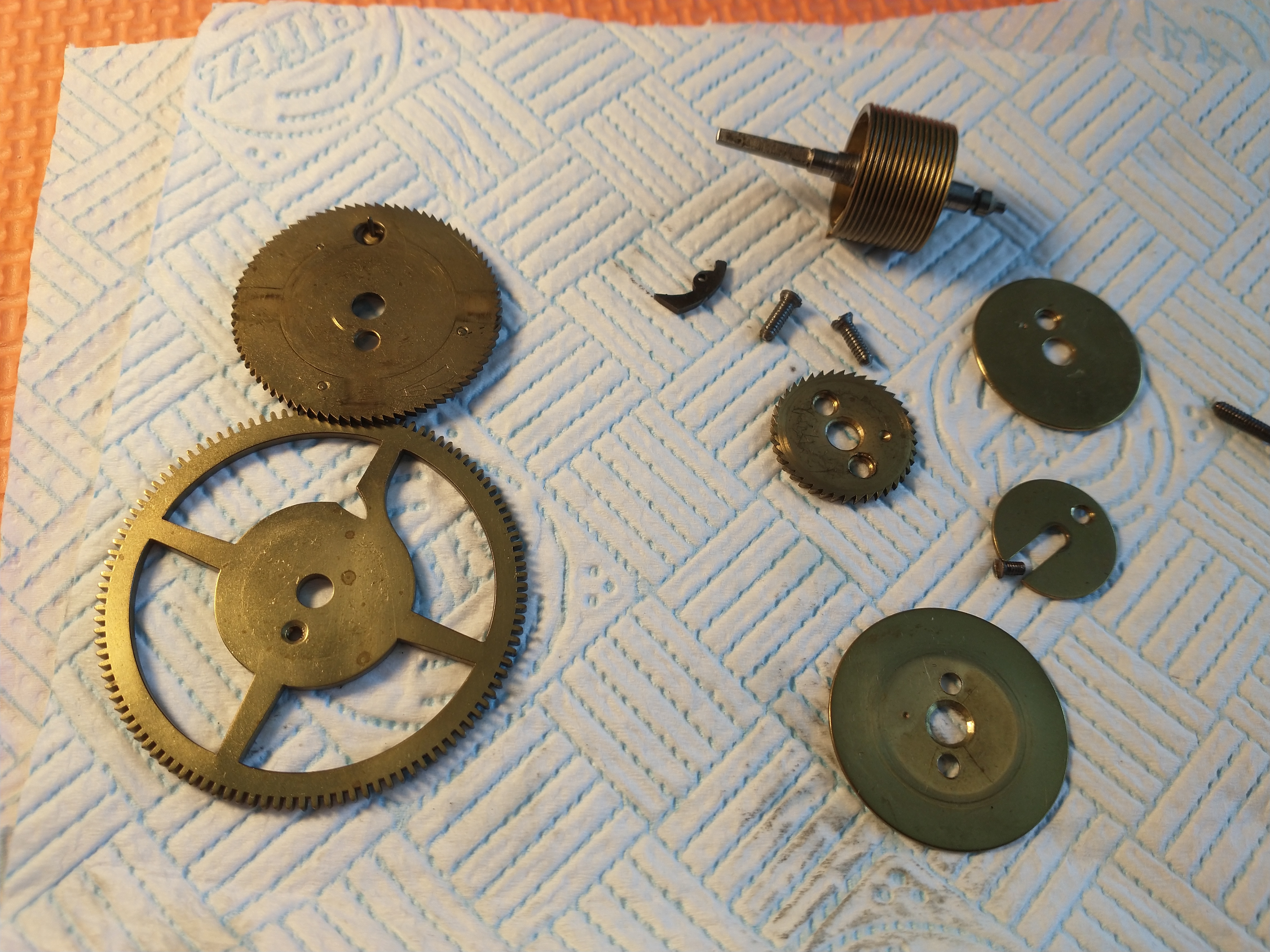

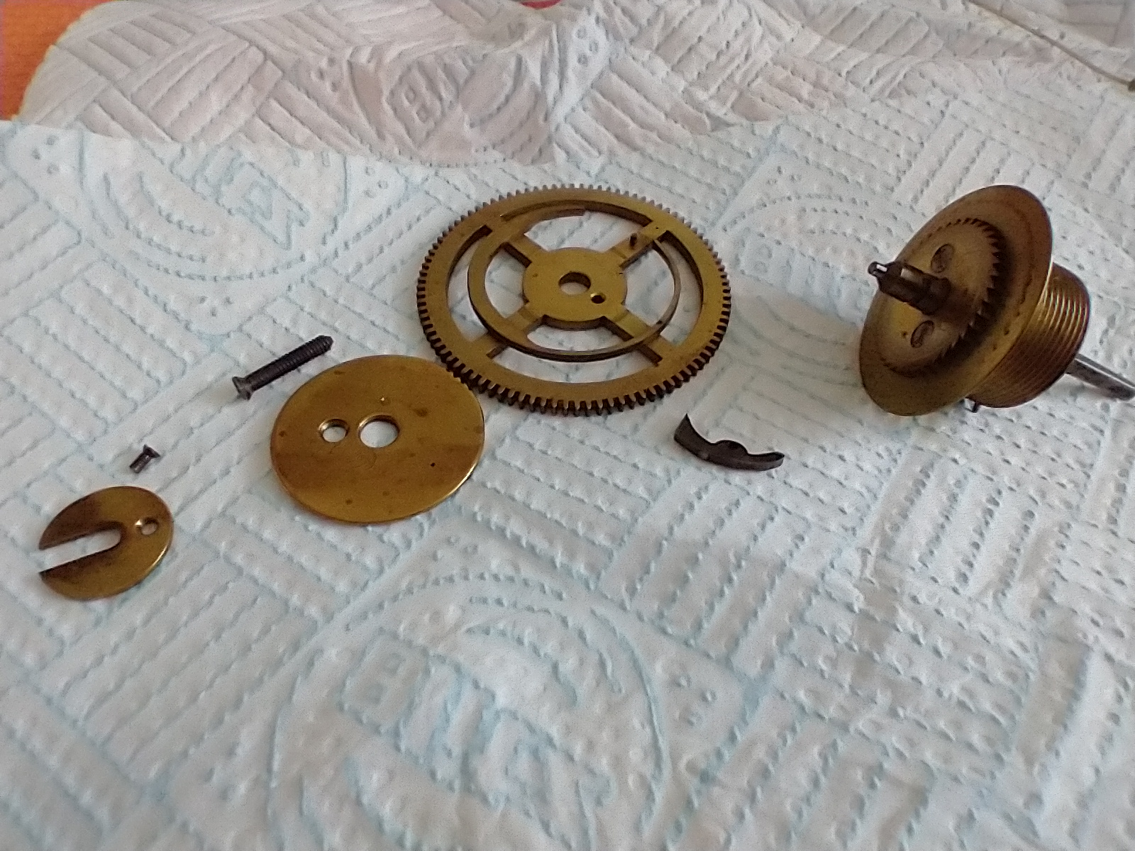

Hi everyone, is  there a technique in measuring the line, fixing it to the barrel then the weights without getting into a tangle with the line.
Also what is that pin for that goes through the barrel is it to tie off the line? (See last photo)
Oil or grease where two parts rub, I always used grease on the ratchet. You attach the line to the pin. Use  Synthetic gut that you can buy from any good clock suppliers. Yo must make sure you get the correct length right if not the clock will not work its full time which is 8 days, and the line most not wind over the groves on the barrel. Windles clock oil is the one I recommend.
