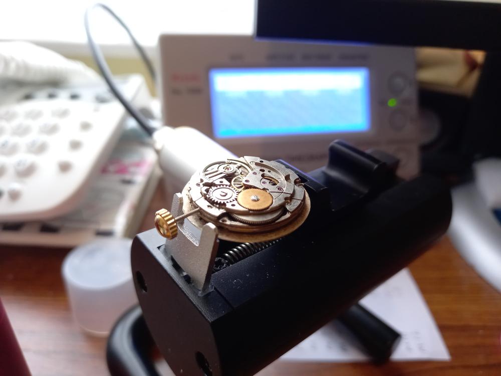

First off we need to understand what the timing machine is telling us. It's telling us that you have a problem with this watch. Usually I like to visually look at the balance wheel what is it doing does it look like it's amplitude sucks? Then unfortunately we don't have artificial intelligent timing machines yet and that's a problem. Because with artificial intelligence may be on the graphical display it would display numeric message and tell us exactly what's wrong with your watch but it doesn't it gives us confusions. If we look at your graphical display we don't quite have a snow globe affect which I believe is a quote from Neverenoughwatches. It's why always ask the see the display if you have a snow globe affect then the numbers are always 100% wrong.
Now the graphical display not a snow globe but not great and they look like they're angling downwards but the  numeric numbers say fast how can it angle down which would normally be slow and the numbers say fast that is a conflict.
By the way do you know how to visually check if the watches in beat without the timing machine?
maybe it's time to start at the beginning what was the condition of the watch like when you received it in the wire what did you perceive was a problem before you mean the watch? In addition to cleaning the watch was there anything else you did like? I see a change is the balance complete several times what did you perceive the problem was with the balance completes? It be nice to get a picture of the balances that you replaced and we need better pictures of the balance currently in the watch.
Then were ending up going into many directions obviously re-cleaning it again isn't going to help and changing the balance complete again is it going to help. Then watch repairs all about a infinite number of directions and choices to go in. Yes I thought I just randomly toss that out while I'm trying to figure out how to solve the problem.
too many directions to go M. I think I did make some suggestions one way up above now I can make some more suggestions. If you remove the balance wheel and the pallet fork preferably without  power in the watch and then you gently start to turn the crown what does the gear train do? Does it start up instantly does it take a little bit of time when it spins doesn't look like it's spinning with hesitation when it comes to a stop does it come to a sudden stop original gradually slow down. It be nice of you figure out with you actually have a power problem or you problem associated with the balance wheel. Or with stuff associated with the balance wheel. This is where the timing machine isn't necessarily helpful on where the problem is.
I've removed the balance and pallet fork. Wheels spin with the merest of touch.  Hold click back. Move spring barrel back and forth. Escape wheel spins both ways immediately without delay. Place pallet fork and secure. Pressure on the fork and it moves from side to side with a spring. All appears ok.
I'm sure it's the balances. Must be the way I hold my mouth. It will have to wait now until I get another balance complete.

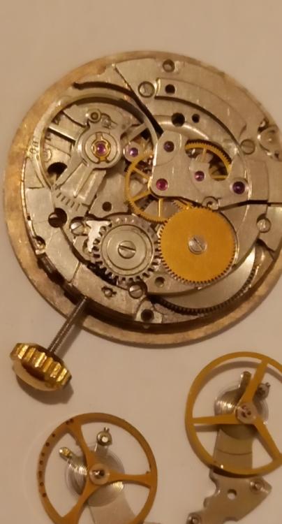

As requested. Photographs of the balances
Balance in the movement. The spring was bend over the stud. Lifted over the stud and the kink Smoothed out.
Full, not damaged cock, balance is the original. I damaged it by pulling hard, as a newby does.
Balance from donor that had screw seized. Drilled out and cock released. Balance itself seems ok, but I do not have enough skill to remove and place on the other cock.
one of the problems with taking pictures of balance wheels out of the watch is out of the watch that's not where you having the problem. In other words if the hairspring is touching the balance arms seldom will we see it out of the watch. but typically about the only thing working again from balance wheels out of the watch is if they're grossly bad out of center or there's some weird bend somewhere but we really need to see the balance wheel in the watch looking down looking sideways looking at angles that are really hard to get pictures of.
then how about we put the watch in beat or he try to. So balance wheel out of the watch does give us a clue about something notice where your roller jewel is a notice on the opposite side of the balance wheel where the arm is? We can use that the site and get the roller jewel much closer to being in beat than it is now. So what the power off the watch like you have it in the picture pill notice from the other image your arm is off quite a bit from where it should be. You look at the long line I drew that should correspond the alignment with the roller jewel which we can't see but we can see the arm on the other side. So you can move the stud yes that's a movable stud you can move it counterclockwise and see if you bring the arm closer to an alignment and then wind the watch up and see if the beat looks at a better. but you may not see any improvement at all because your display for the graphics is not look good but the watch would run better for is closer to being in beat.
So potentially you have 2 good balance cocks and 2-3 repairable balances. Hopefully you have enough here to make up a good balance that you can use. Even if they are all broken in some way you have nothing to lose and something to gain by changing some of the components. If the outcome isn't successful you have still gained knowledge and experience. I would start by rescuing the balance from the victim of the driller killer first. You also have balance jewels and shocksprings to bag up and label for spares or just stow away the deceased cock and mainplate as is. Then start looking at the original balance , how was this damaged by pulling ?
