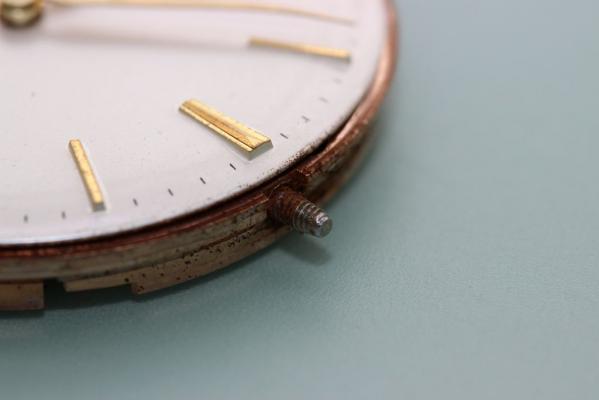

This nice Omega came in with a seized up keyless work. The crown could not be pulled out to hand set position and the watch could not be wound. I immediately suspected rust.
Getting the movement out of the case was a challenge because the crown could not be pulled out. But luckily I could unscrew the crown from the stem as the stem was seized.
With the movement out of the case, I can see evidence of rust. Time to get stripping (the watch).
First challenge was unscrewing this dial screw which was rusted in place. A bit of oil and some gentle persuasion and it unscrewed.
With the dial off I can see the extent of the damage which is quite bad - but not the worst I have seen.

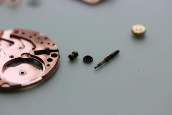

Off with the hour wheel:
And the setting lever spring:

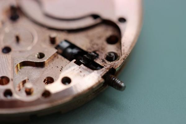

And this is as far as I could get. That stem was not coming out, but I have an idea! ...

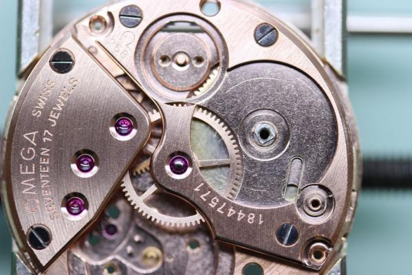

Then off with the ratchet wheel - does not seem to be any power there but I can't risk it so it's a good idea to remove the ratchet wheel and click work altogether. I don't like the ring of rust around the barrel arbor bearing...
And the crown wheel...
Now I am sure there is no power on the mainspring (but I was wrong) so I can remove the pallets...

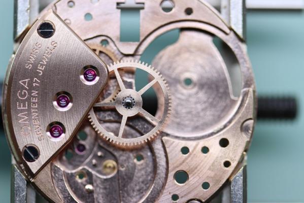

Off with the barrel bridge and surprise surprise... more rust :(
Not looking good - but it seems to be surface rust so it should come off easy. Now to open the mainspring barrel. Remember I told you I was confident all the power was released? I was wrong:

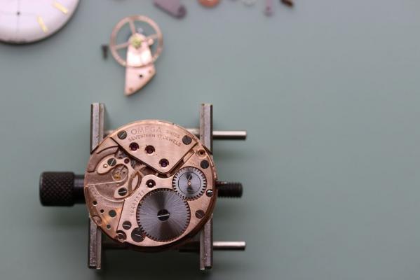

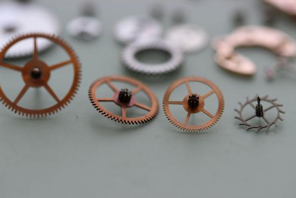

So next off is the main plate exposing the wheels. I was half expecting to find rust in the pinion leaves or pivots but all seems fine.
Off with the wheels...
A teeny bit of rust on the escape wheel pivot but luckily not attached - brushed off and left no stain.

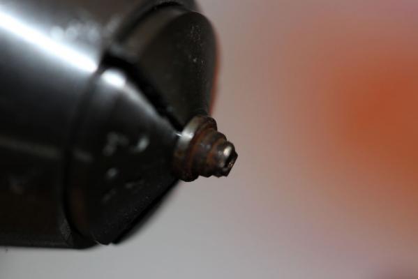

Now back to this bugger of a stem. The oil did not seem to help...
But after heating it up with my spirit lamp, I grabbed it with my pliers and gave it a sharp pull. It came away just fine.
