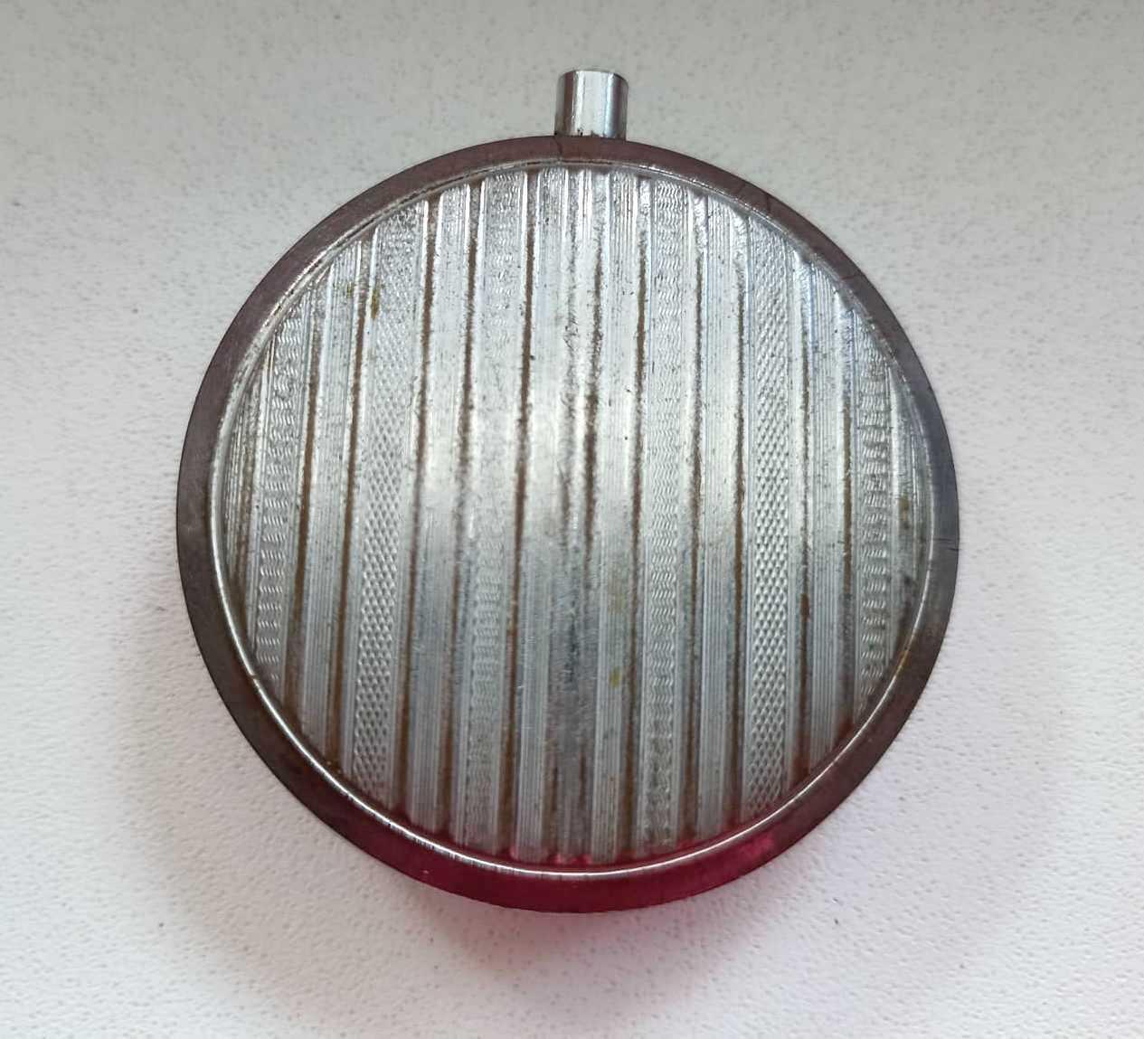

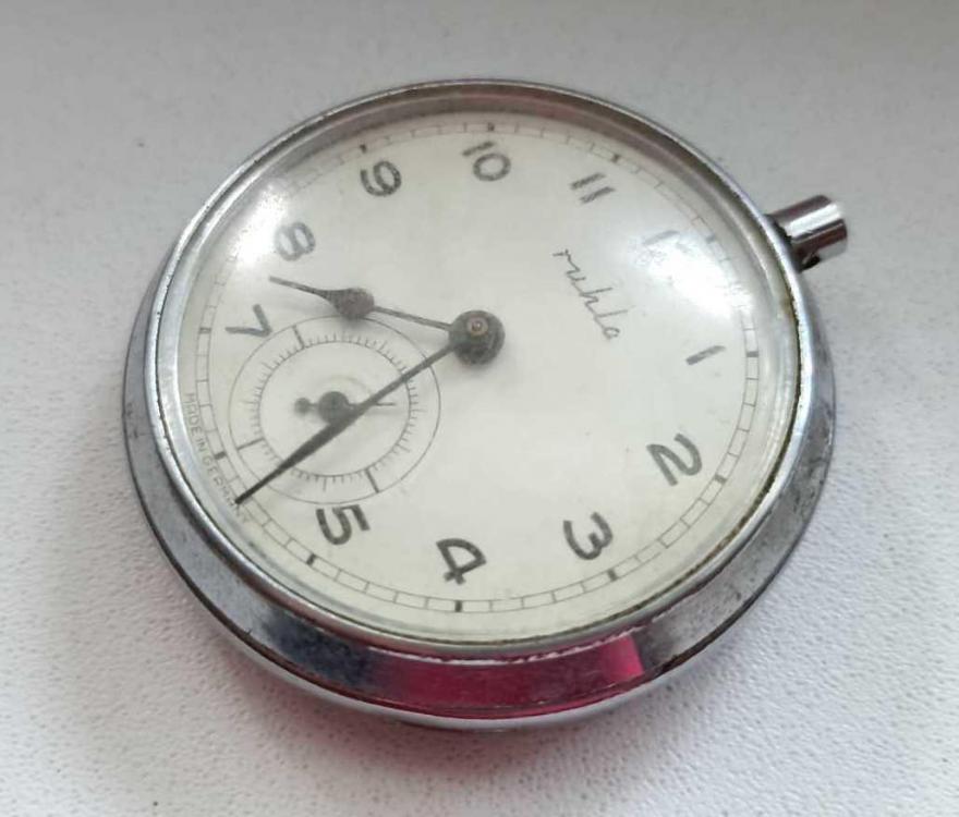

Not an achievement yet, but I purchased this pocket watch off Ebay in the hopes to get it shiny and running again.
I have no tools apart from some precision screwdrivers so will probably need to purchase some before I tackle this thing.
I do believe when it is cleaned up it will be gorgious and hopefully I can get it running.
Will keep you all posted here.

I‘m not so sure if this is a good start for a beginner expecting a „gorgious“ result. The hairspring looks bent and the pivot holes badly worn. You should take it as an object for practicing assembly work and be happy to see it just running.

At first glance it looks like you'll need a stem and crown. The easiest way to get those parts may be to try to find another abandoned watch of the same make/model and vintage however as I've learned: swapping parts on a 100 tear-old pocket watch doesn't always go as smoothly as one would like.

A bit of googling will give you some interesting company history loei. Some information on watchuseek and a youtube video about the ruhla brand and its derivatives will get a  manufacturing date within a few years. Just a little advice if i also may matey, one of my golden rules of watch buying especially from epay. Is to never buy one that has no stem unless I'm sure i already have one or can get one. I have other rules but this is among the most important. As this often leads to having to buy another of the same, which in itself is not a bad idea. As long as you bere in mind that at least 2 non working watches can be needed to make 1 working watch. In the case of a missing stem you know for sure that that issue exists. Where as particular movement issues such as in the balance  assembly, these are much harder to spot and are easily overlooked or not apparent at all.

I have had a search for that particular stem  as a nos ( New old stock ). Ranfft are listing two. A w290 and a w302. It seems the umf 1 from before 1968 was renamed the umf83, then in 1972 bacame nickle plated. So yours is in that 4 year period. A stem database check may be needed to find out which stem you need out of the two. So also bere that in mind if aquiring a donor that you need the brass coloured movement mainplate plate.
