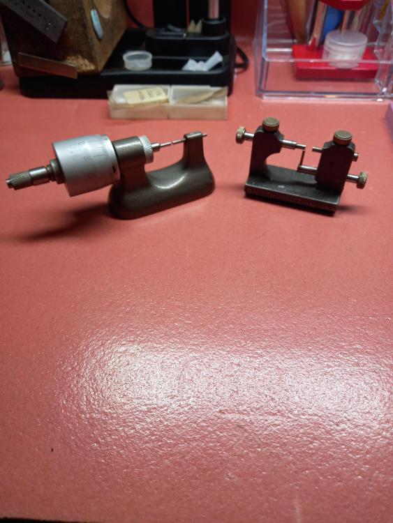

I can see my request for photographs went unanswered fortunately I remembered when I was at work. Then as I suspected the notch that's broken is the one that I commonly need to use for 18 size American pocket watches but I was still able to get the roller off. So we have a really nice roller remover tool.
then subject hijacking? Okay I guess the subject was mystery tools and we need more photographs of one of them
the tool on the left-hand side is some form of bench micrometer. As a really nice big spindle slot should be capable of a very high precision. Definitely a much better tool for measuring some things in the near calipers like the thickness of a mainspring much better.
The tool on the right we really need better photos? But in the absence of anyone else guessing it's probably for truing balance wheels possibly may be perhaps. You should build a look at the ends of the tool in the middle and it should be able hold a pivot probably have the arm like thing is perhaps used to tell if your balance wheel is straight or not. At least that's my best guess.
