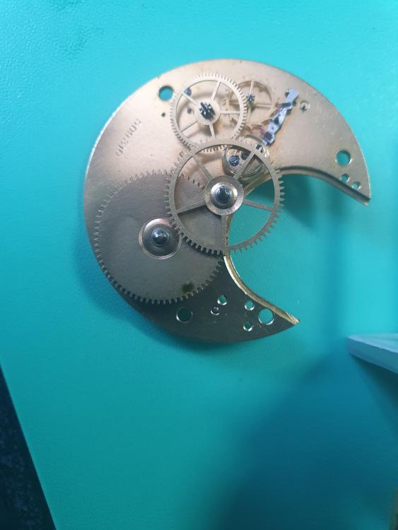

Working on this. Wasn't running, serviced, full of grime, now running but really low amplitude.  Also stop/start.  I think it needs a new main spring but balance issues too? 20220514_180535.thumb.jpg.09427790b4ab088fcd1c7571288d3b64.jpg20220514_180535.thumb.jpg.09427790b4ab088fcd1c7571288d3b64.jpg20220514_180535.thumb.jpg.09427790b4ab088fcd1c7571288d3b64.jpg20220514_180535.thumb.jpg.09427790b4ab088fcd1c7571288d3b64.jpg

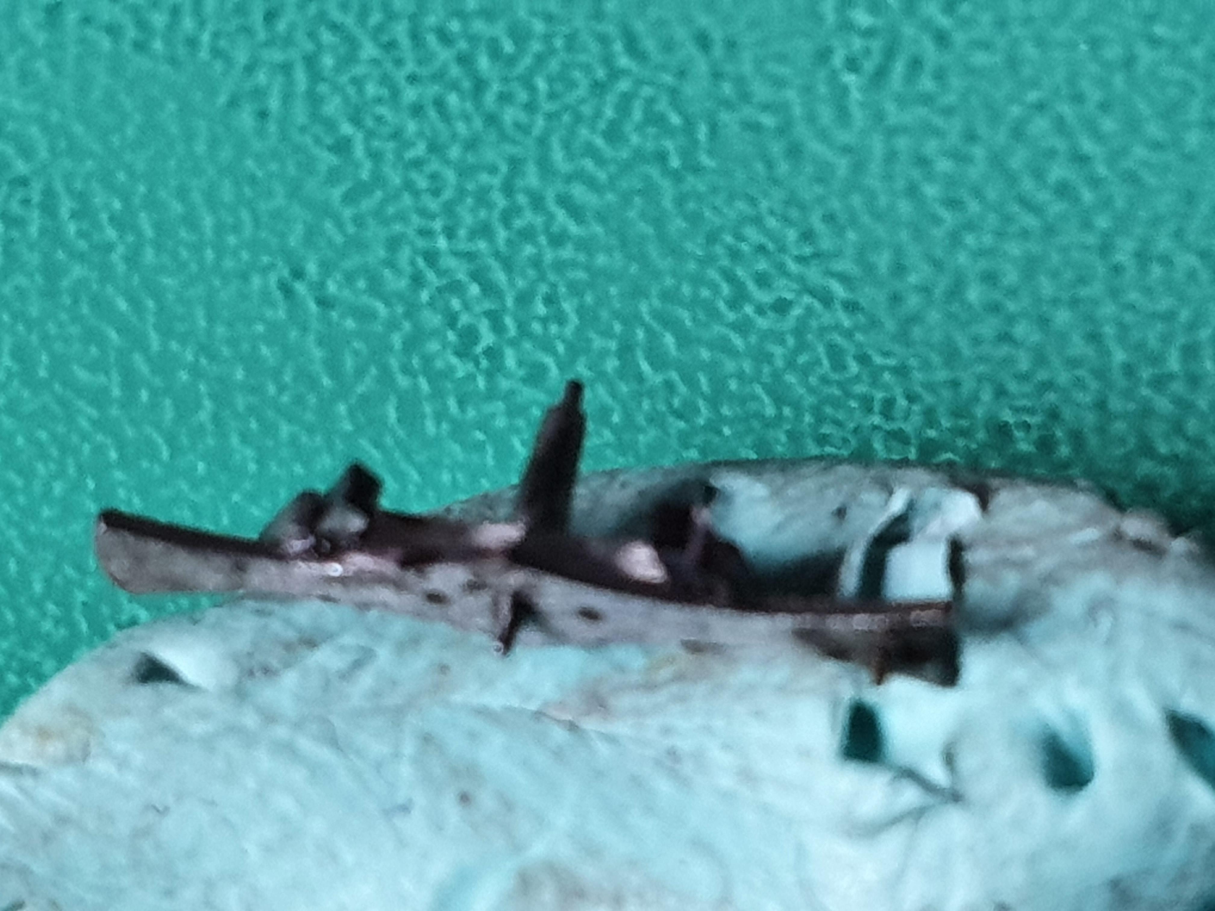

Rich Have you taken some positional readings ? This will give you an approx idea as to issue. Did all the pivots look ok ?

Do you have a pic of the spring out of the barrel ?
1 hour ago, mikepilk said:
Not necessarily, springs can last a surprising time. It depends on how it looks, and if it has lost it's elasticity.
Agree here. A look at the spring in its relaxed state will give a good idea of how fatigued it is. A strong health spring will want to stretch out and release its energy. A bit like how we  wake  up in the morning ready for action. Strange analogy but sort simplifys the explanation.

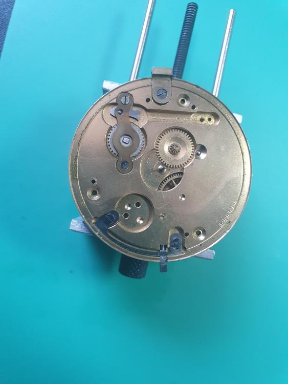

In your last picture it looks like the spring that is supposed to hold the click against the ratchet wheel is missing.  I assume you added that back?  Otherwise it would be hard to get any power at all.
The photo was taken as I was dismantling.  The spring is back in place now.

I'll take photos when I get chance, probably tomorrow evening . The pallet was difficult to put back, it goes into a little cylindrical recess. The pallet moves freely without the pallet in place but doesn't snap back and forth.
This photo didn't upload before.  The various components  were stuck to the top plate.

The photo was from when I disassembled it.  All virtually glued to the top plate.
