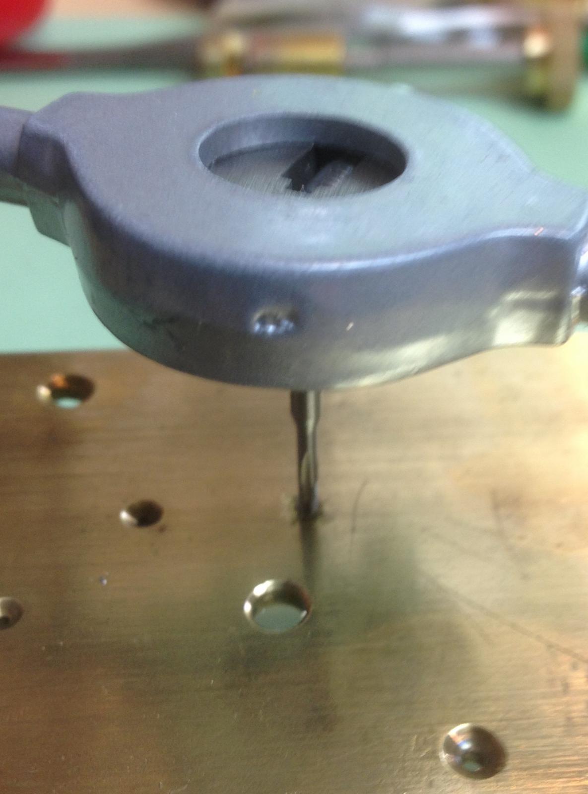

The minute wheel is attached to most carriage  clocks with a screw/post. When I opened the case the wheel was at an acute angle. It was fitted with this. The shaft that supports the wheel was very loose the screw/post was bent at the tip the head was also bent & whoever made this one had calculated the length incorrectly so made it fit with a brass bushing.Also the thread had been stripped on the screw & also on the case plate.
So I had to make another. I also had to re-tap the plate. Sorry guys but did not take pics while making the part also some of the pics are out of focus but here are a few after making the screw/post. I tapped the case with a 1.4mm thread which was worry because I only had a cheap die so very very gently when cutting the thread.
Drilling
